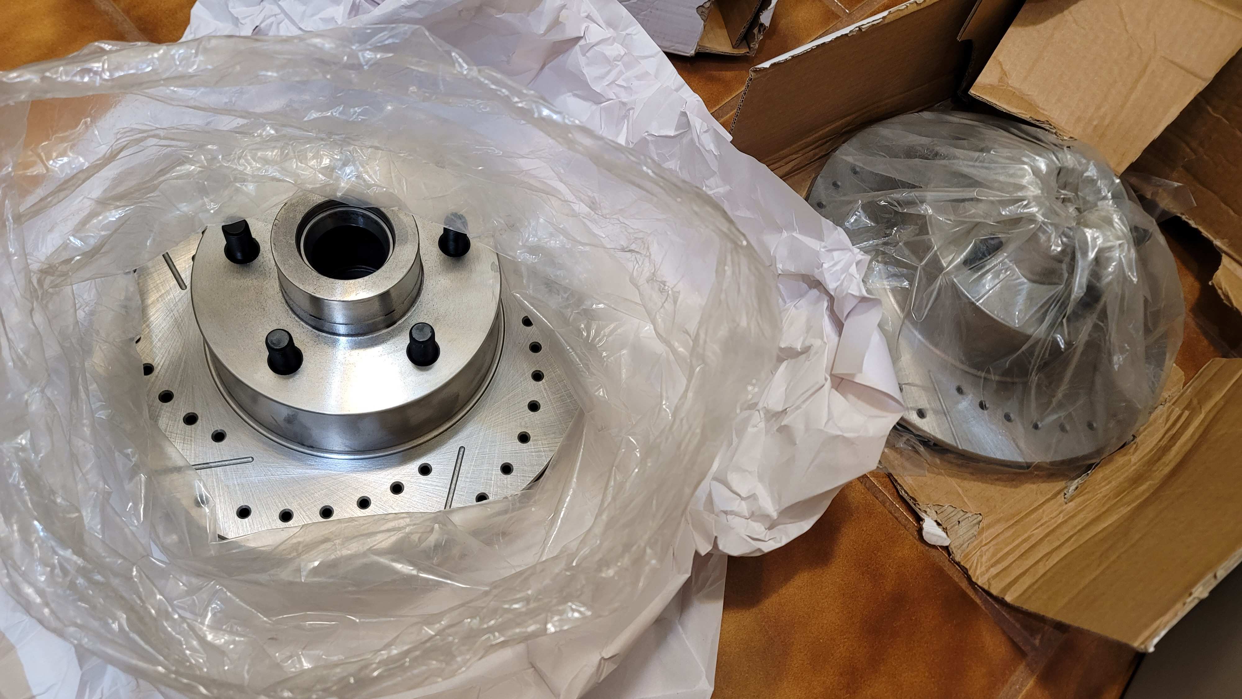

I bought new slotted, drilled 11" rotors from by OER from Classic Industries, part number MB5314L and R. I couldn't find the Hawk brand pads. Everyone that carried them, were out of stock. The only ceramic pads I could find were made by EBC, part number: EBC-DP31176C. Unfortunately, they are painted red and cost close to $200. I settled for some AC Delco semi- metallic pads.
