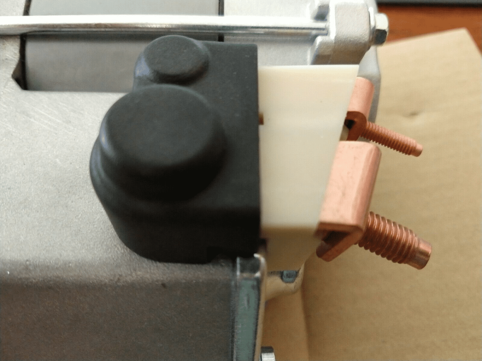

wedge_426, a member of this forum, sells this terminal kit that has proved to be very helpful on clearance issues. I have included a link to his eBay page. I hope this will be helpful to you. :
Mopar Mini Starter Terminal Conversion/Relocation Kit *THE BEST, PLEASE READ!!* | eBay

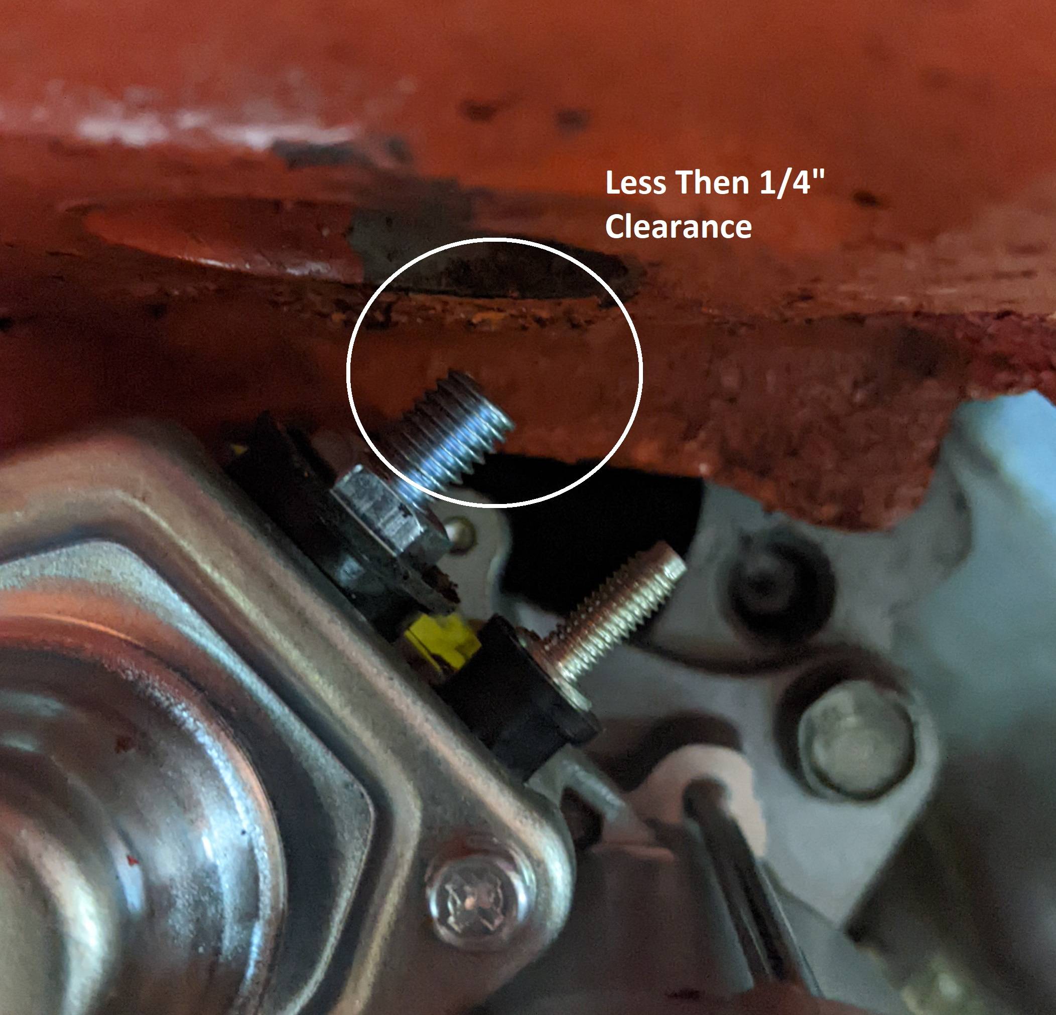

I decided (with the help of this chain) that I didn't need a hi-torque starter and went with a regular mini (
Powermaster PowerMax Plus PWM-9300). It turns over my 440 magnum with ease but the clearance for the connection wires and the block is startlingly close (like 1/4") and incredibly difficult to tighten the connections with the starter in place. I should have removed the starter and attached the wires first (but I was stubborn). I noted this issue with Summit and their answer was clearance for headers. However I think the connections could be put on the underside and the power wire to the starter motor on the top. Whatever, it's done now.

Note the relocation kit that Rons340 listed above. That may remedy the difficulty you are having for the install and may stop future arcing.
Be sure and use a sleeve on the top bolt. The hole in the starter flange is larger than the hole on the bell housing allowing it to shift over enough to contact the block. I had this happen with Rons relocating kit. It had a hole in the plastic cap on top after 3 or 4 crankings. The sleeve is what fixed it on mine. Good luck. If the battery dies it is mostly likely this starter. It was on my car.
