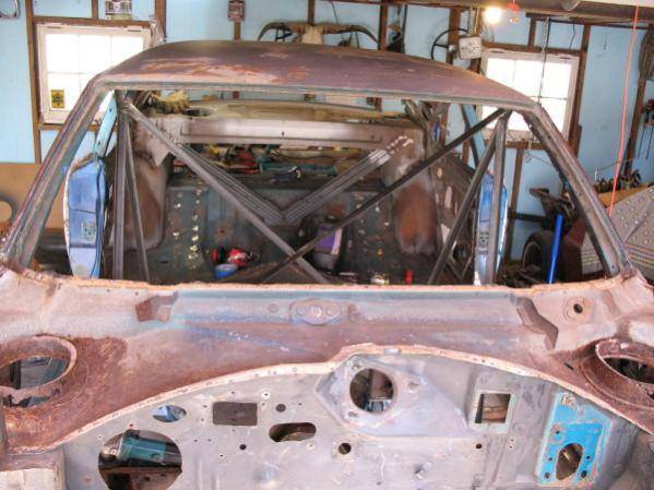

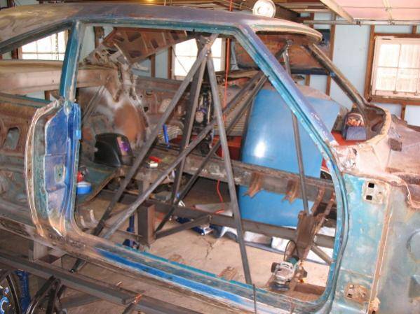

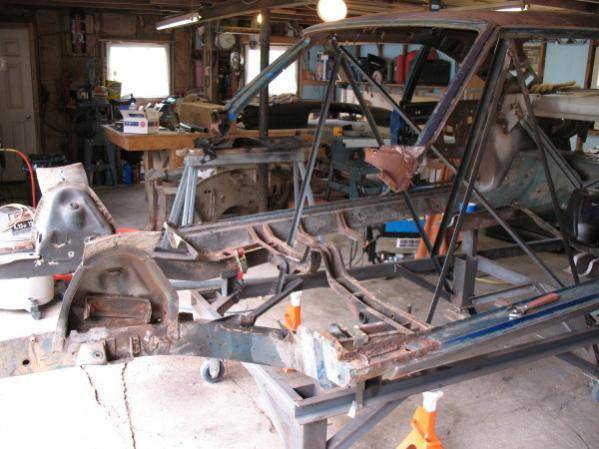

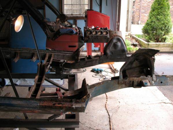

I replaced the entire cowl section on my `68 Road Runner including the A-pillars fom the tops of the rockers to the base of the windshield pillars. Here are a couple of pics of the bracing I welded up before cutting it out. Nothing moved even a little when cut the old out and the replacement went in as if it grew there.
