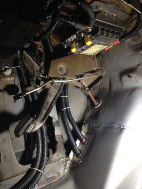

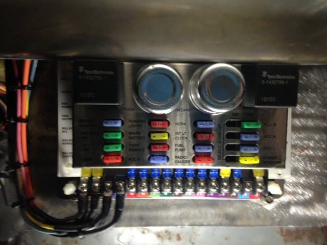

Got the battery cables ran up front to the blue sea fuse box , this gives it heavy duty protection fuses for alternator, relays etc. Also gives it a ground buss to the dash area.Ran 1/0 battery and ground cables from battery in trunk up to the starter.

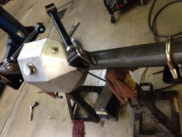

The header heat deflector I made from aluminum with a sheet metal brake and tig welded brackets to bolt them on.

Started running wires today to the fuse panel. Engine will turn over now and have power to the Hotwire harness and ECM11924742_10153455949863654_8167939665408889517_n.jpg

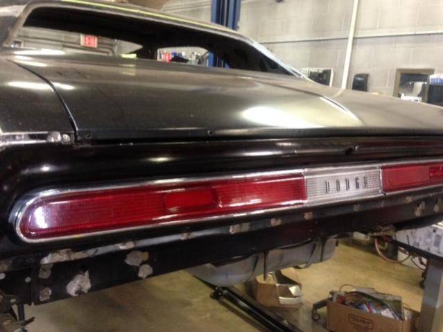

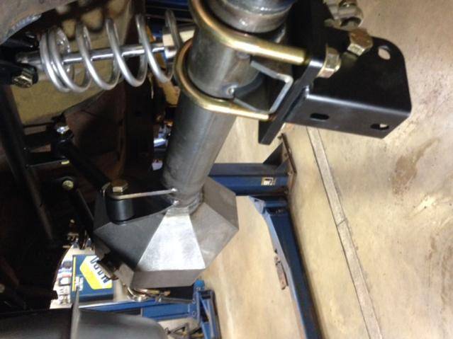

Test fitting the new tail lights and bezels. Also got a Fab 8 3/4 from Moser and installed the RMS street Lynx rear suspension in it

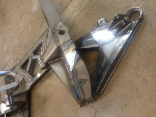

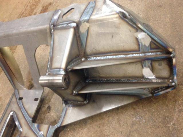

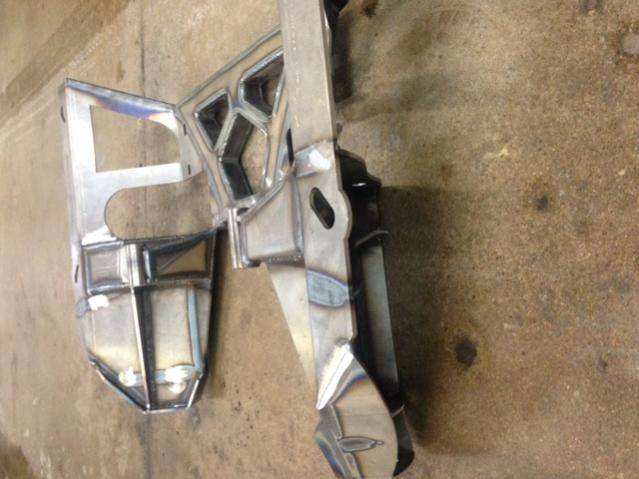

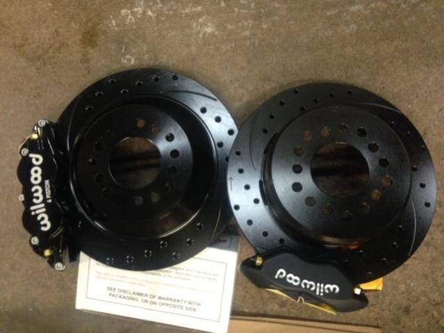

Using Magnum Force Transformer suspension . Getting ready to send it out for powder coating. Really impressed with the K-frame and control arms how beefy everything is , should hold up well on the street. Putting Wilwood brakes front and back.

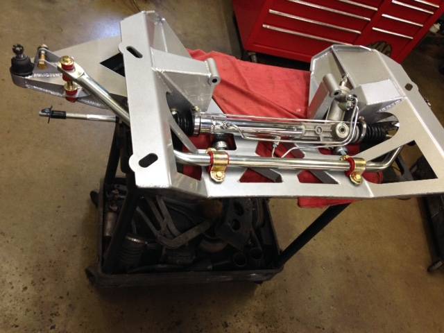

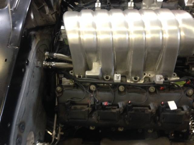

Got the Front and rear suspension back from powder coating . Will be working on installing the front and bolting up to the Hemi engine.

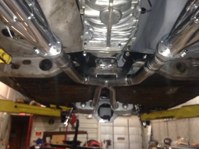

Got the TTI exhaust all on. Had to re-weld some things, but fits really well with the RMS rear suspension .Factory R/T split tips

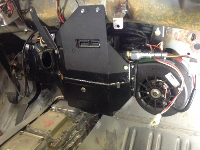

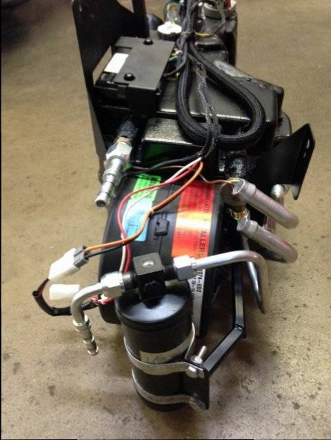

Working on installing a Vintage Air ac unit. Mounting the Drier inside , made a custom bracket to mount it to the box with a Hard line. Using Braided stainless ac lines from vintage air .

Also curious, did the a/c compressor come with the VA set-up, or is it a stock Dodge unit? Doesn't look like there's a whole lot of room where it mounts in relation to the MF motor mount on mine.

Have not got the wheels and tires for it yet. I will be using a percy wheel fitment gauge to order the correct offset.
The ac compressor is stock for the Hemi. I used adapters on it to adapt to the vintage air fittings.
Plenty of clearance to the MF frame. Had a stock K frame to begin with , which required trimming to get the compressor to fit it.
