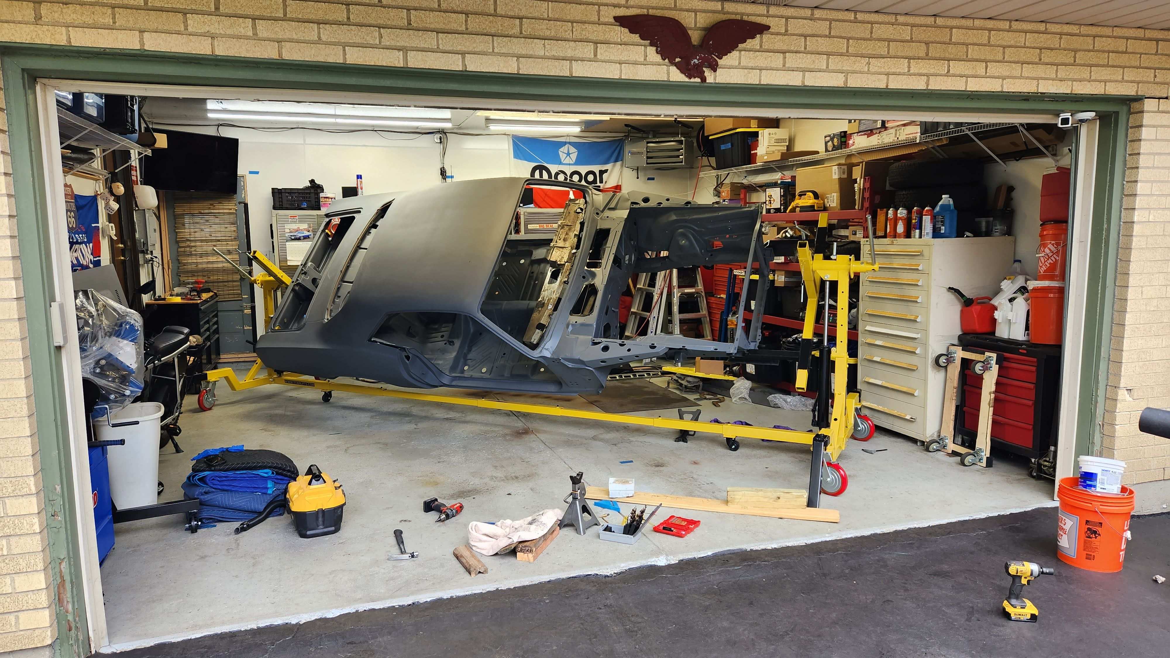

Chuck, Can you tell me what did it for you to get it balanced? I'm in the same boat with mine now. I have it mounted on the rotisserie, it's definitely bottom-heavy. I have the rear raised as high as I can to center (of the pivot point on the rot.) My front is level with the rear tho. It took two of us to get it turned as far as it is in the pic, I can't get it any farther, would like to get it to 90 deg. One other question is do you have your doors, hood, & deck lid on? I have just the shell, no doors or hood or deck lid yet. Maybe that's some of my issue? Any help is appreciated. Thanks...
Looks like you need to raise the back riser up further (where you see the roller). Front looks to be at least 2 or 3 holes higher than the rear.
Thanks. When I got home last not I stepped back and took a look at it. I could clearly see the pivot point was way too high in the front. I lowered the front and it became much easier to turn, it's still not where it needs to be but I also have to put the fenders, doors, hood, & deck on.
I guess the confusing part for me is there's pivot point adjustment and a height adjustment (using the bottle jack). Height doesn't matter once the pivot point is balanced, although you have to raise and lower the height uniformly once it's balanced.

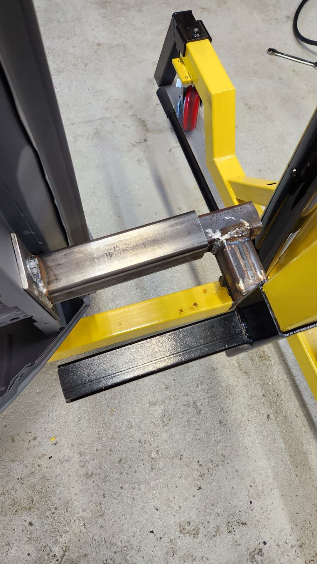

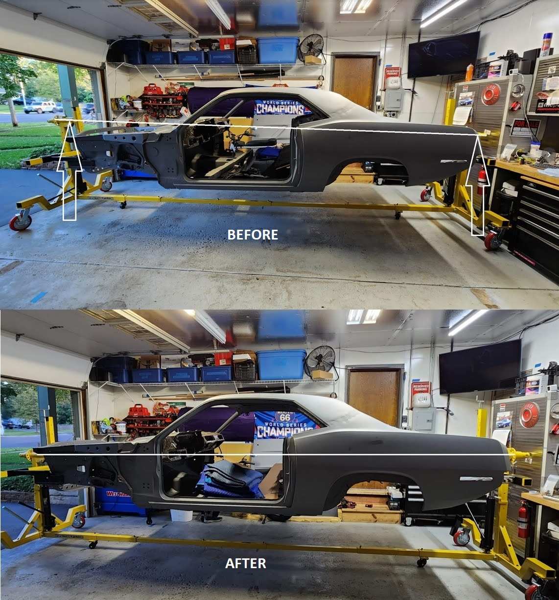

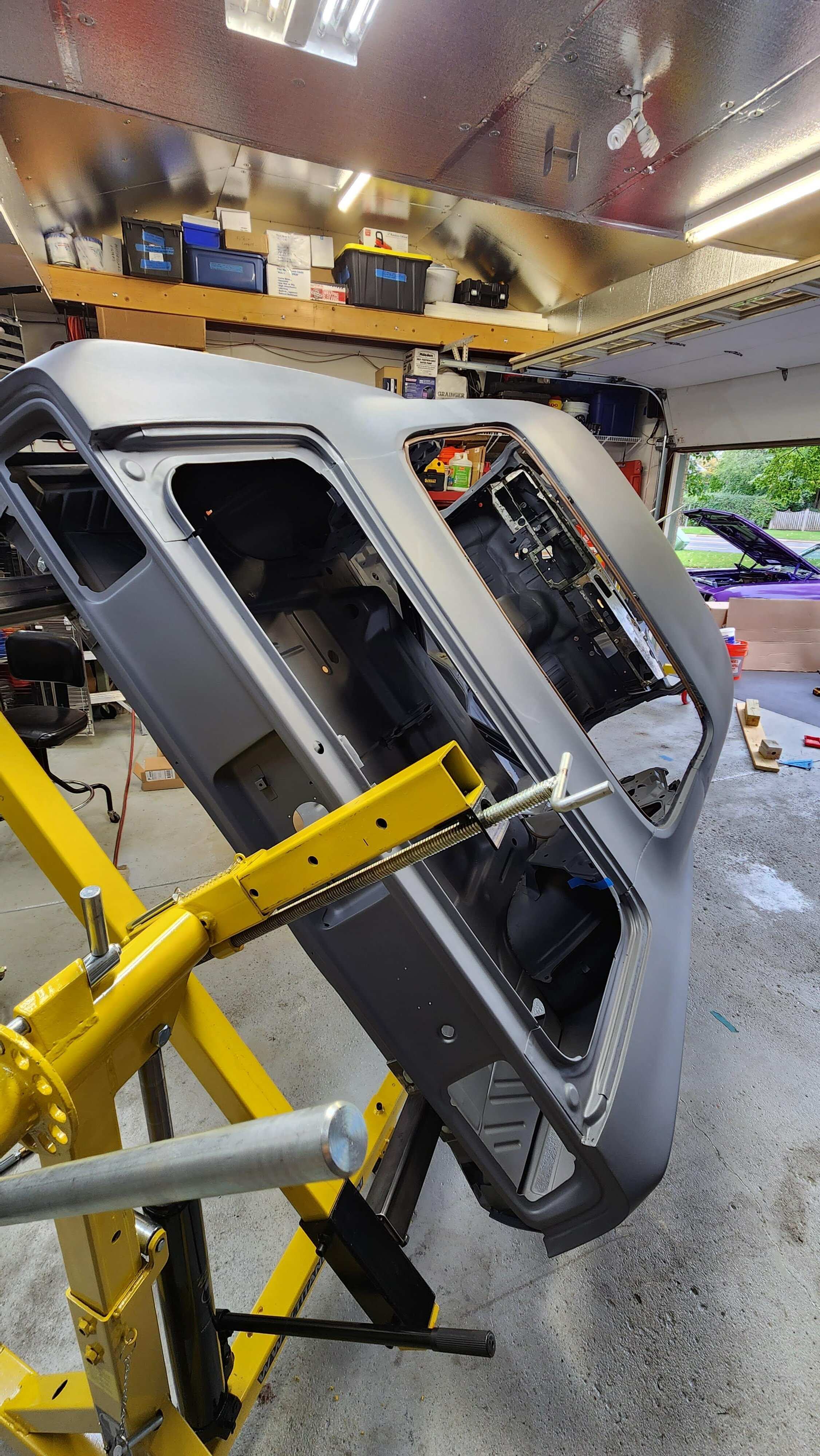

Closing the loop on getting mine to balance. I have it balanced well now, I can easily spin it myself. As said in my previous post, the key is to get it balanced at the pivot points and to keep them as level as possible (see before/after pic). Simple geometry. But after I did that I was out of adjustment on my rotisserie, and I had to modify my rear brackets to raise the car another 6". That did the trick, gave me more adjustment back.)
Hope this helps someone in the future...
