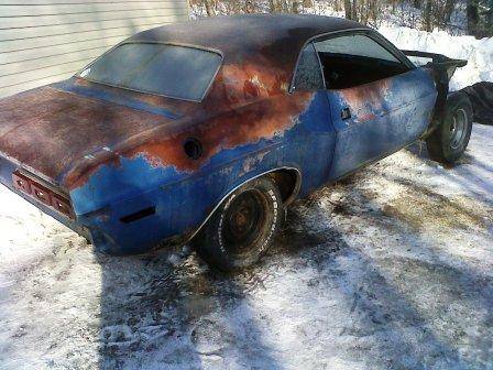

Hi, I'm new to this board so I hope im posting in the correct place to ask this question. Can anyone tell me what the best way to remove all this roof rust would be?

Welcome, and good luck with you project. While there's several ways to do so, if you're doing it yourself, I'd DA it & hope the sander doesn't land on the seat. Keep in mind, the only way do do it right is to remove ALL rust & corrosion... everywhere. If it thins out, you may be in for panel replacement.

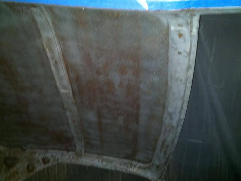

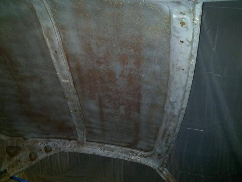

Keep in mind that I am a novice but this is what I did last summer. I found an old 80 gallon 5 horse compressor on craigslist of $200.00 on craigslist. When I went to pick it up the guy had a little sand blaster for sale to go with it for $25.00. So that got me rigged up to do sandblasting for $225. I had a lot of surface rust on the ceiling of the interior of my Challenger and I sandblasted it with no problem making sure to keep the nozzle far away from the metal and make multiple quick passes to prevent any warping.

I was right around 130 psi and used regular fine sandblasting media. We call it black beauty around here. It's pretty abrasive so I took a lot of quick passes and kept the nozzle well away from the metal and it eventually got it pretty clean. It looked pretty bad before I sandblasted it. The inportant thing is that there are no signs of warping. I just went out to my garage and snapped these pictures.
