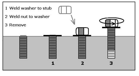

If it is the bumper arm bolt there is a other method to remove it. First, Smack the bolt head with a BFH. Done it on pipeline jobs and the shop. Sometimes it's busted off below the surface. You don't need a washer. The heat from the welder does the work.
Weld an other nut to the head.

As I know you know. The nut inside the frame needs heat. If you try snaping it off using impact or torque using leverage you will break the spot welds loose that hold it in place. Ask me how I know!
First keep smacking it with a BFH, heating and trying to brake loose. Keep getting a bigger BFH. It needs heat! At some point the the bolt head will become unusable. Weld a nut on it. AS I said the heat from welding a nut on penetrates all the way in.
The other option is to cut a U shape per se, on the bottom of the frame. Fold it open, heat the nut. Then fold back and weld shut. An other option would be to drill a hole to get the torch head into the nut. Then use a car plug to cover the hole.
