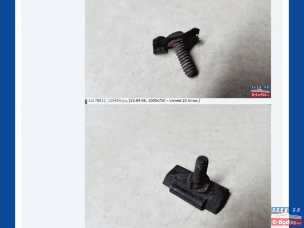

Oh I forgot!

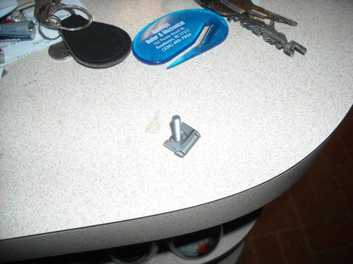

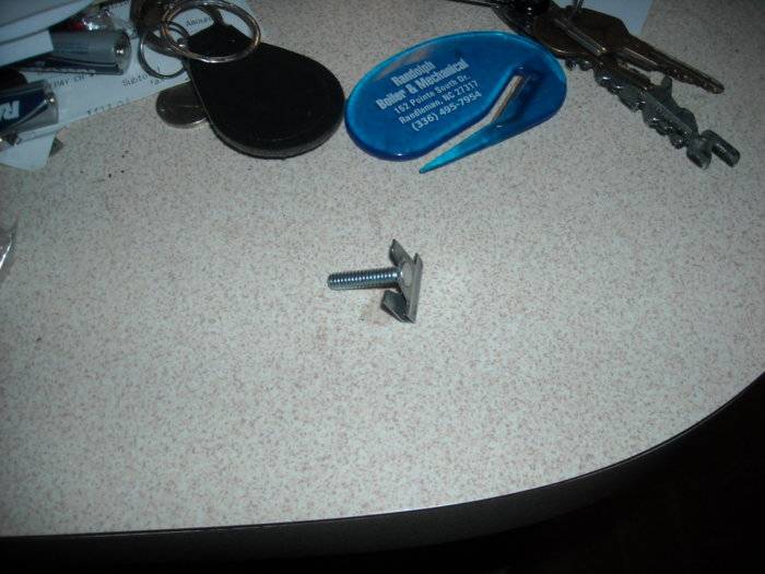

I found these two comrades here:
I assume these to be the correct lower fasteners? Can someone confirm that?
If yes i only need the previosly mentioned infos about the edge fasteners!

Oh I forgot!
They are the correct fasteners. I have made them from channel. You have to do two cuts in the channel and bend it. I used carriage bolts that were tack welded to the channel.

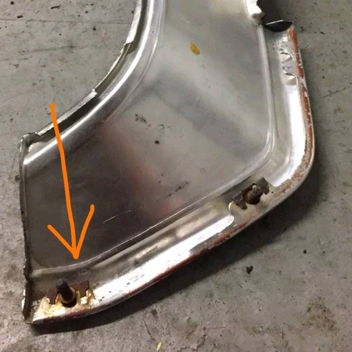

B5BLUERT
Jul 26, 2013
138
Southeast Nebraska

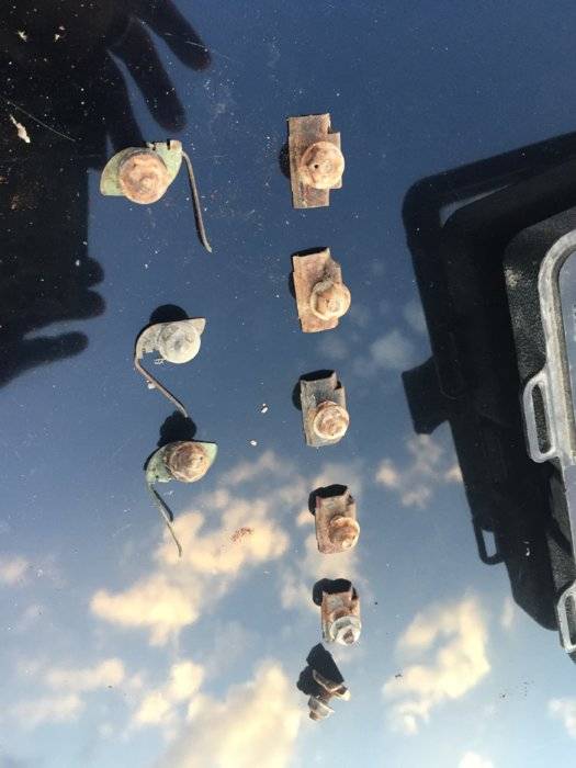

I just got some of these for @plymouthbelvy , they are really hard to find ! Let me know in a month if ya haven’t found them, I will be at a place that there is a couple se’s With finish panels that are parts cars , just a warning, they won’t be dirt cheap but he usually is somewhat fair with his prices .

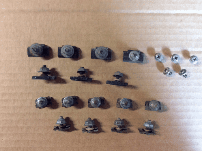

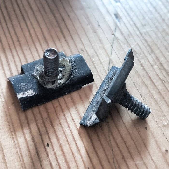

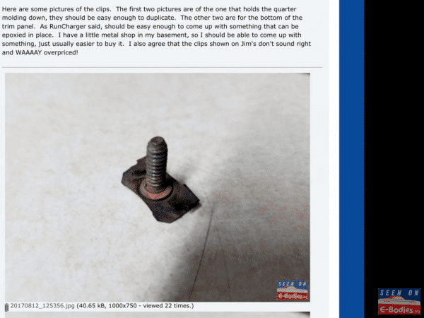

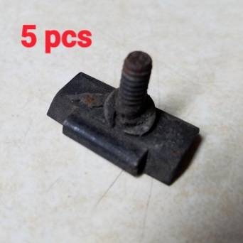

Hey there @B5BLUERT !
I would totally need the two different retainers shown in the following pictures.
I marked the pics with the needed quantity.
It would be a great thing if you could manage to get hands on these and let me know!

Oh, and just in addition to clarify - maybe for other users:
The "6pcs" corner retainers are needed instead of the standard ones that @B5BLUERT posted in his pic on the left side.
What i saw on other forums a lot ppl think they can use the standard retainers with the tail panel.
That’s interesting because I personally took those off a two owner se that had a dash fire years ago that a good friend of mine owns. Those clips on the left are what I removed from the corners. Maybe @plymouthbelvy can chime in and tell us what he used to put his finish panel on last week.
Hi Guys,I used what Sebastian has in his pics.I used the center ones from B5BLUERT but not the corners.They must have been switch out for those corners in pic. Mike.

Thanks for the replies.
It would have been a good thing if the standard ones would have been useable.
Now we know!

Does anyone have a pic of the lower fasteners in a panel? I'd volunteer to make a bunch of these things, but man, I have nooooo extra time.
/sixchall
Jan 20, 2017
212
116
Quapman.........here is my pic again of all the original fasteners for the ‘70 Challenger rear SE finish panel. They are to my understanding just as hard to find as the panel itself. I have a finish panel and fasteners, it is truly hard to place a value here.

Sebastian
Jul 22, 2017
114
Hey @quapman
Here s a picture from my panel with one of the two clips i have.
The clips wont fit very tight but when you fasten them through the holes they kind a get jammed in position.

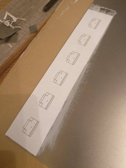

I also started to make tech. drawings of the bottom clip.
They are ready and very accurate, with bending lines.
I stopped working on them because i move and i wont have access to a shop for now.
I can share the drawing if needed.

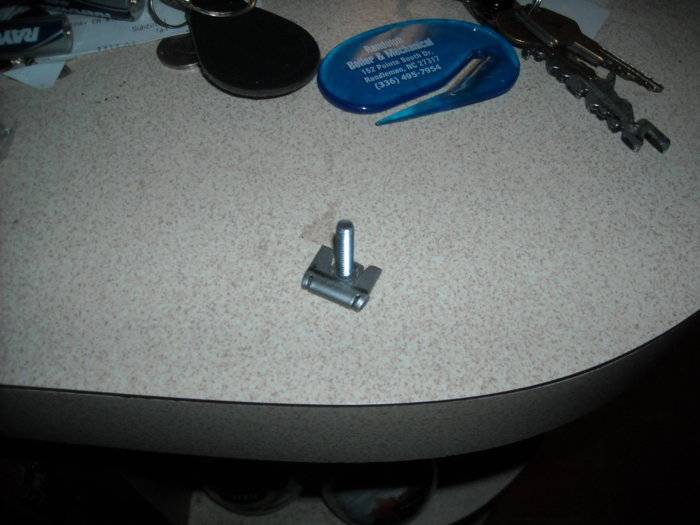

quapman
878
225
I modified some furniture clips and this is a first attempt. Creative criticism please. I ordered some shorter studs, also.
