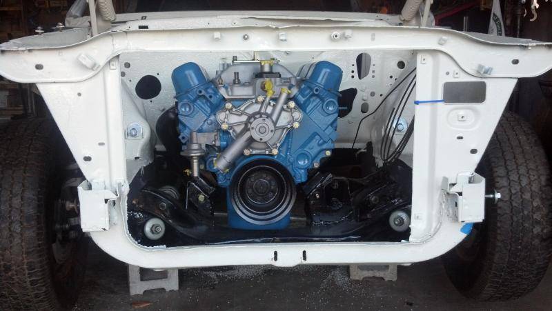

This is a good picture of a 340 in my 73 Challenger. I thought there was a problem with it being off center at first too. Notice how it is set off to the passengers side.
