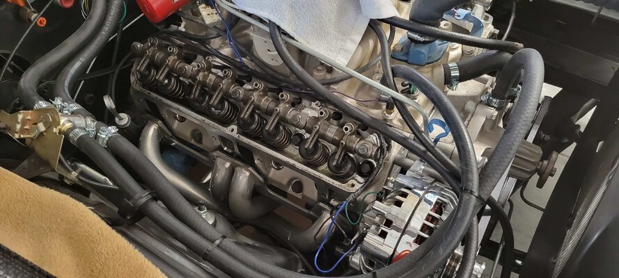

Here's the setup. Hydraulic lifters, mild cam, pushrods that have the "cup" at the end, adjustable rockers on aluminum heads (parts came with the car when I bought it).
Also, look at 4 and 8 (just like 1 and 3) exhaust ports, plugs and top of pistons really charcoal in appearance - thoughts?

Nice set up !
looks like fuel distribution problems or misfire .
If it's fuel, then it would would be one side of the dual plane intake, right? As the other four are clean as a whistle. I never set up a thermoquad before, so I need to take a closer look at that.
I got a new rotor, cap, wires, and plugs to eliminate anything misfiring. Unless the distributor is somehow playing favorites?

There is a small O ring in the well under the emulsion tube if it is damaged or missing it will leak fuel into the intake while running , that is the first place I would look but as u say it is not consistant with a dual plane feed , it should be 2 outer & 2 inner cylinders
