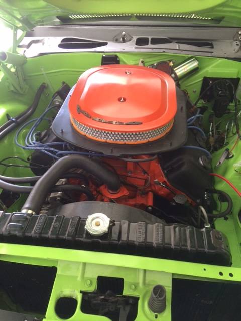

Heres my green car with Chrysler distributor. I don't have a good shot of the one with an MSD but it is probably 1/2" or 1" taller.
