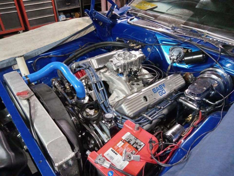

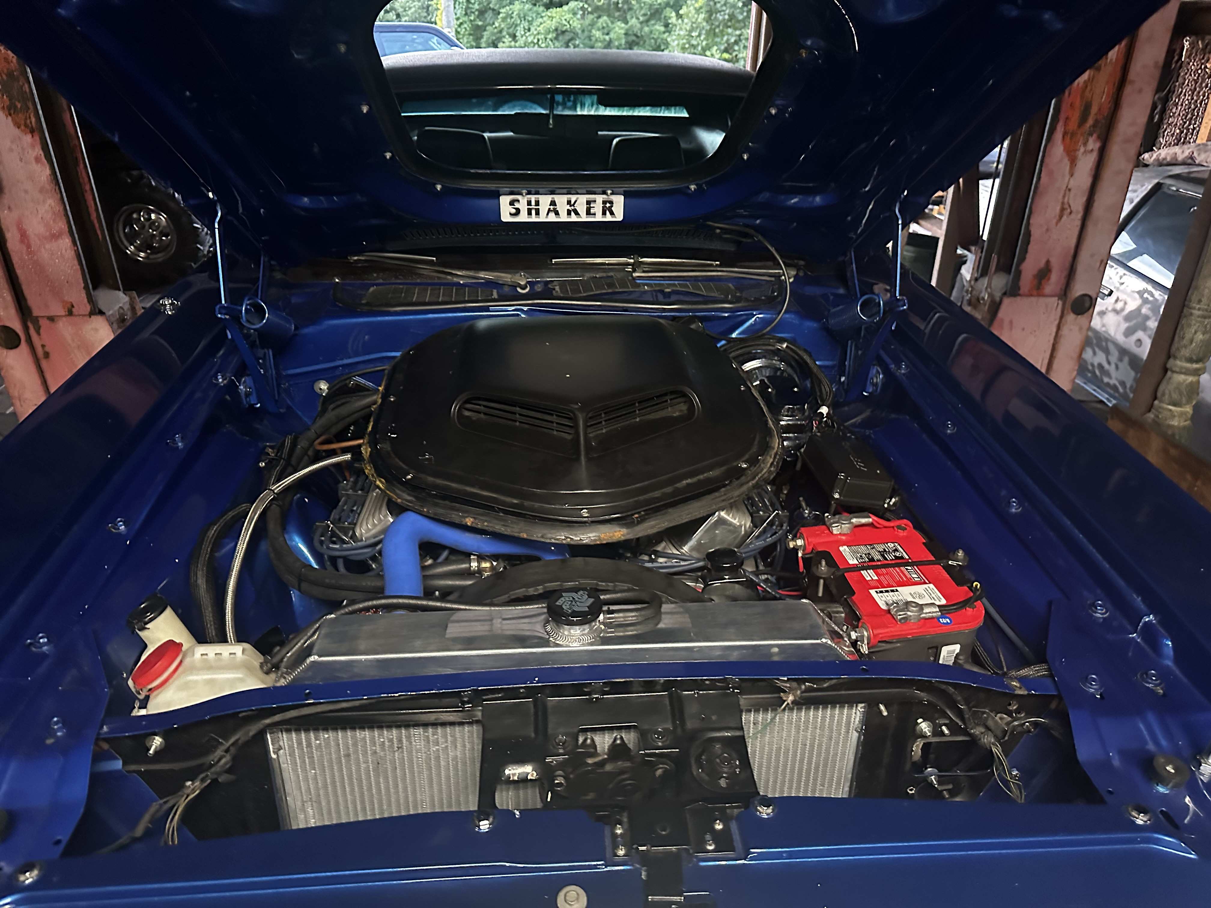

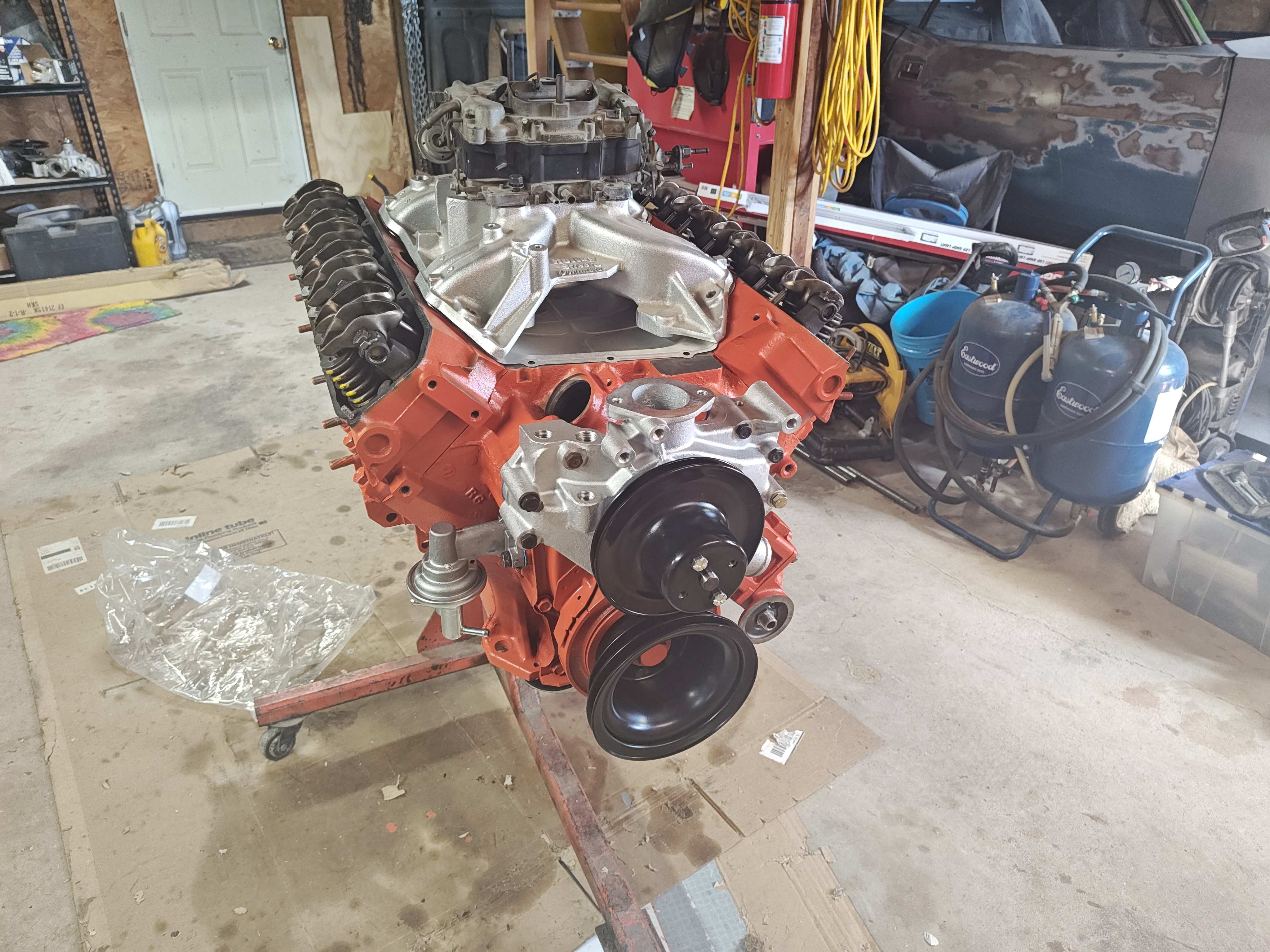

Well my biggest fear rebuilding the 440 was realized when I went to shut the hood. 72 challenger with a shaker. For the rebuild I went with Edelbrock 60925 cylinder heads. Edelbrock performer rpm intake. With a Holley Sniper on top. Somewhere in the design I screwed up in my measurements. So I’m left with a bad ass 512 stroker motor and a shaker hood that won’t close around the actual shaker. Curious if anyone has encountered a similar issue and has any suggestions on ways to remedy this. I really don’t want to eliminate the shaker or buy a new hood if at all possible.

How close are you from closing? Obviously the carb needs to go down or the shaker needs to go up, which means you would have to change the intake (or possibly carb) or modify the shaker.
If you measure the height of the gasket surface from the shaker itself (maybe valve cover) with the hood open, then remove the shaker and close the hood to measure to the bottom of the gasket surface to the valve cover, it will give you an idea how far off you are.

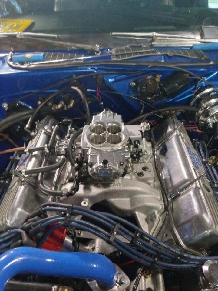

I’m 1.25” off. Originally the car had a 750 Holley with a 1/2” riser. The performer intake was the shortest I could find only a 1” taller than a stock manifold. My dumbass thinking was that I could remove the 1/2” riser and there was just enough clearance to make up the difference. Evidently not. I really like the Holley Sniper on it. It’s running great. It’s a very expensive system and I really don’t like the idea of converting back to a carburetor. It seems modifying the shaker baseplate or putting the stock intake manifold back on may be the best solution.

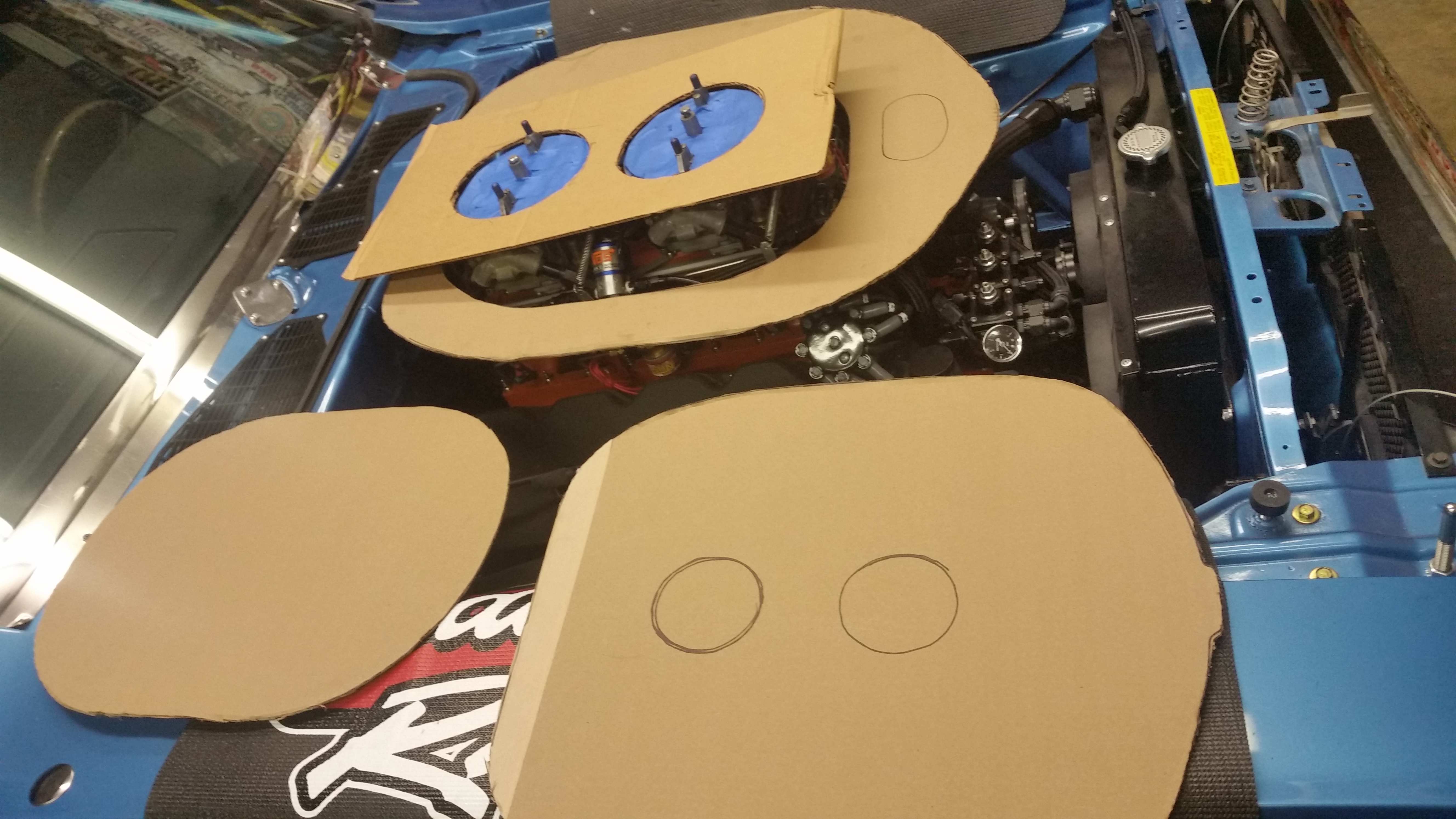

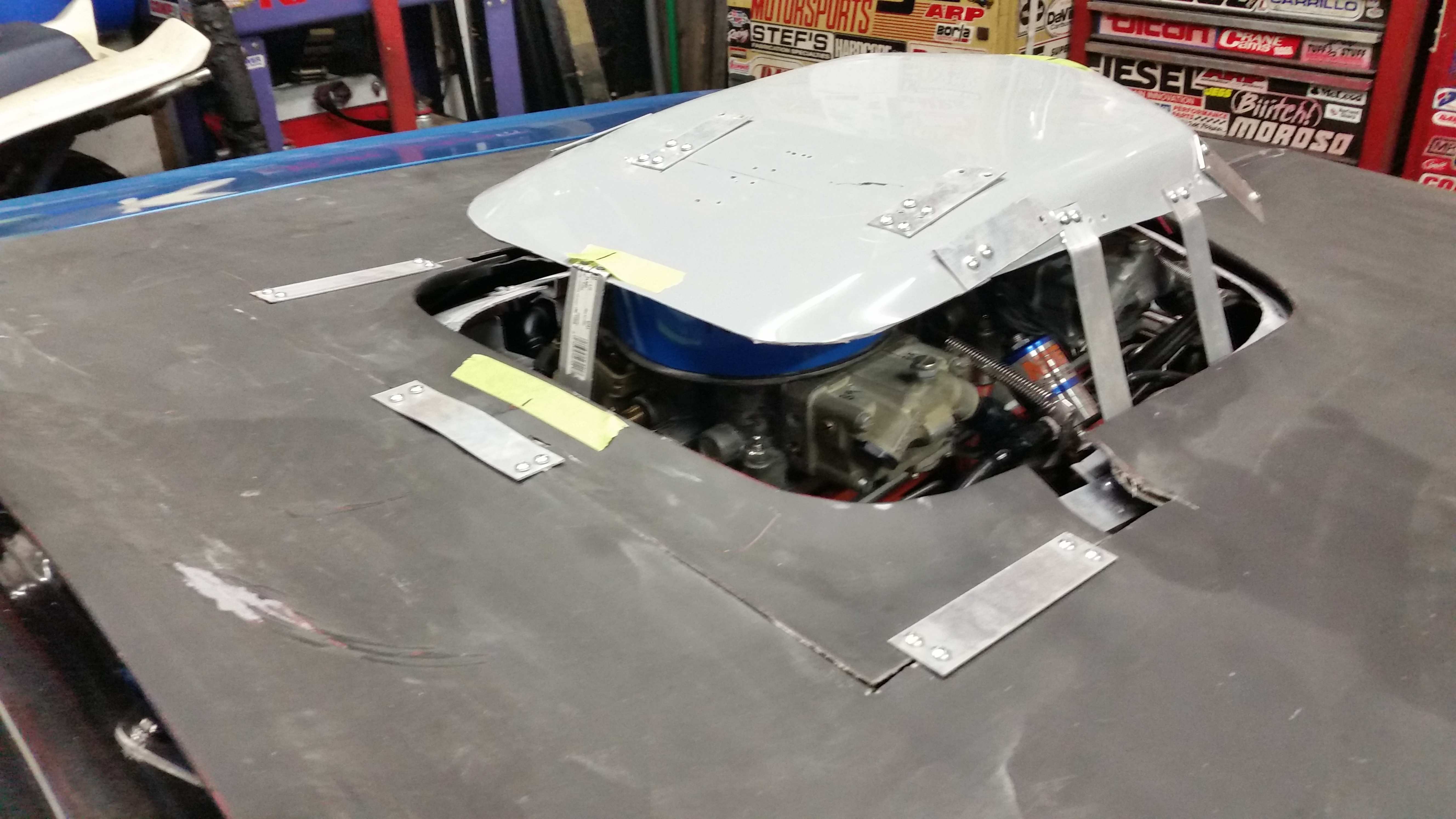

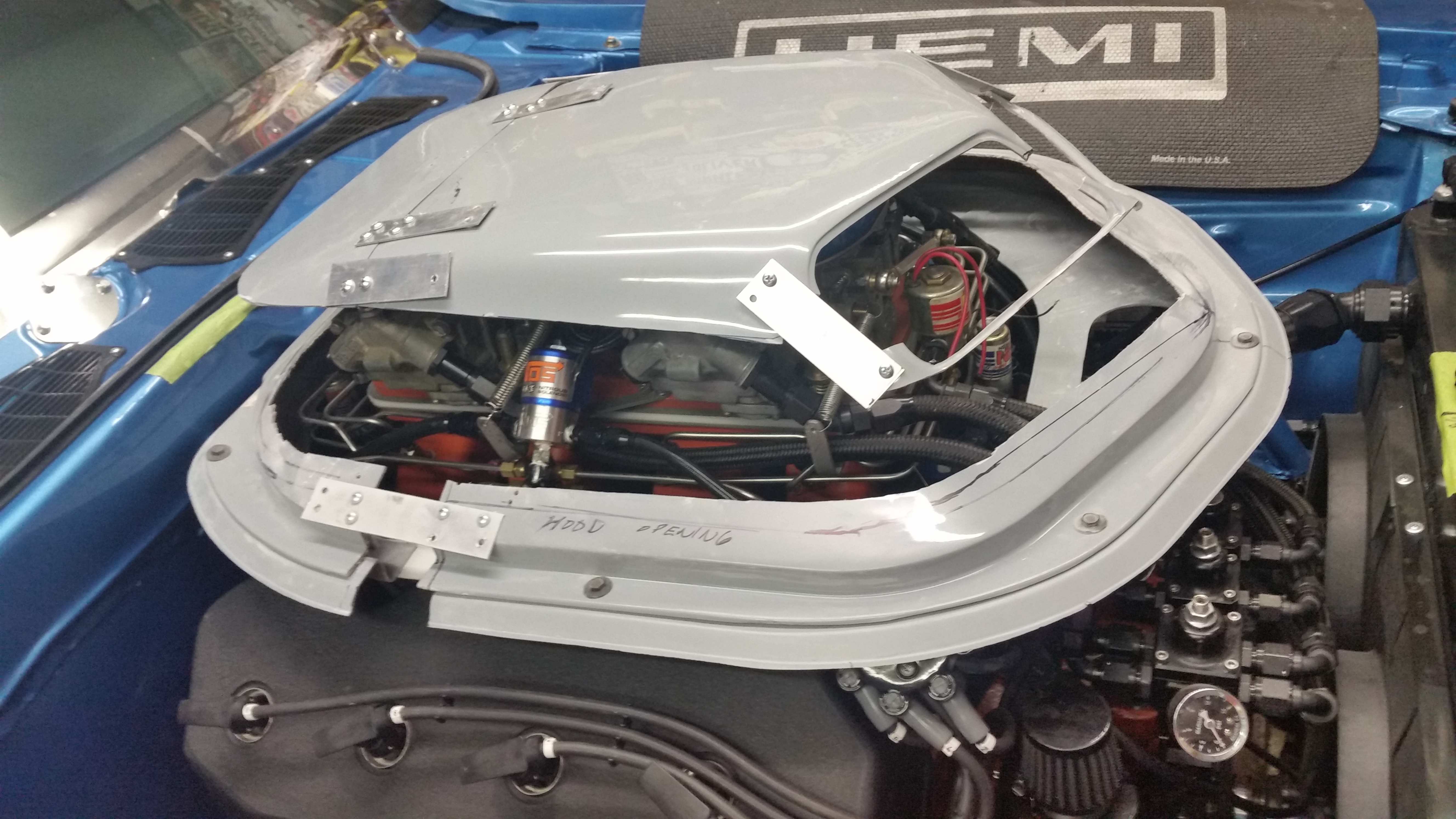

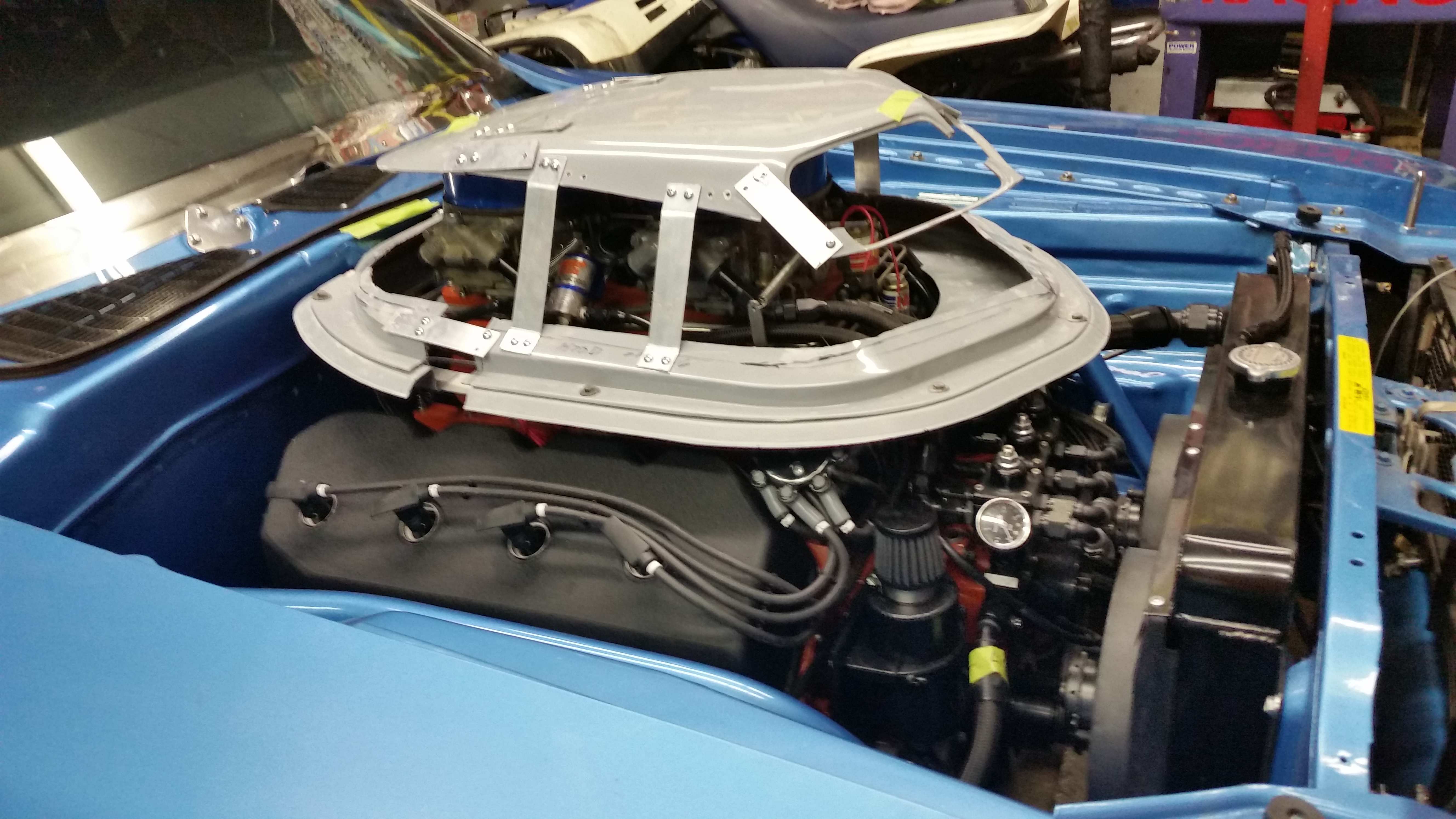

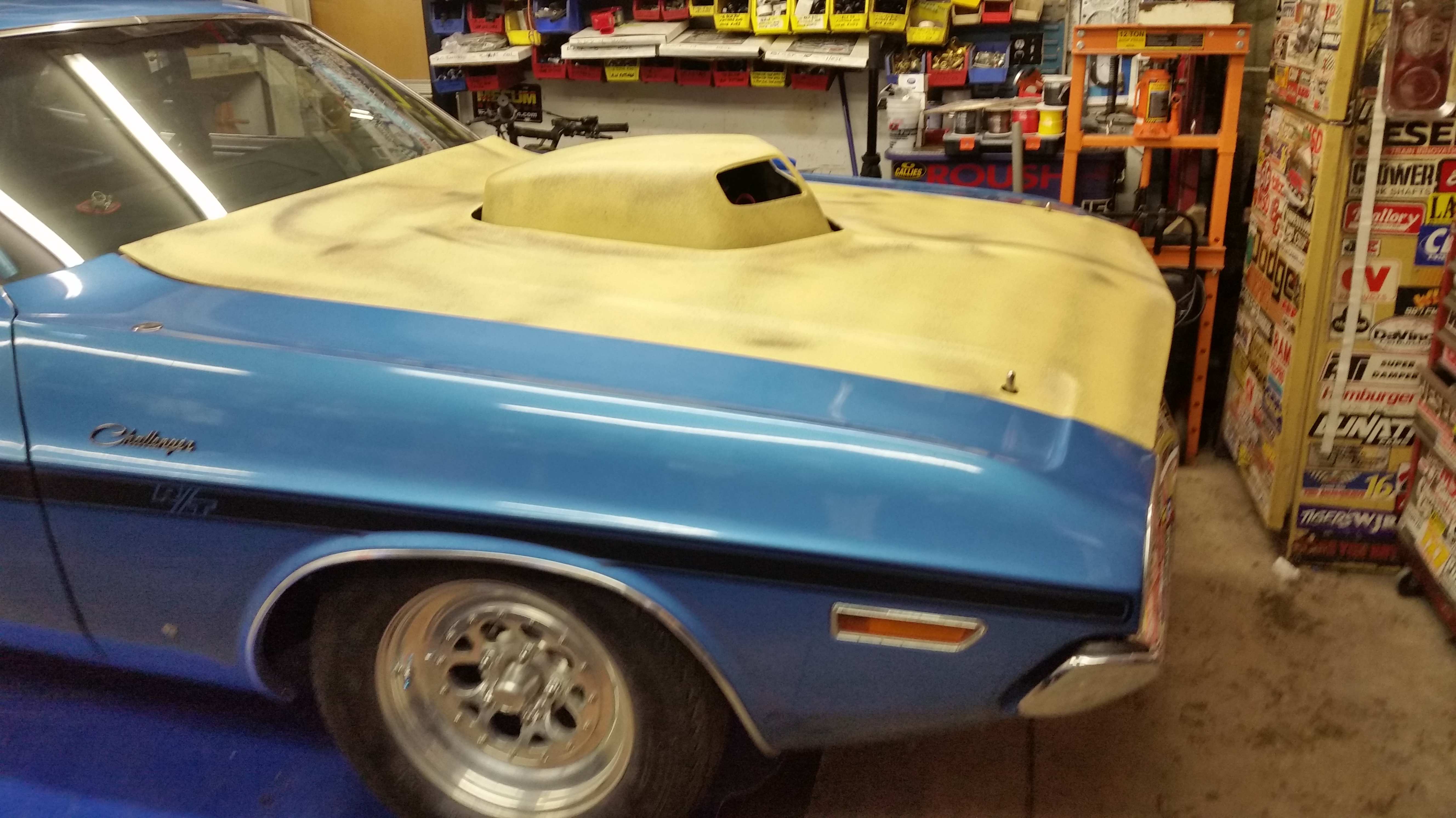

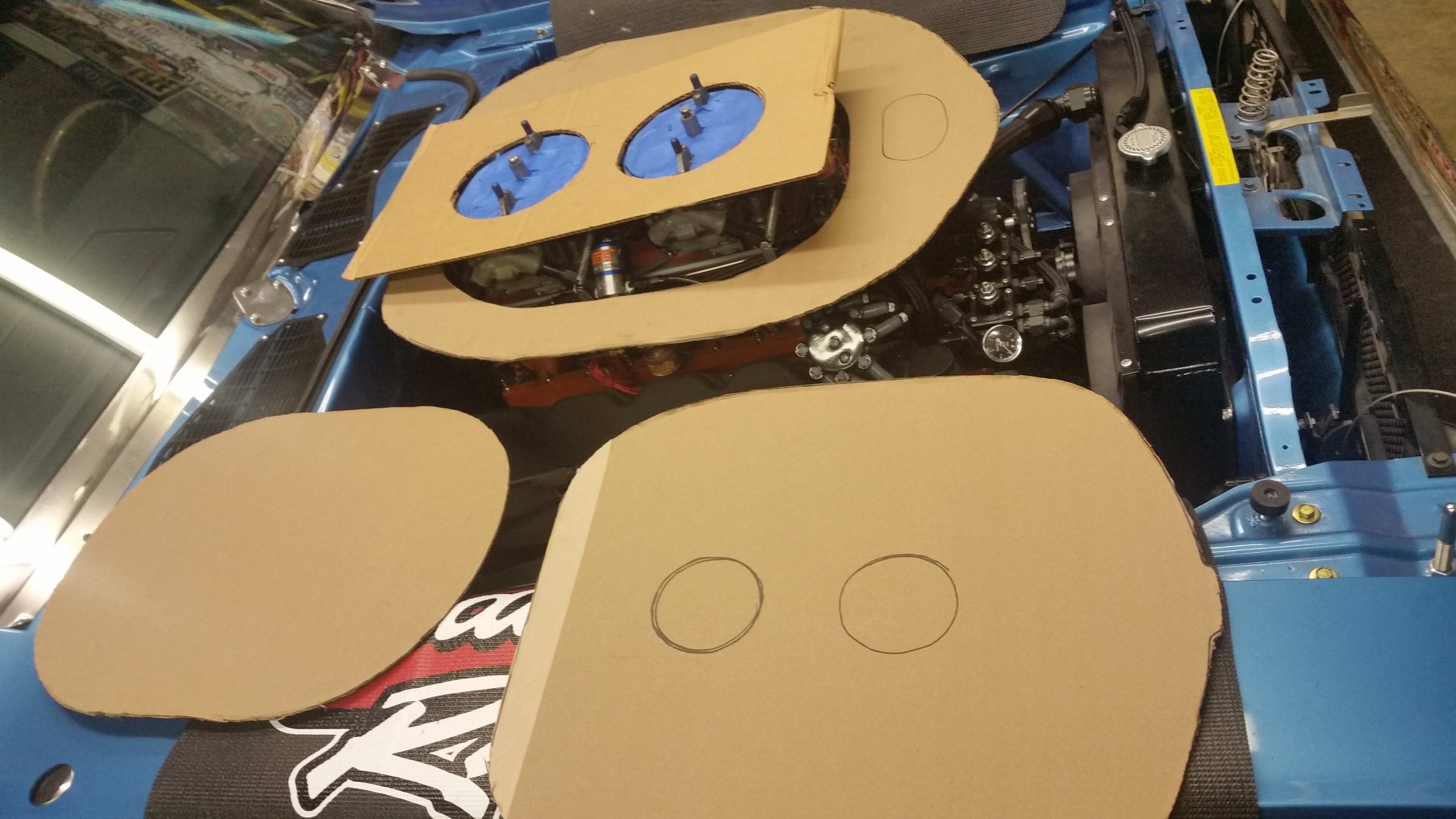

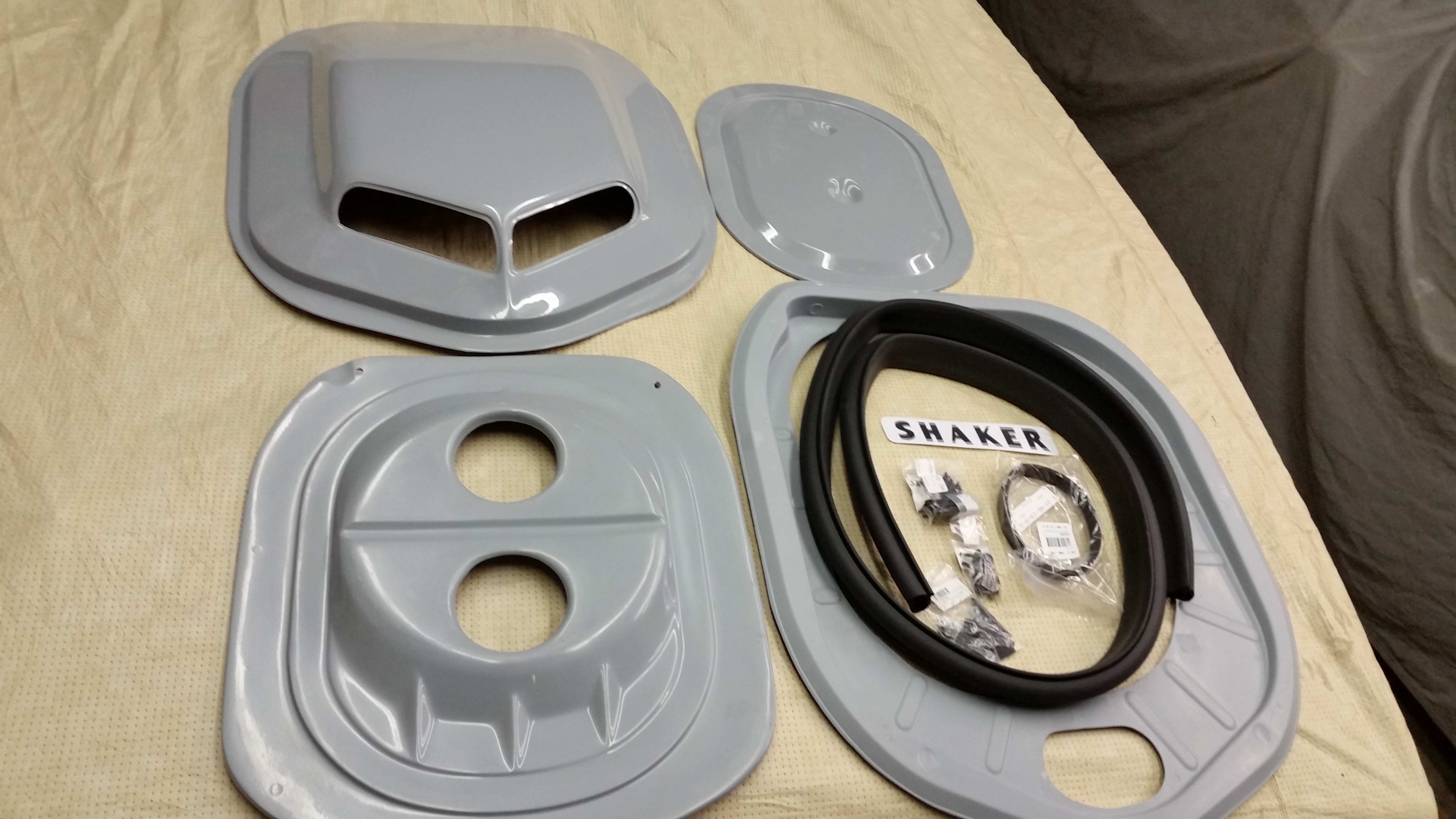

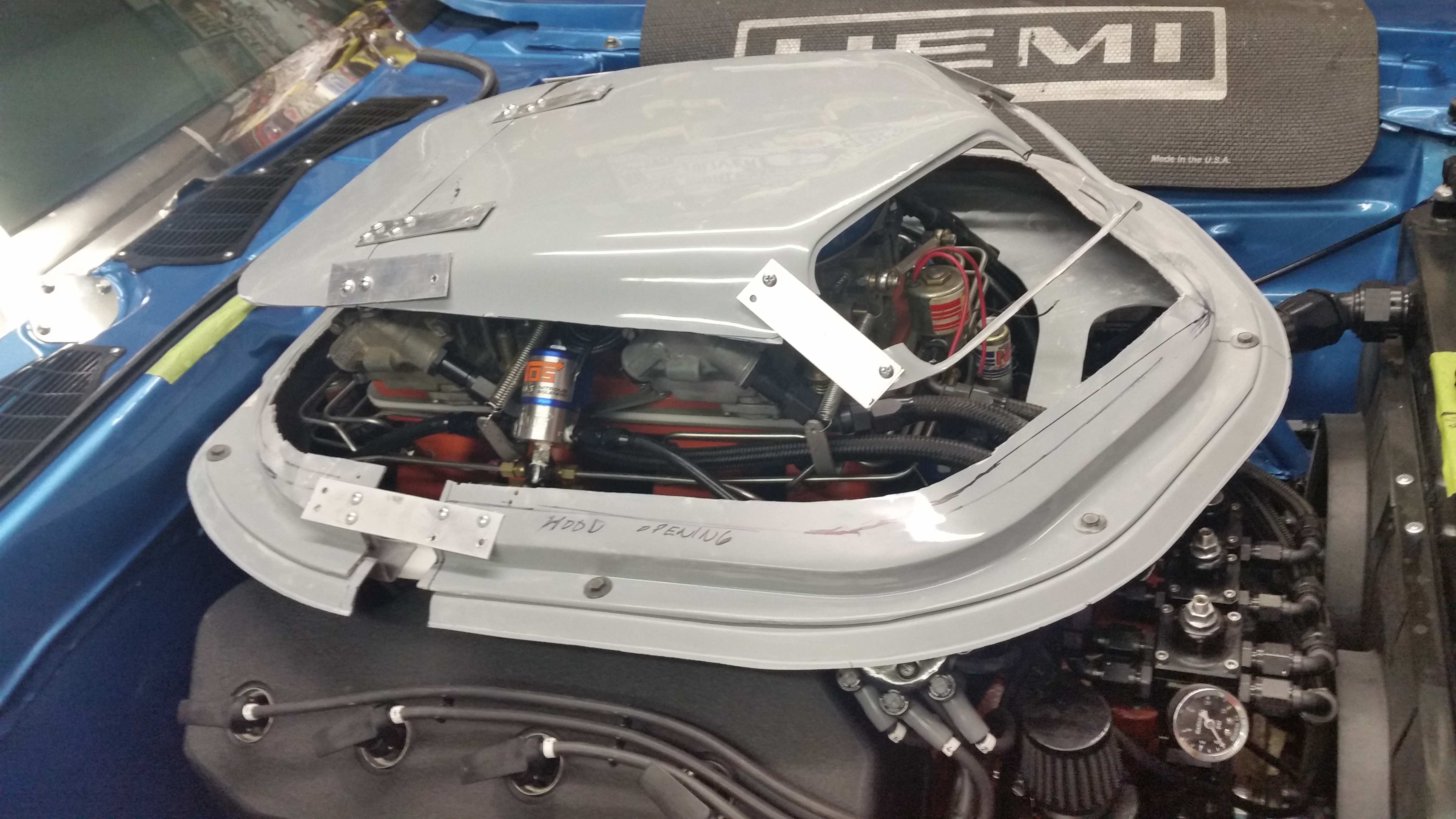

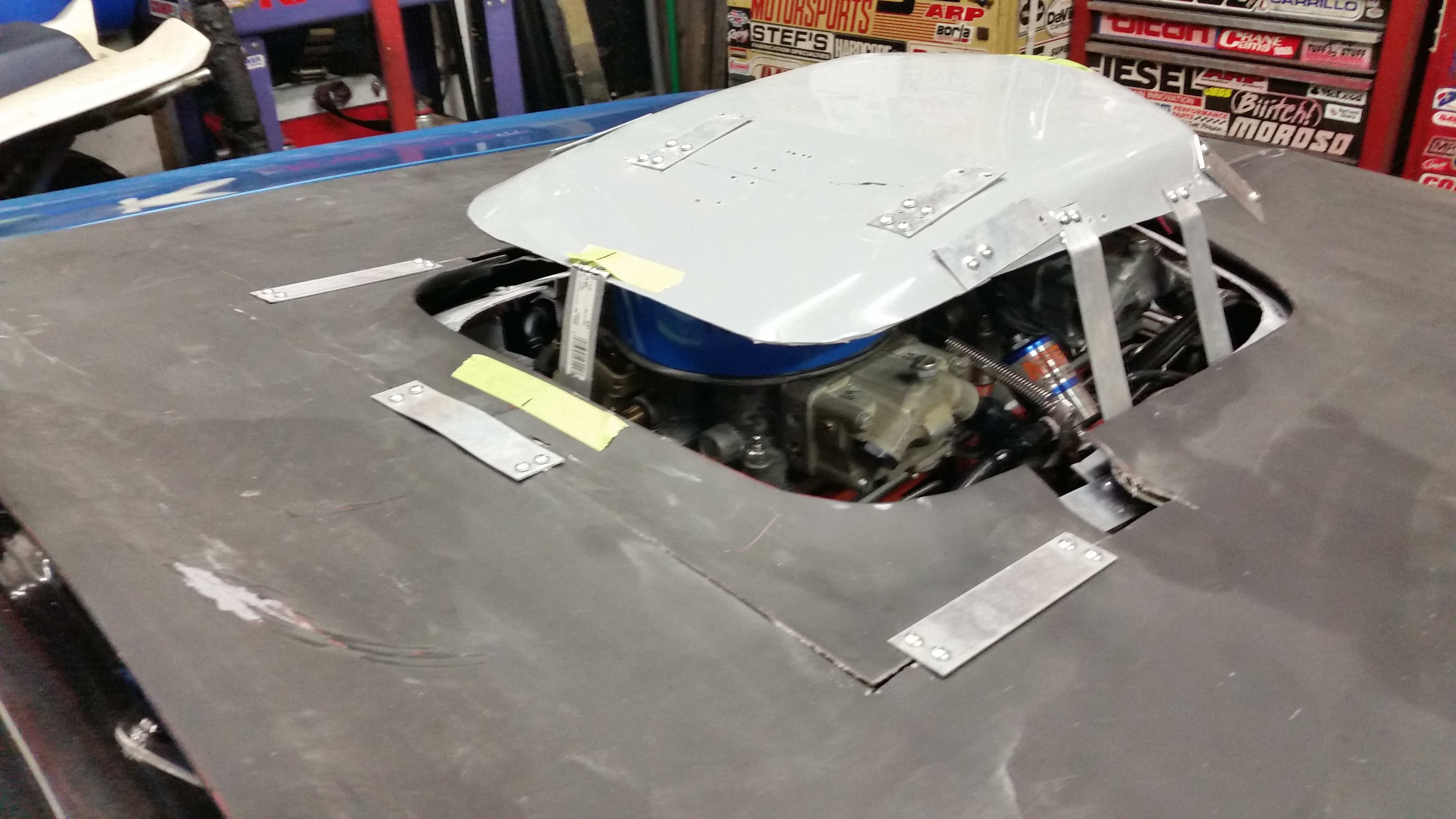

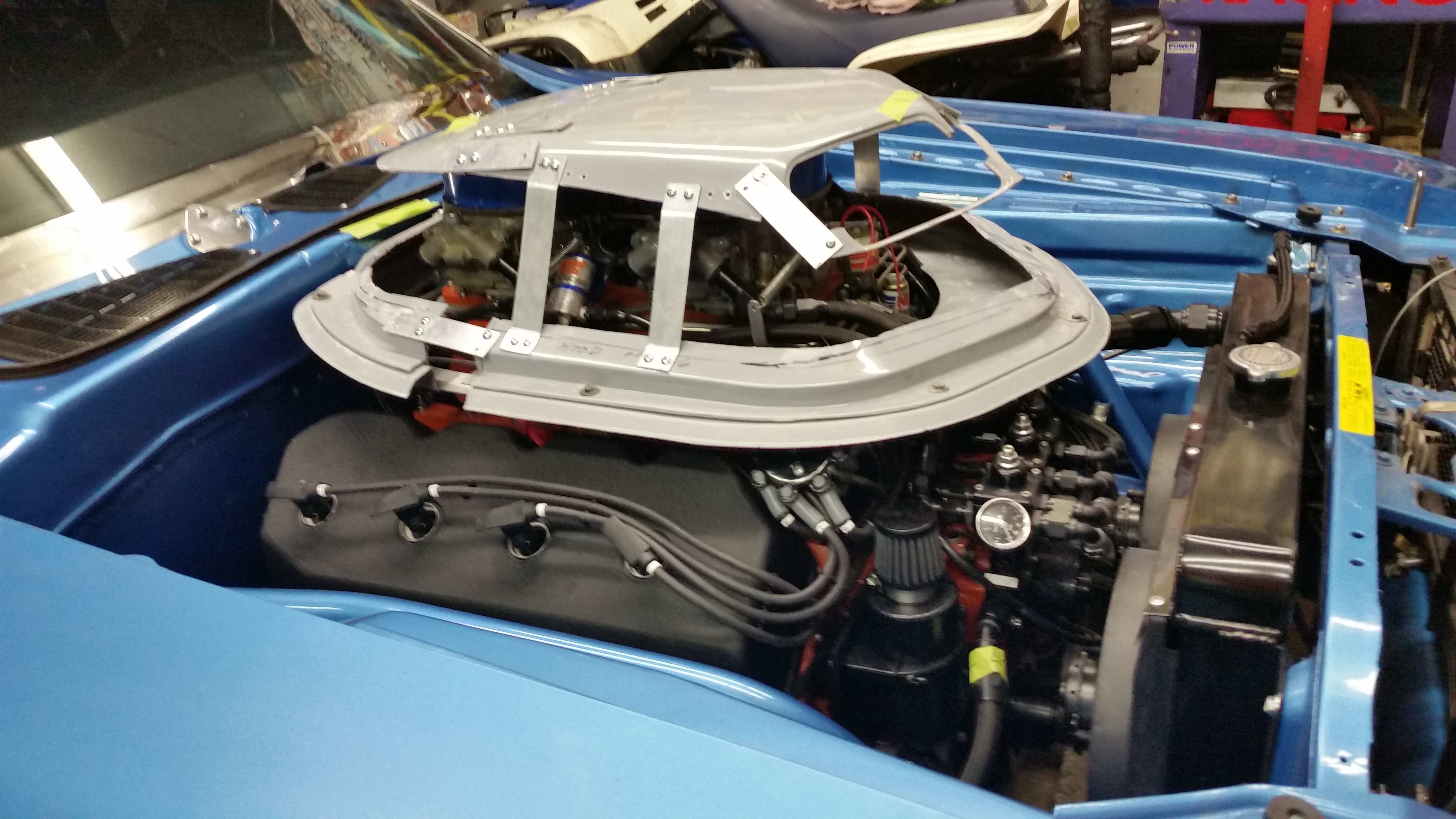

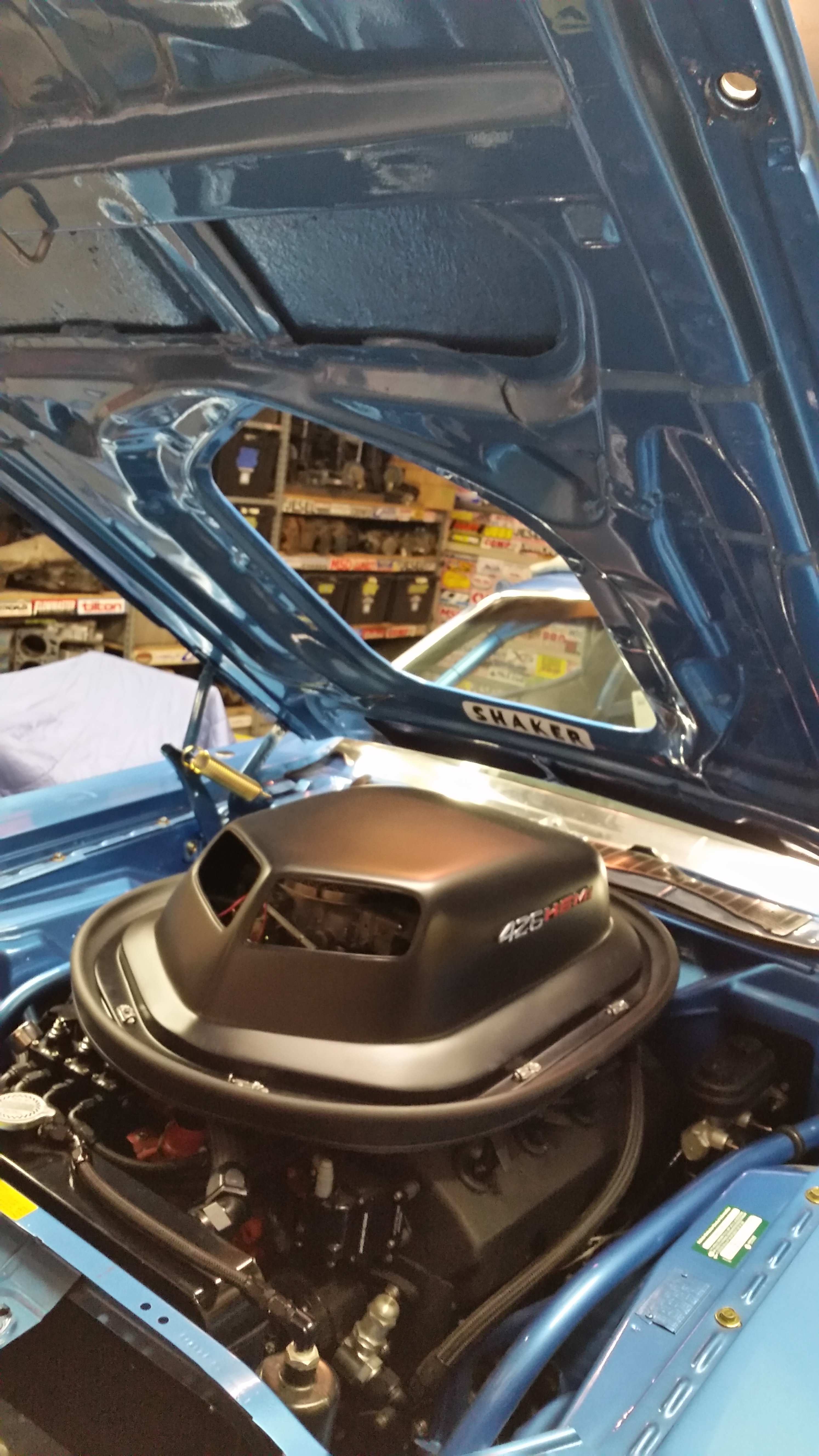

Anything can be modified and made to fit with some work. I made my Shaker fit on a high rise dual 1050 Dominator tunnel ram intake with two Nitrous fogger systems. I had to stretch the hood opening 3" longer, the base and bubble 3" longer, raise the scoop 4-1/2" taller and opened up the nostrils 2-1/2" taller. Most don't like it. Saying it is too much. I love how it turned out.
Nice work! That looks pretty mean.

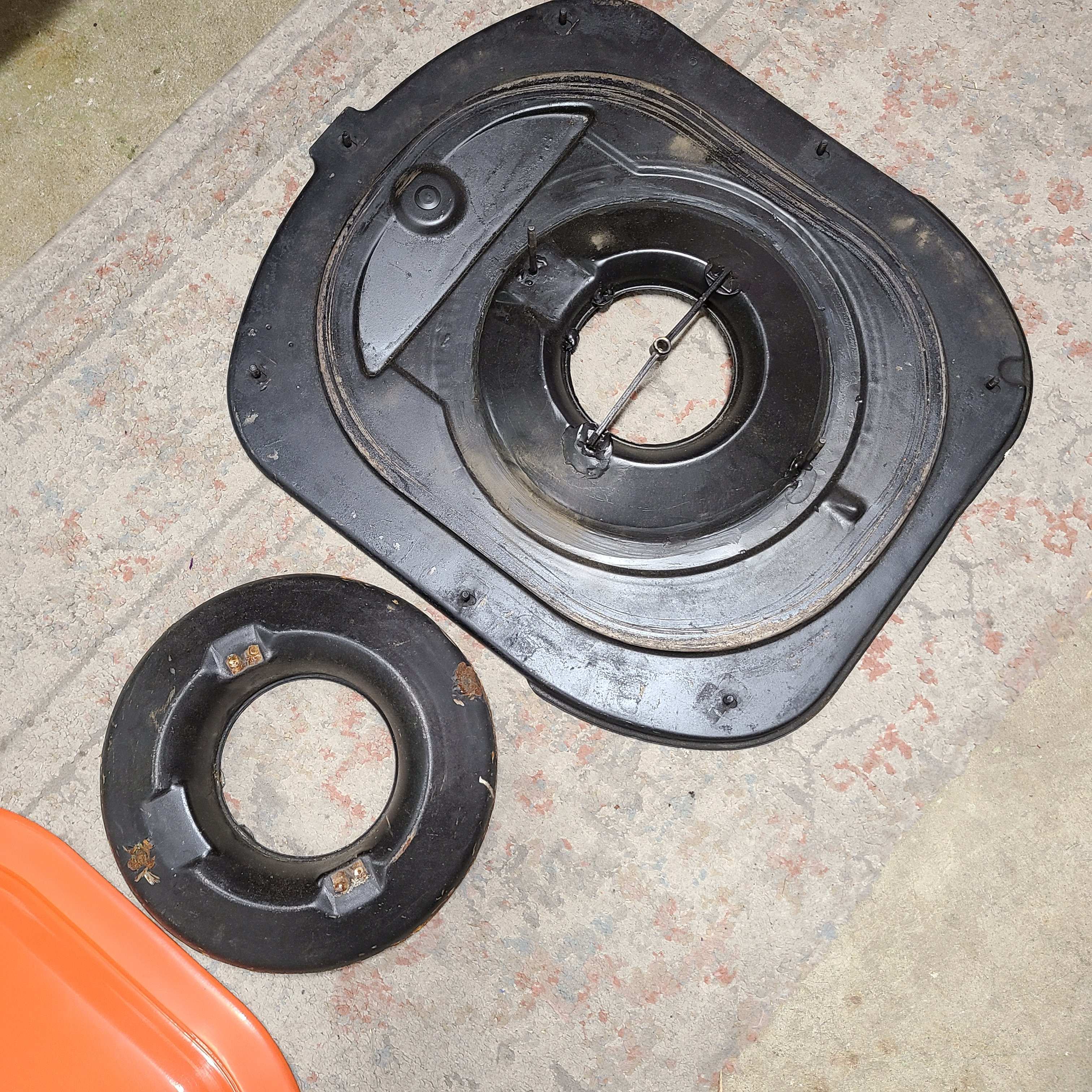

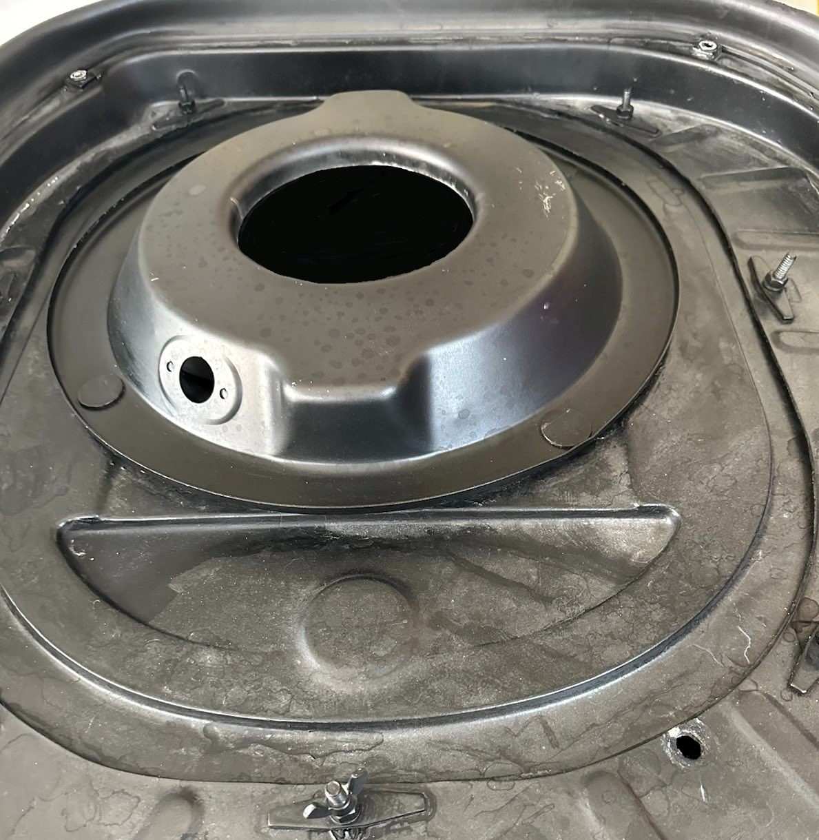

Not hard to modify the base plate if you have one to sacrifice. I cut the center out of this 383 base plate and tacked in a 440 center plate to lower it for a 440 install. I have this one listed for sale on this site.

Thanks all,
After measuring it up I was closer than I thought. A angle grinder and a cutting wheel and the hood will close. I took the base plate out. Drove out the studs, cut the bottom lip off trimmed the edges and mounted it from the top instead of the bottom.
