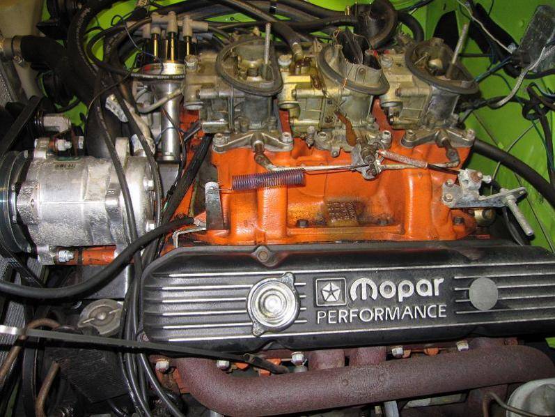

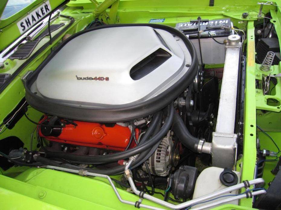

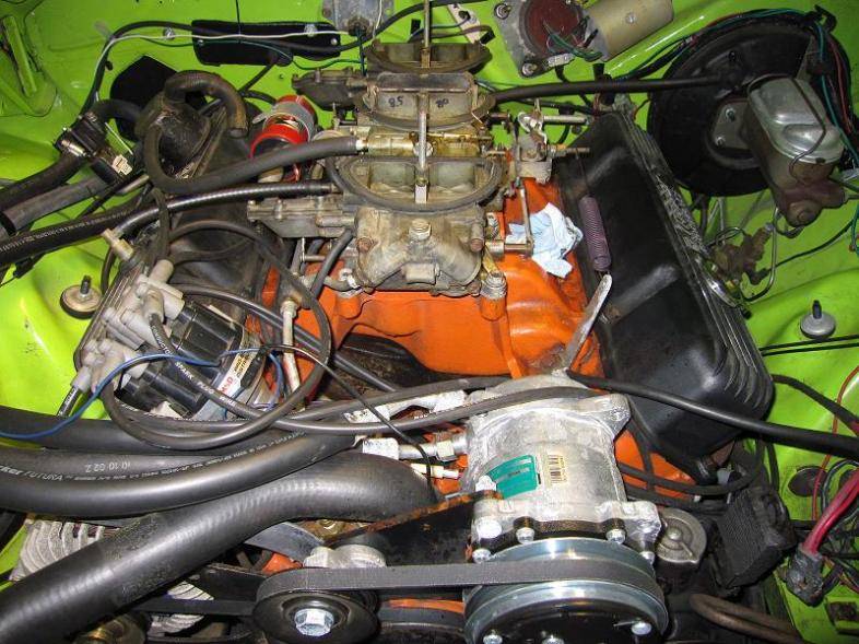

Dec 12, 2011 #3 challenger6pak Well-Known Member Joined Feb 27, 2011 Messages 4,037 Reaction score 897 Here are some pics of Tommy's car on Cuda-Challenger.com. It has a Vintage Air system.
Dec 12, 2011 #4 challenger6pak Well-Known Member Joined Feb 27, 2011 Messages 4,037 Reaction score 897 You can use the factory a/c heater box and just change compressors. You also would have to make new a/c lines. That is the way I plan to do mine.
