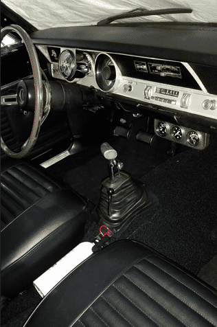

I have a Mr. Gasket in my '69. Basically, the same system.
Lubricate the gate system. Over time they may dry up. Left to sit, they can rust and hangup.
Make sure the trans and shifter are in neutral when you tighten the lever nuts. Keep all levers from turning on you with an adjustable wrench.
On the 1-2 shift, it takes a bit of time for the gate to drop so it should not have to be yanked like you're at the track.
