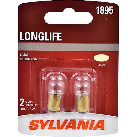

70 and 71 side marker bulbs are the same, 1895. The rear ones need to be grounded. You may need to scrape some paint off on the inside trunk area to get a good ground or if you don't want to scrape your paint, you can run a short ground wire from one of the acorn nuts to a tail light stud.

Had a better chart can't find it at the moment. Not able to check my car at this time, though my old rear harness has a GE #1895 still in it.

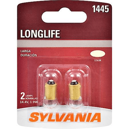

Cornering lights listed #1445, may be a newer referenced # bulb now.
The rear bulb socket grounds to the housing in turn is secured/grounded also by the retainer cover(bracket).
Advance Auto carries both of these. I just called and conformed it.
Part#1445LLBP2 and #1895BP2
Hope this helps a bit.
