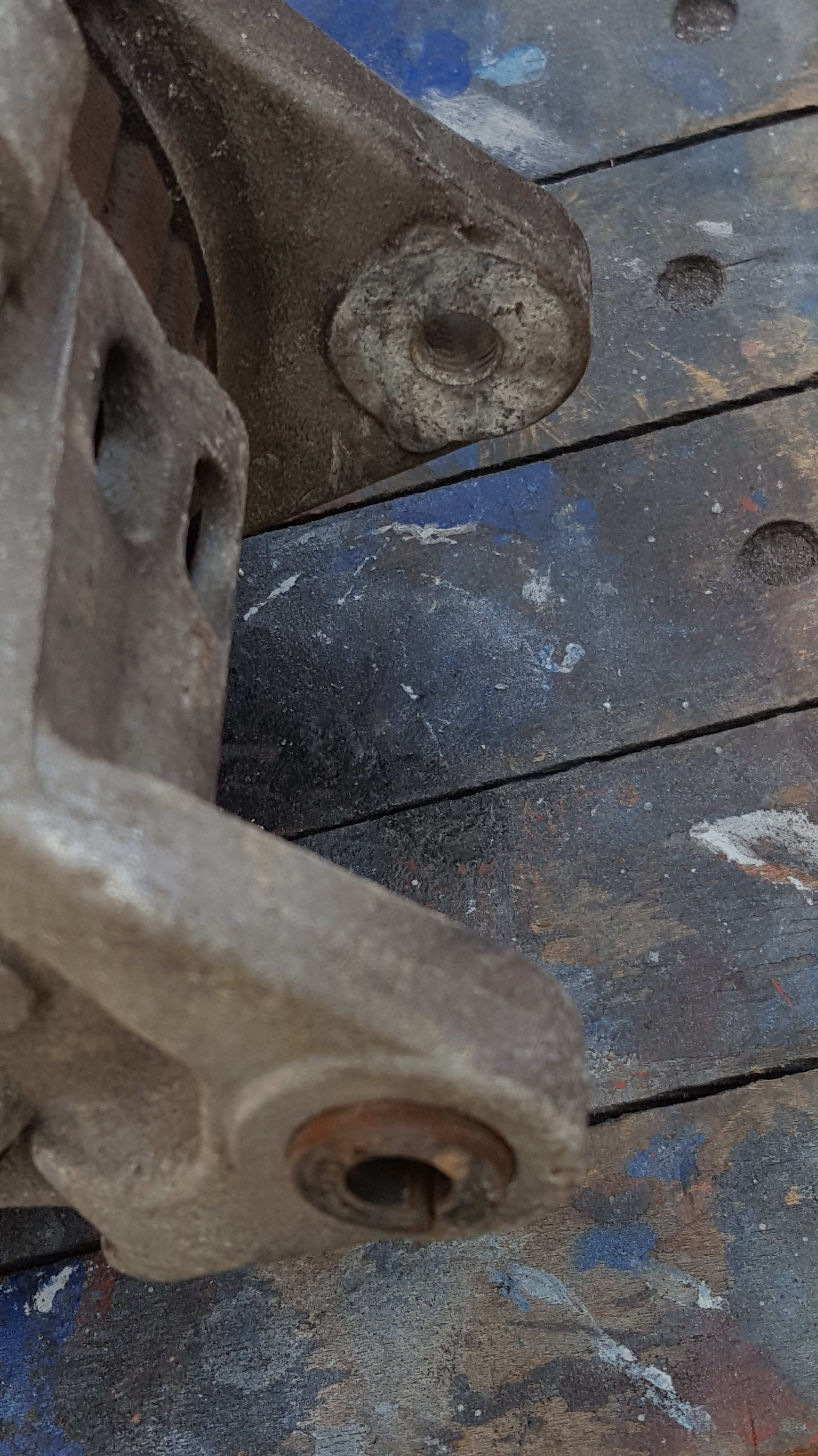

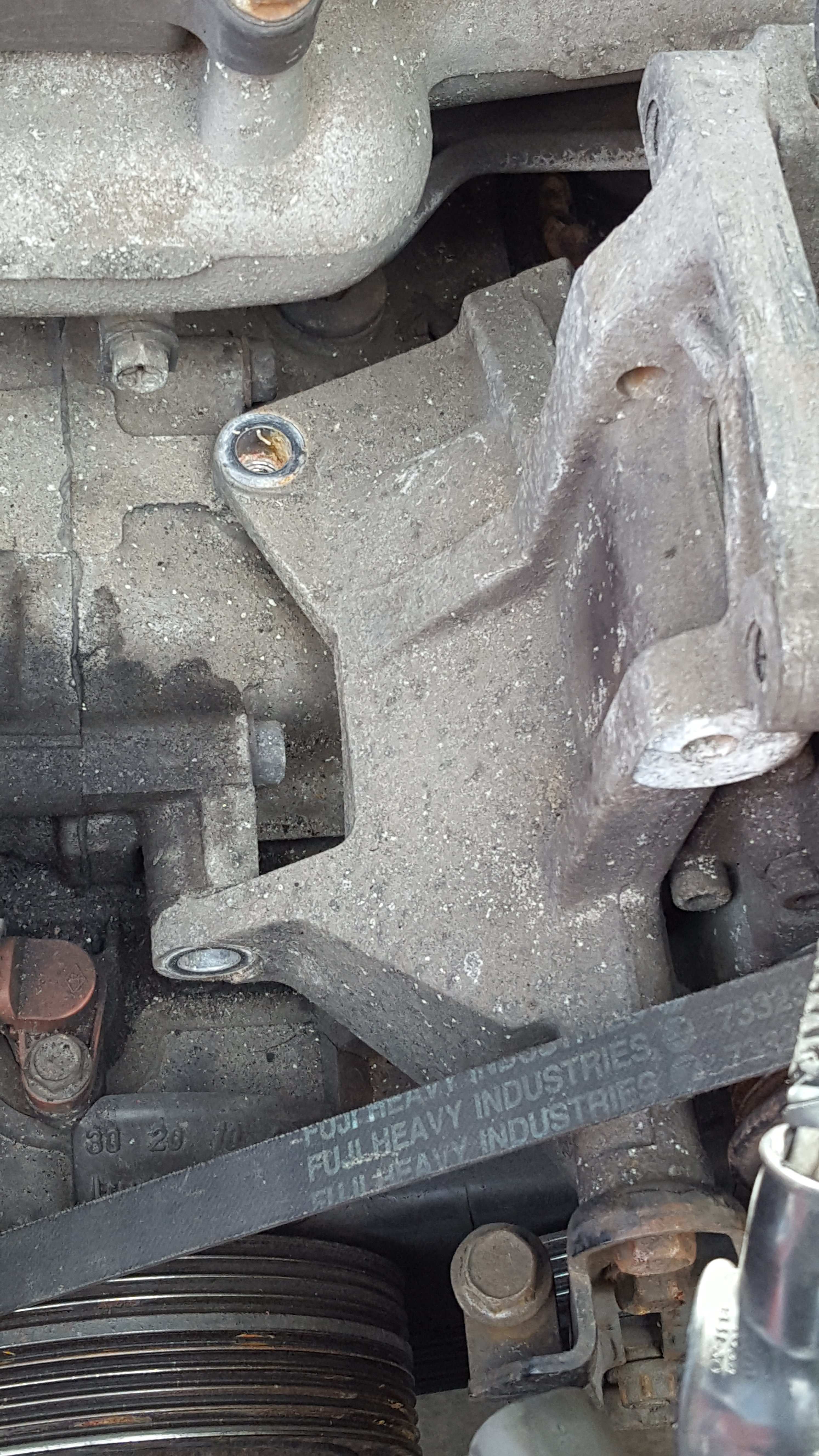

One more that so many alternators have been deemed bad. The mounting holes on the engine , bolts and brackets. Just had it happen again to another car. Cleaned them up and back to normal.
