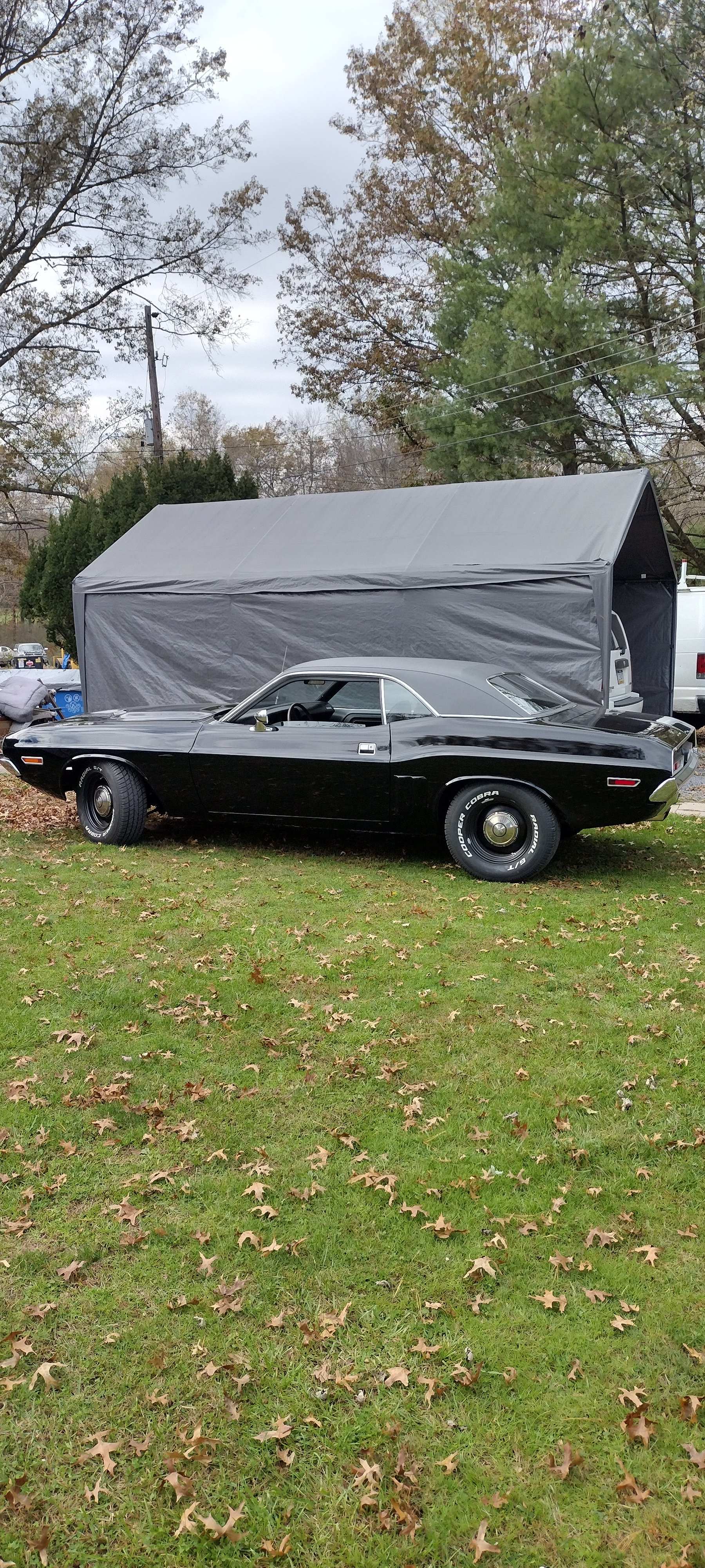

My 71 R/T 340 4 speed has been up and running since November last year and has been sitting for a few months over the winter. I went to start it the other day and the battery was dead. It was a new 1045 amp Napa one. I threw a little charge in it and it fired up.
I have a Mopar 110 amp 1 wire alternator in there with 8 gauge direct to the battery and extra ground wire to the body as suggested. Running MSD 6al 2 and it's triggered by the brown and blue wires together as required for start/ run. No issues with that as far as I know but when the battery is connected, I notice a slow voltage drop. if disconnected, no drop. No lights on, glove box etc. no stereo yet either but I do have the tach adapter.
Any ideas would be appreciated. I really don't want to put a kill switch in but leaning towards it.

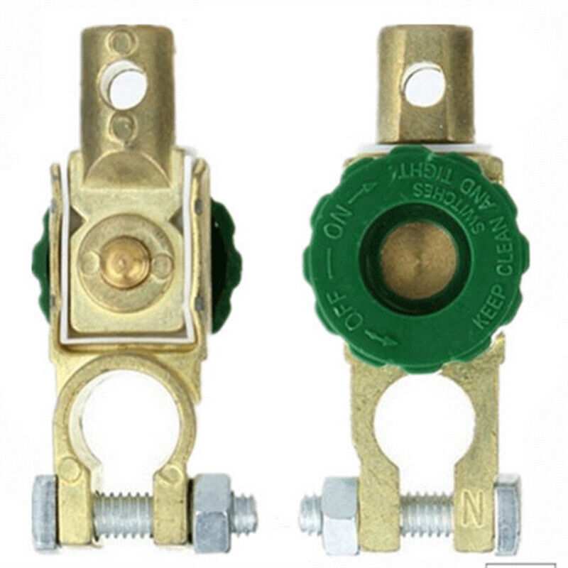

An electric clock will drain a battery over a few months time. The best way to find the drain is to disconnect the Positive post from the battery. Hook a digital amp meter (in mili-amp scale) between the cable and battery post. If you have a drain, it will show up. Then start pulling fuses until the drain goes away. That will show you which circuit is the culprit. If you still have a drain with all the fuses out, your drain is likely under the hood or a partial ground somewhere. Alternator could have a bad diode but that would normally drain the battery overnite. Diligence is your friend here. I have a factory clock in my 65 Fury that will drain the battery over time. I put a battery post disconnect in all of my collector cars for that very reason. One of these......
