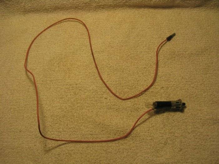

I am debugging my harness that has some non-operating lights. One of the lights not working was the glove box, even with a new bulb, while the adjoining map light was working. I wanted to check wire continuity so I tried to unplug it from the common point. Even using a set of long nose pliers and working the connector back and forth, unfortunately for me the end broke off. (Once I had the wire off the harness I did confirm the switch/light isn't the problem, it's somewhere else.)
I can't seem to find a source for the male connector on the end of the wire that I broke off. I need help sourcing it whether it is specific to Mopar or some generic connector that you experts will know of. Attached is a picture of a glove box light/switch out of a car (one for sale on ebay) that I am attaching because it shows the male "barrel" connector on the end of it that I am looking for. Just to be clear, I'm only looking for a replacement connector that I can crimp or solder on as appropriate, not the whole thing.
Offhand I don't know of a source for that original connector, but I bet it wouldn't be difficult to find one in a junkyard. I'm sure practically any early - late 70s mopar would have one or several under the dash. Something like a 75 Cordoba for example.
Otherwise I would just go to your local auto parts store, I think they're known as bullet terminals and a generic one should be easy to get.
https://www.autozone.com/miscellane...m5eaH2K-4_rcoueJHMRoCf10QAvD_BwE&gclsrc=aw.ds
Hi EV2,
Thank you for taking the time to respond. Coincidentally, I just got off the phone with RT Specialties. They didn't have it,but also recommended a generic bullet connector. Funny, when I tried to look for one at Autozone/Advanced I couldn't find it. I appreciate the link. I'll get one, solder it in, then shrink wrap it. Again, many thanks.
