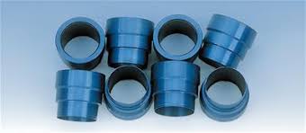

there are alum inserts that can be installed in the head that the tubes slide into that can really help
Chryco Psycho
4,896
2,521
Panama
here is a picture
tonysrt
Mar 12, 2017
628
203
If your using the standard aluminum tubes, then the milodon inserts should work. I have them on the stock cast iron heads and using the Mopar tubes. They just prevent the oil going into the cylinder when you remove the plugs and tubes. It really prevented a lot of blue smoke when removing the plugs and reinstalling them and then firing motor up.

be sure to put a light coat of oil or grease on those inner o-rings on the inserts so they dont roll out of groove when you install the spark tubes.
