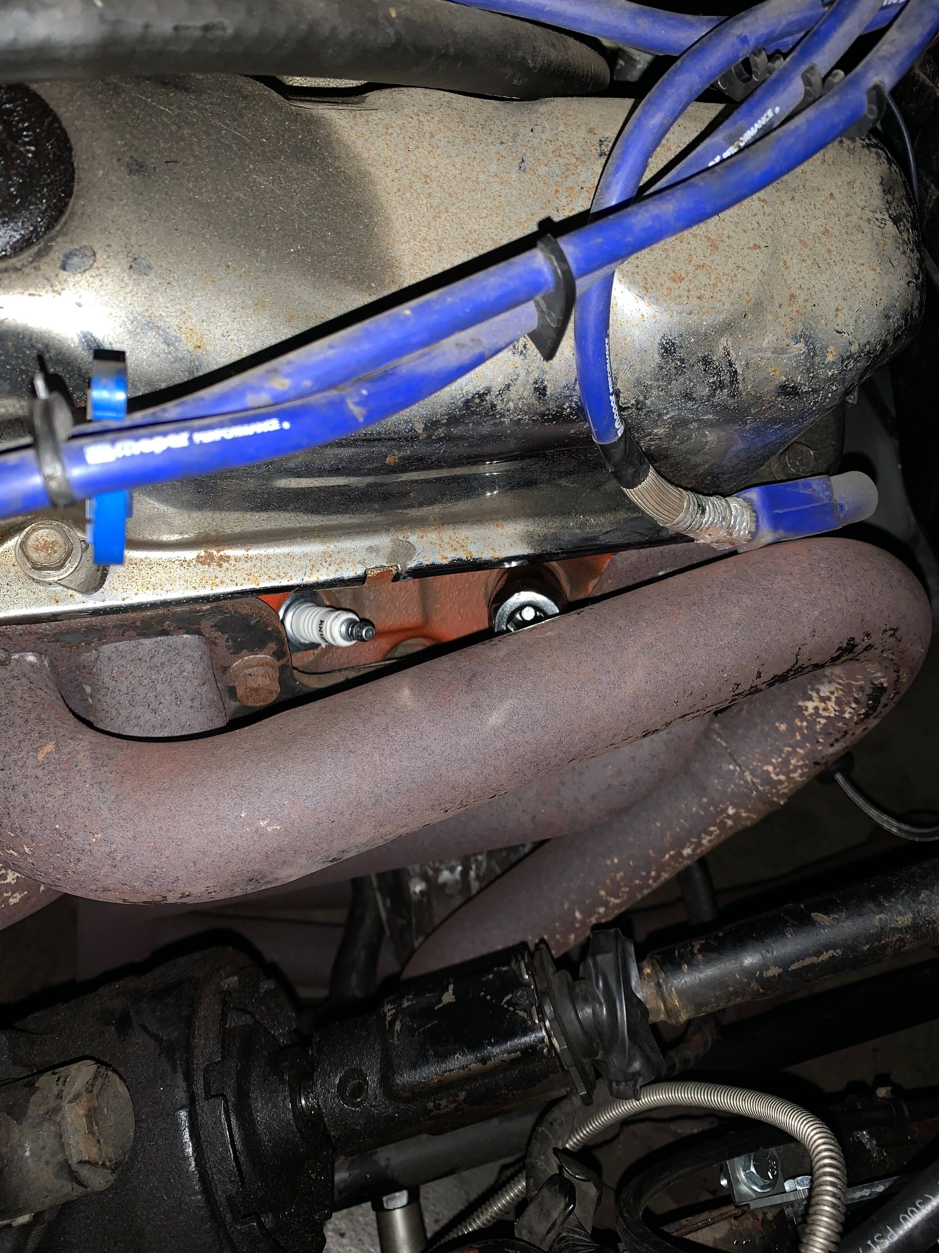

any tips for getting to the back two plugs on the driver's side, i can already see its going to test me dealing with the header.
Also, my car is a 70 challenger with a six pack on a 360 crate engine. I don't mind the muscle car cologne too much but the fuel/exhaust smell seems excessive. Maybe i'm used to my modern car but i hope new plugs may help the issue. Thoughts?

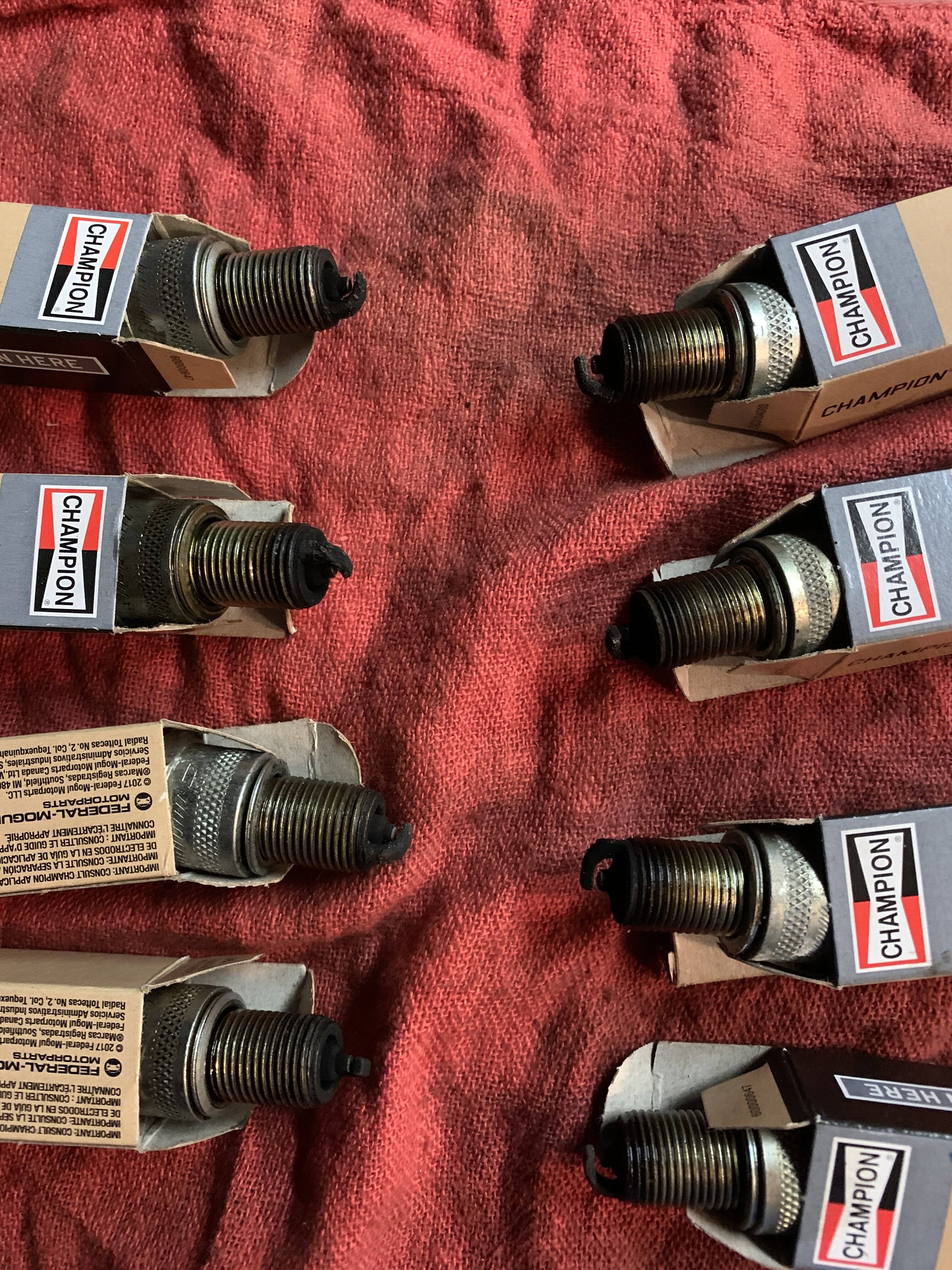

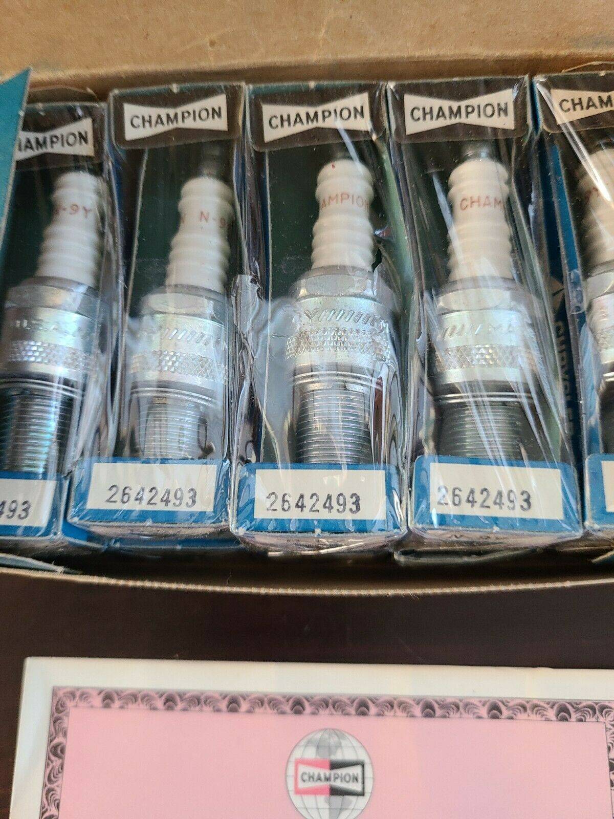

I just picked up a box set of 10 of Champion N9Y plugs with the original Chrysler part numbers. I have also been picking up original Champion N9Y plugs in pairs or separately (all on e-bay) So you can find them if you are patient. I paid an average of about $5.00 per plug.
Pic below. I have also posted a copy I have of modern replacement plugs for N9Y's:

As far as getting to the last two plugs on the driver's side; what prevents access? Headers, special brake master & booster?
Worst case scenario; I used to have a 440 6 pak where I had to remove the bolt to the motor mount and lift the engine slightly to get at plugs. Small block should be easier.

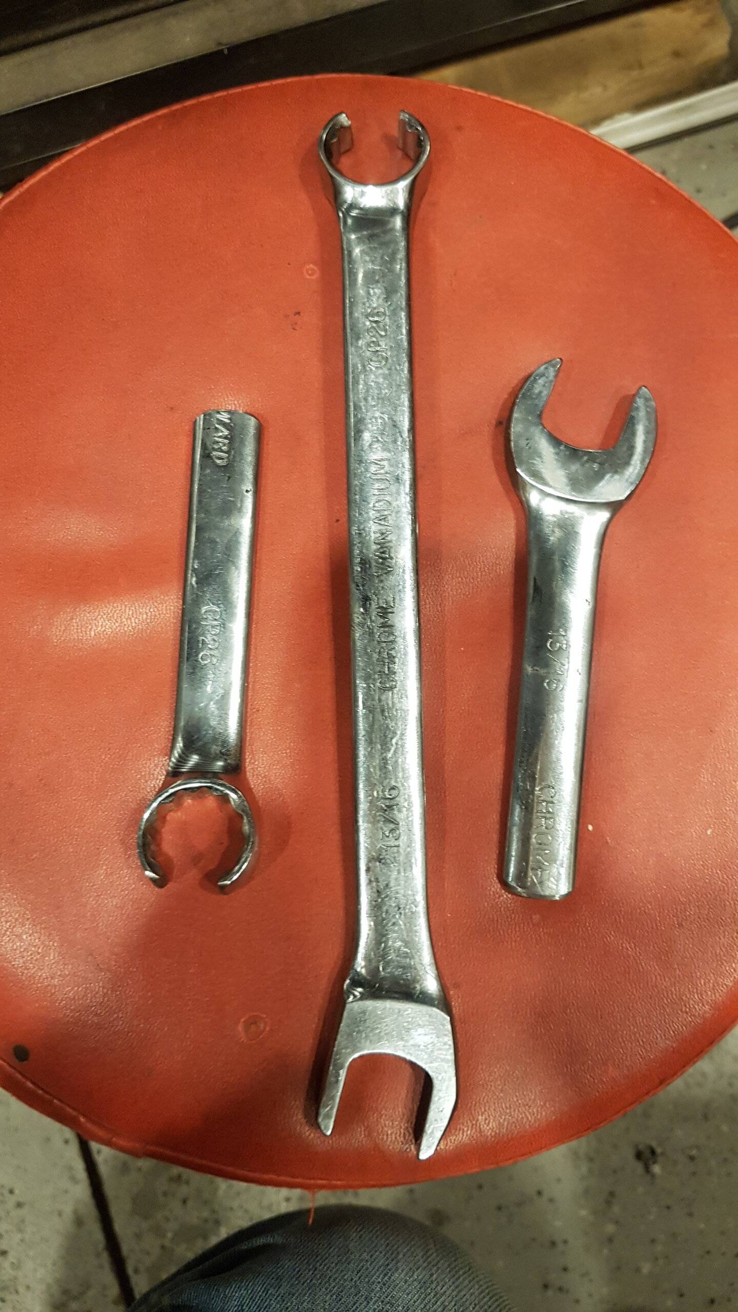

Those plugs have either been in there for awhile or they are too cold of a plug. Personally #12 heat range works for me, the #9 is too cold and fouls up easy in my 383. Anyways, I have modified 2 wenchs to help me change my plugs, maybe this would work for you, I cut a slit in the box end grinded down the open end

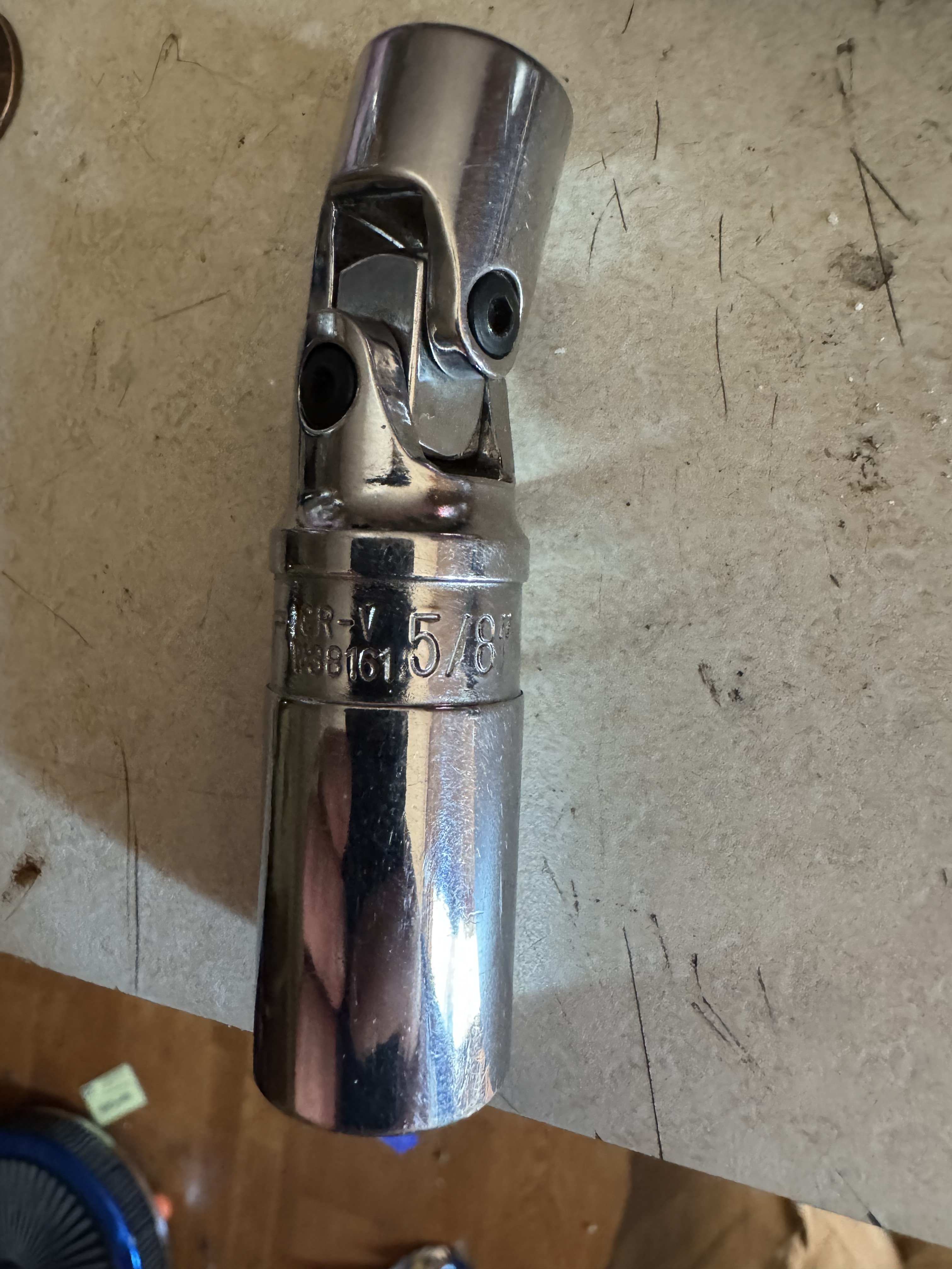

thanks for the info. I modified a 13/16 socket and made it a stubby. size matters. I still don't have enough room to torque it to spec but it'll do. on to the next thing, which there is plenty of.

yours looks the same as mine...Patriot long tube headers.... Yes, the last two plugs (#5 and #7) are a @#$%^^ to get out and replace. On mine, i first put the plugs i'm going to use into the #1 cylinder and tighten it down to about 25 ft-lbs to "precrush" the washer. Then i use the shortest plug wrench that i have, and am just able to wiggle a closed 3/4 inch wrench over the end of it, after putting a bar down into there to slightly pull the header pipe towards the fender. Then tighten it down with the wrench pointing towards the floor. Remember, you only need about 25-30 ft-lbs...that's fairly easy with a 12" wrench.
