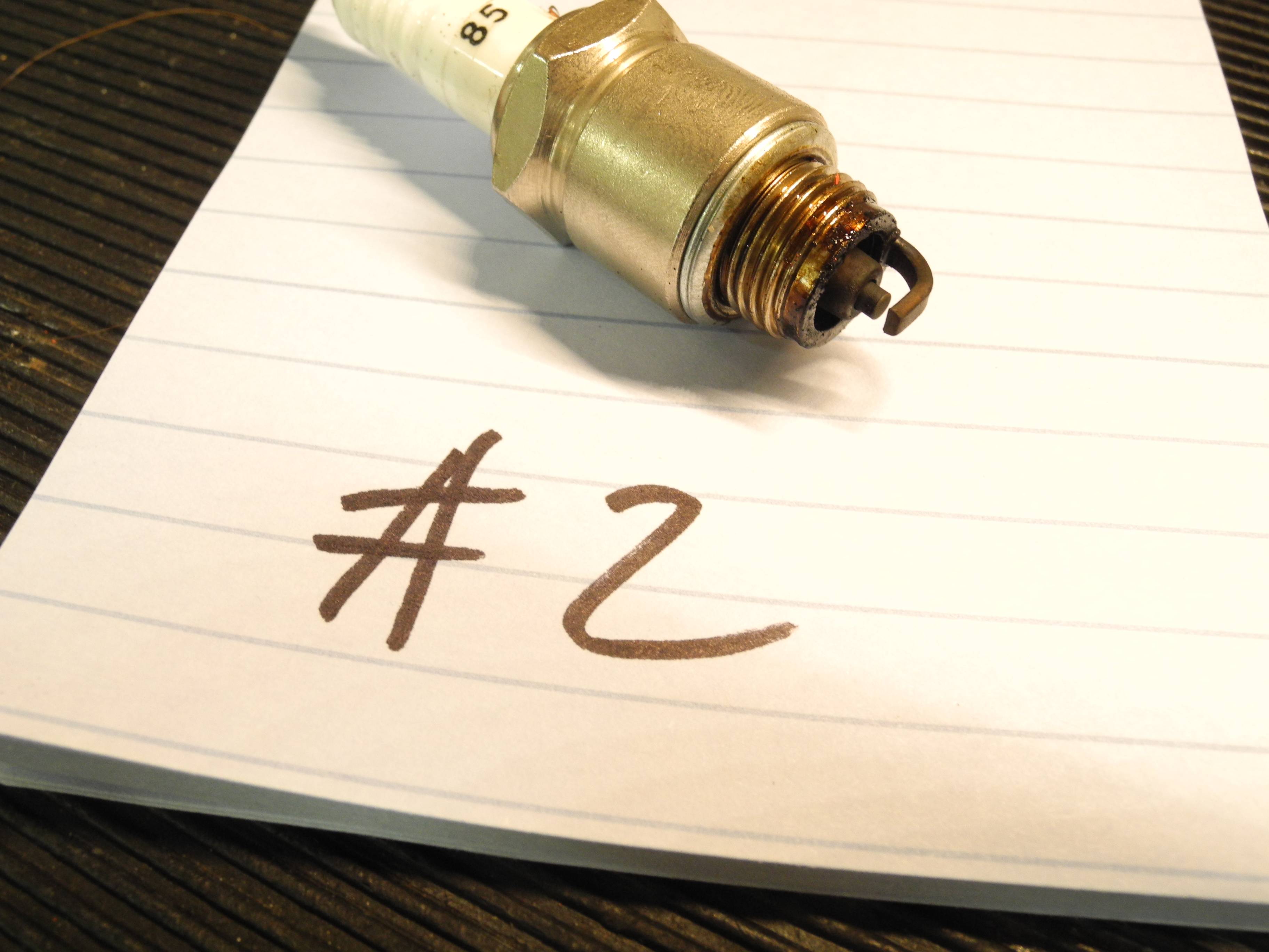

These plugs have been in the car for about a year and a half with a couple hundred miles on them. Previous plugs were worse.
71 challenger 383 stock rebuild by previous owner with 5,500 miles on the engine.
Quick fuel 650 mech carb, 4 speed car.
Doesn't smoke, no smells. Passenger side worse than drivers side. See # 2 spark plug photo and then plugs 4,6,8 a little worse. Car has alot of leaks fixing them one by one.
Any advice would be helpful.
Thanks

Based on the pic, I would say slightly rich with perhaps a little blow by (or a valve cover is leaking oil down onto the plug)
What does blow by mean ?
Thanks
Well first question is what happened just before yopu pulled the plugs , was it run for a good distance or was it just started & running with the choke on ? , plug color is best determined after running 10 -15 mins on the highway , shut it down coasting to a stop & then read the plugs .
To me they don't look bad , as above slightly rich but if the engine was just idling before the shut down it could be just a tweak of the mixture screws .
Blow by is oil so the rings may not have fully seated if it is only 5000 miles on it or you are pulling excessive fumes through the PCV especially if there is no baffle under the PCV valve in the valve cover
Got it, was cold when checked. PVC is baffled.
Will tweak the mixture screws a bit.
Thanks to all.
The short answer is to drive the car for farther distance giving the car enough time to warm up properly and self clean the plugs. Not complicated. These cars are not driven enough, they were designed to be driven 10k + miles plus per year.
