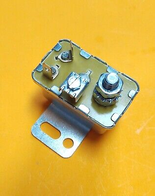

I bought a new starter relay a couple years back. Only started the car a dozen(ish) times since install. Now you have to manually wiggle one of the wires/connections to get it to start. No corrosion, the connector into the relay is loose. Are these prone to crap out frequently? I just bought a "lifetime" warranty one from O'Reillys and was wondering if anyone else had issues with theirs? Thanks in advance.

Yeah, likely foreign part with poor quality control. There are several you can find NOS from EBay. An example is this one for $25.00 (hopefully the link works):

kick that mule! Just watch it don't kick back! If you still have your old one put it on and try it. The other thing is to take it apart and see if it can be fixed, even the new one. Make sure the mounting screw is grounding it. New parts what a joke any more. Korean karnage, Japanese junk and Chinese crap!

I had the original one on my 1970 until 2015. Put a new one on that year and it is still fine. I’ve never had to wiggle wires.
