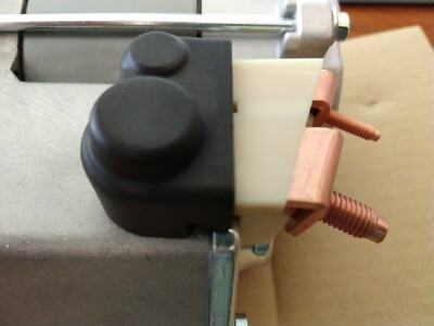

The mini starters put the terminals very close t the block , there is an extension on factory style mini starters that can be unbolted to give more clearance .
If you are using a factory cable often splitting the 2 wires where they are molded together helps a lot as you can change the angle the cable comes into the starter .
Not sure if this helps at all , do you have pictures ?
