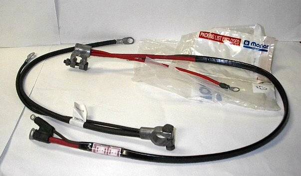

Also recheck all of your connections in the starting circuit. A lot of things get painted when restored. You need good grounds as well as positive connections. Remove each wire from the battery to the starter and make sure you have bare metal contacts. Run a ground from the block to the firewall or fender apron. As burdar says, make sure the timing is not too far advanced. Unless you bought your cables from the 99 cent store, they should be fine as long as they were recommended for the car. The positive cable is a Mopar fitment only as the cable has 3 leads. 2 to the starter and one to the relay. 7074440cable.jpg
