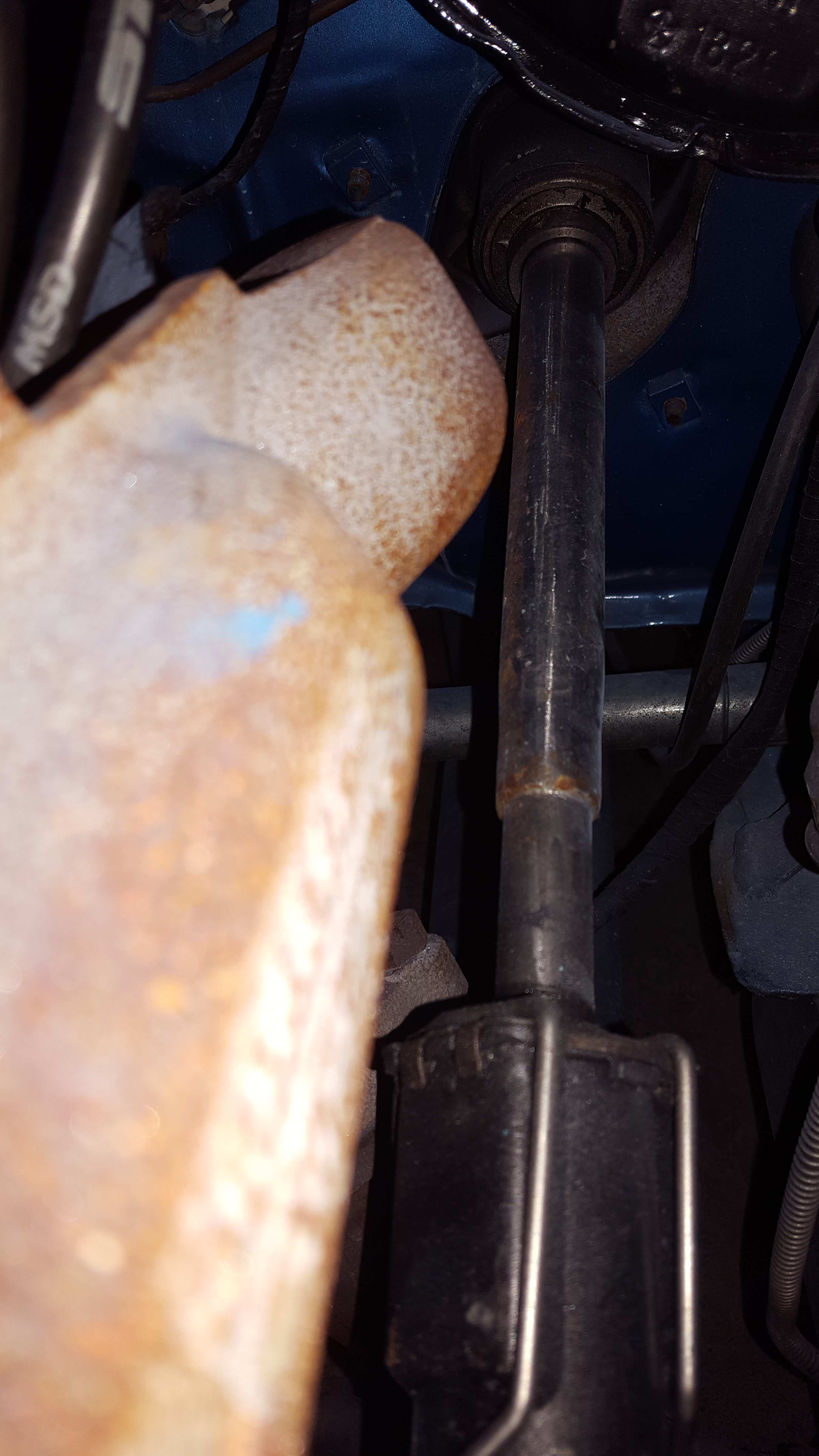

Just want to point out. The sliding portion is up inside the column. At first glance. The picture I posted my be the colpert of confusion. The shaft is flipped compared to the tube.
You are correct, but the OP's shaft definitely has another tube slipped over the original sliding portion and welded into place. You can see it in his picture in post #3. It doesn't appear to be over the sliding part of the shaft, but who knows what kind of shenanigans are going on with that shaft up inside where we can't see. I wouldn't be surprised if the sliding joint was also welded.

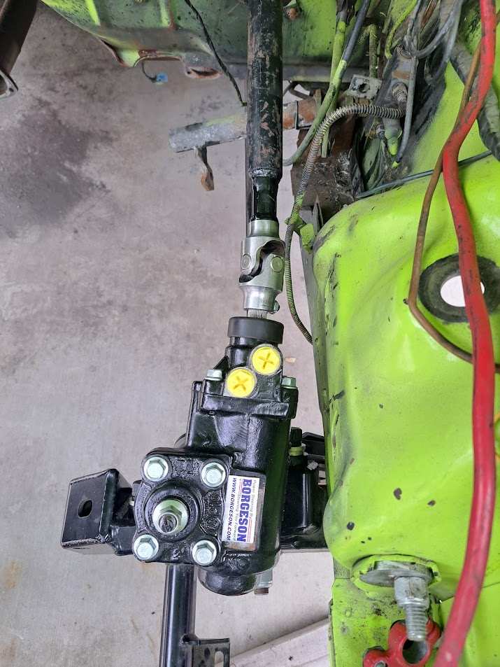

Thank you all for your help. I am now moving along again. (Looks almost as nice as Ron's LOL).
