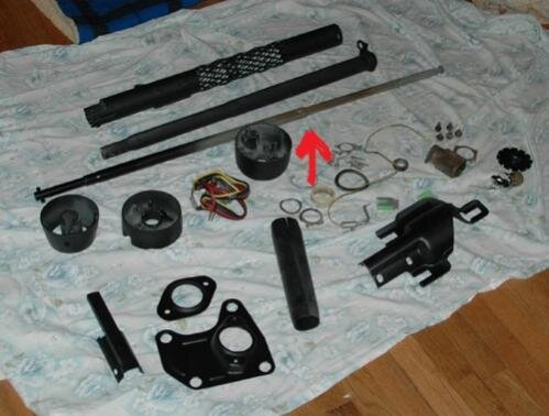

Other than a steering wheel puller no special tools are needed... steering-column-parts 1.jpg
And there are Mopar column rebuild articles online.. I found this picture on a Charger 500 page (thanks guys!) so the parts may appear different from yours.
