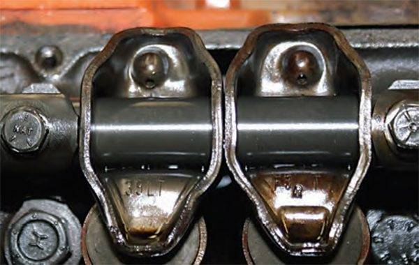

Here is a good picture of the factory 340 stamped steel rocker arms showing the left and right pushrod "dimples" or "cups".
Where are your pushrods rubbing in the pushrod tunnel through the head? On the sides of the pushrod tunnel?
yes on the sides, Thank you for this pic, I have gone down to my Dyno guy and mentioned this left/right rocker set up. Thanks man for your help...much appreciated all you guys have helped out, thanks all!

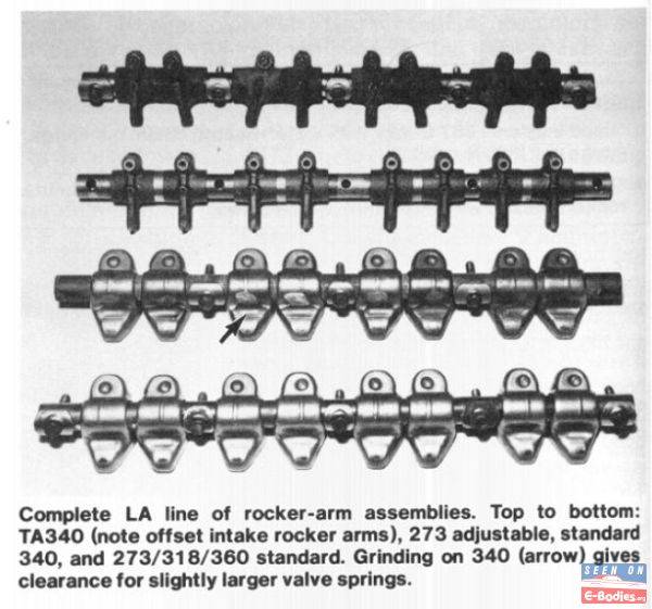

Here are the diagrams.
This diagram shows the rocker arm shaft holddown bolts. Each bolt has a retainer under it. The ends and center bolt get the narrow holddown retainers (location 1, 3, & 5). The wider retainers are at locations 2 & 4.
Narrow end retainer with notch at bottom of shaft and the retainers with bolts.

Much appreciated! Thanks for the diagrams...
