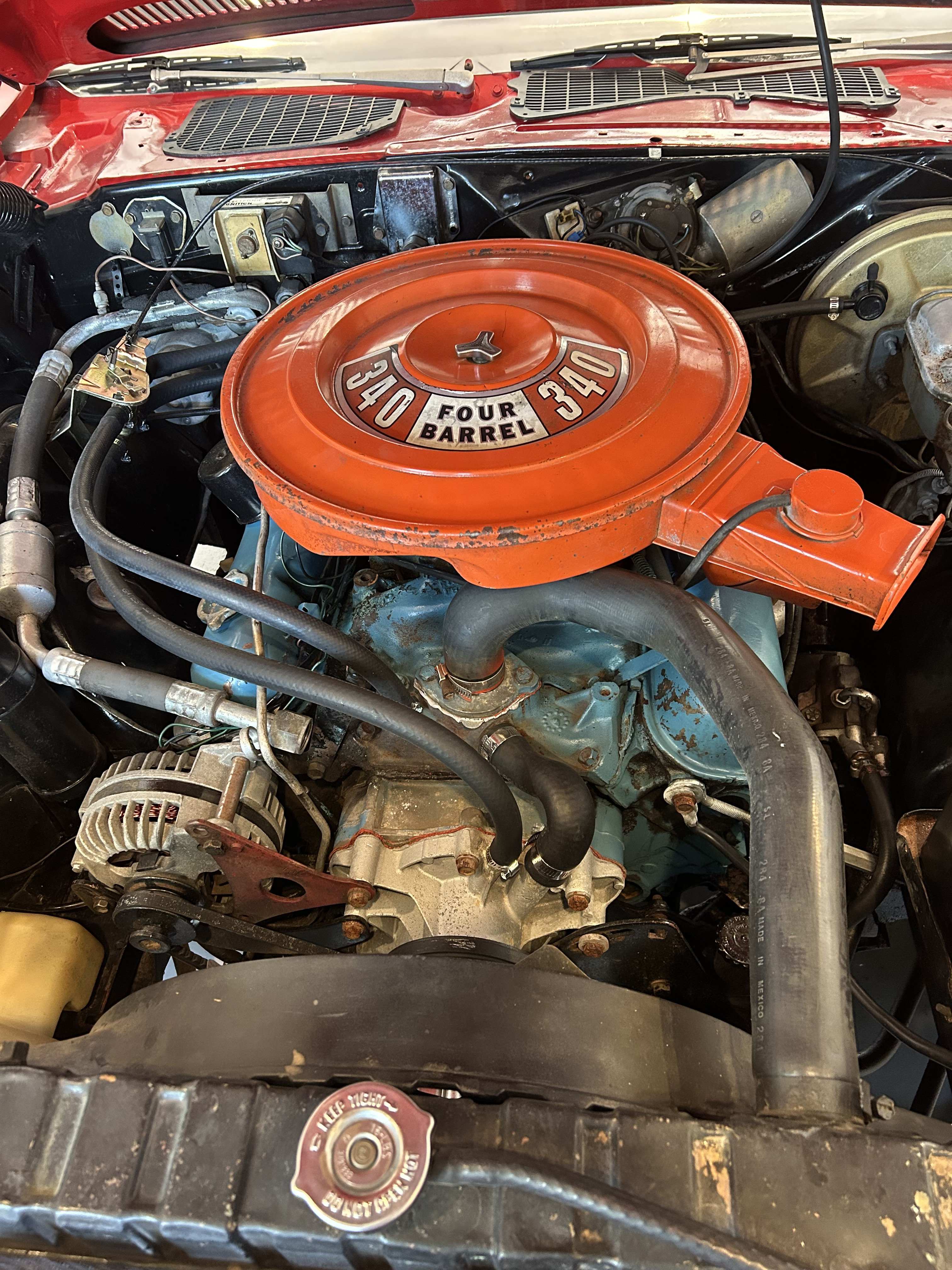

If the rhythm is more or less constant, and goes away a while after starting, I'm thinking something related to the choke, and/or carb heat system. A picture of your engine would answer some questions about which air cleaner, and your engine setup.
As requested....the noise is mainly aural, but I can maybe feel a little bit in the car except the couple of times in stumbled, almost like it is running out of fuel. I have had the car about four months and have driven it weekly, at least. The last two times are when I've had the issue....

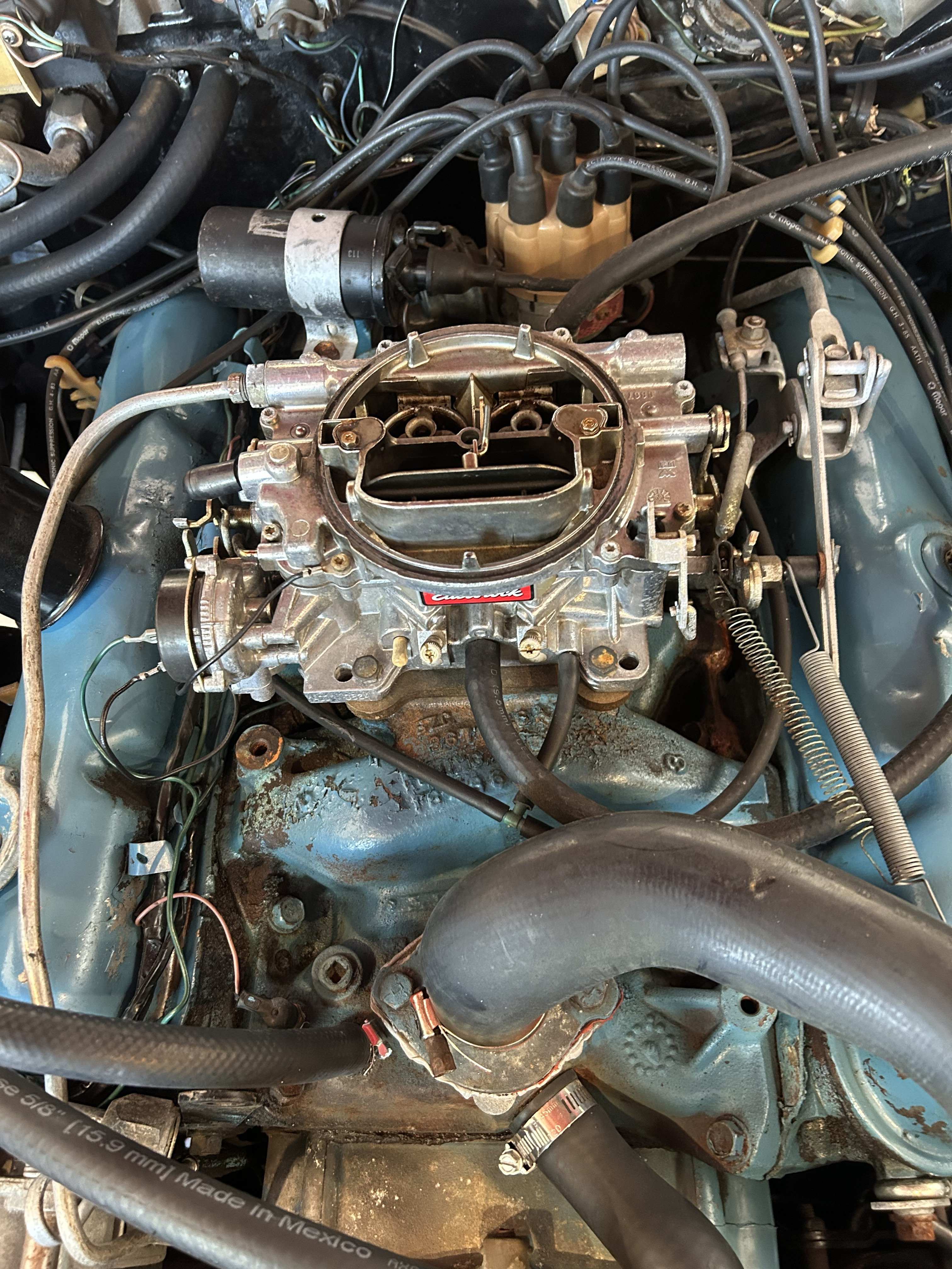

Thanks for sharing the images of your engine.

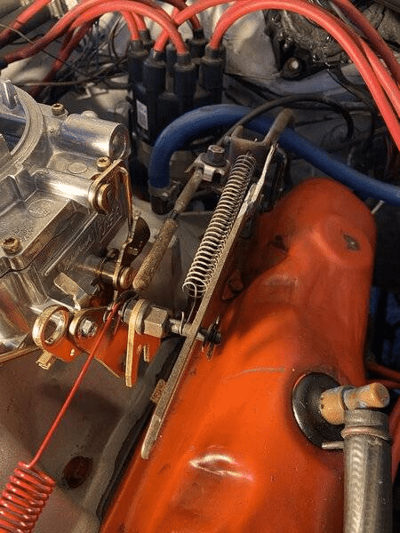

My next two comments are NOT related to your problem. But I see a couple things you may want to add to your TODO list to improve. Refer to the image.
You want a throttle cable bracket that positions the cable so it is more inline to the attachment point on the throttle lever at the carburetor. See how yours has to bend to make the connection point? I think this can prematurely wear your throttle cable and cause failure. If possible, you can try using a different connection point to bring it more inline with the cable hold-down.
Also, you seem to be missing the Transmission Rod Return Spring. This spring returns the throttle pressure when you let off on the gas. This is helpful when going from WOT (wide open throttle) back to idle or partial throttle. Maybe you simply need to re-task and move that second one piggy-backed onto the throttle return spring.
Awesome information....i actually didn't notice this....Probably why the kick-down felt weird. The situation has been corrected.
I notice you are running an Edelbrock as well. Did you have to get an adapter to get the cable straight? All of the other linkage brackets is original, I just need something to move the cable over until I can get the stock Thermoquad rebuilt.
