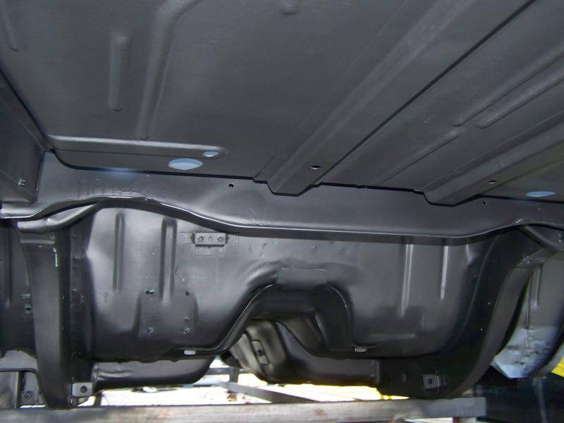

Got it home

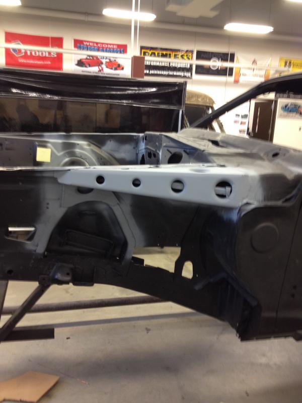

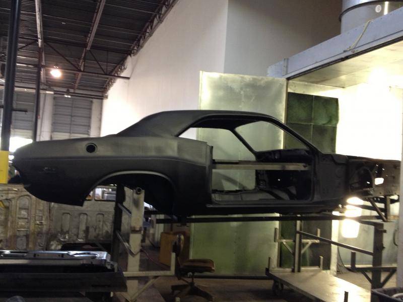

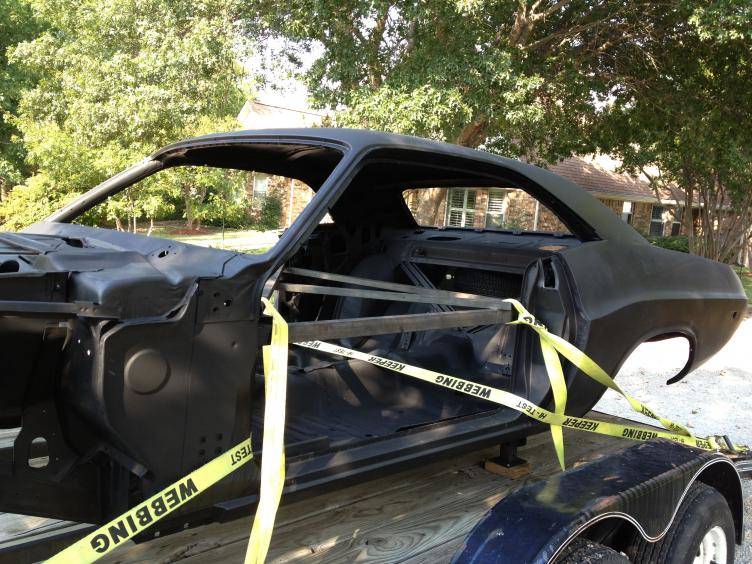

IMG_2979.jpgIMG_2920.jpg US Car Tool Part Number USCT1M1002. Got the car picked up and I am really happy with the cleanliness and prime job that was done. Anxious to get it to the school where I am doing the work. A local community college has a custom auto class where you are able to,when room permits, take your project car in and work on it for the semester. Most of the guys in my class are in their 60's to 70's. We do have a younger woman that is in the afternoon class who is working on her second car to restore. A VW 4 seater pickup. Hopefully the pics of my car above will come out!

Community colleges are an excellent source for working on your car where space is limited and you can learn from others in the class. I use to use the High School summer night school course to do my heavy work in. The school had a fully equipped Snap-on tool crib, Sun diagnostic and distributor machine for setting advance curves. Valve grinding equipment, welding equipment, hot tank tec... and a very knowledgeable instructor. Can't beat it.

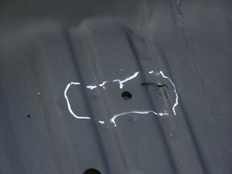

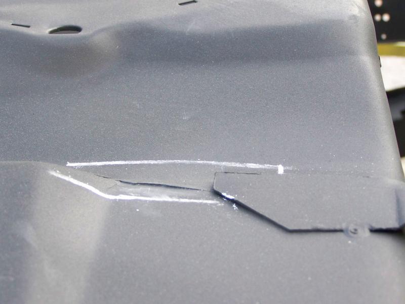

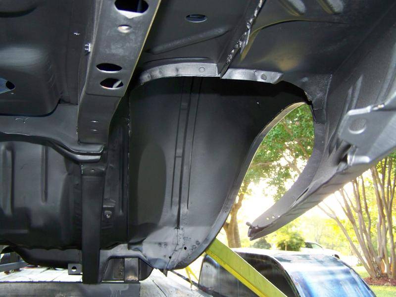

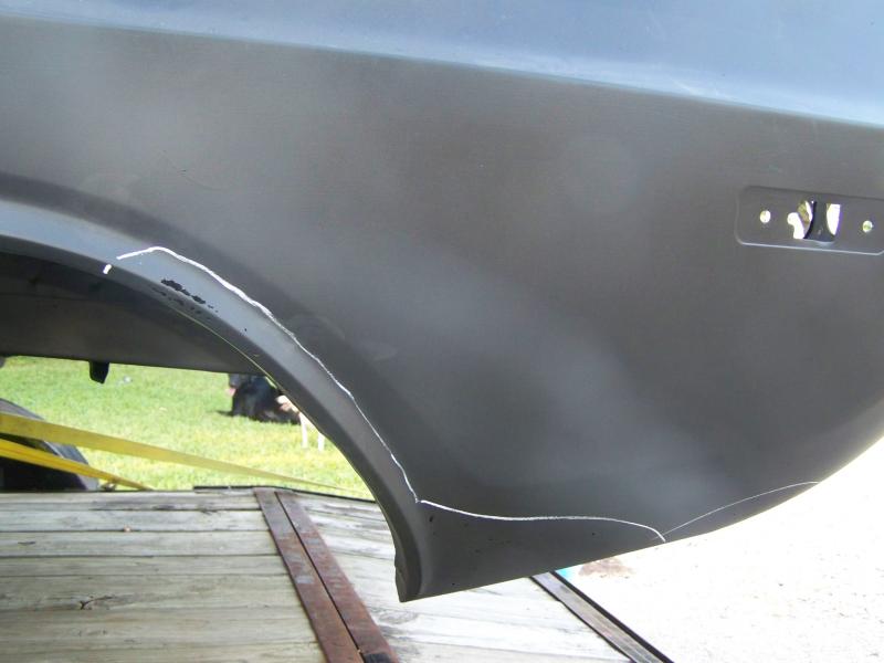

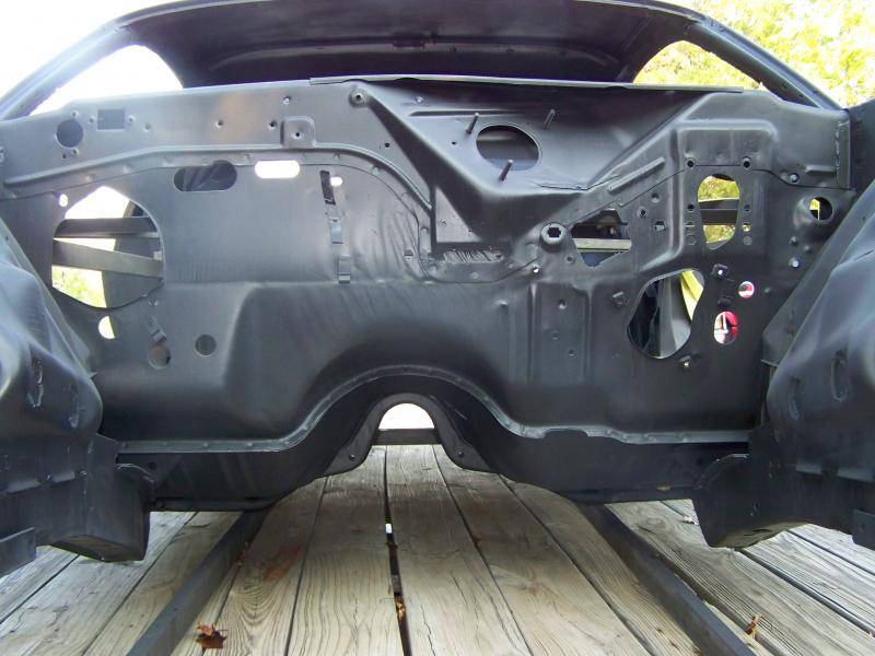

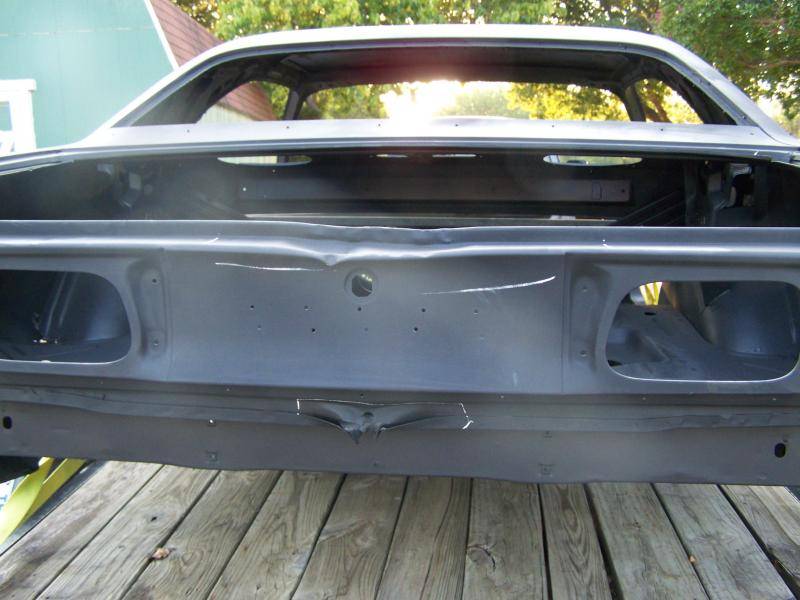

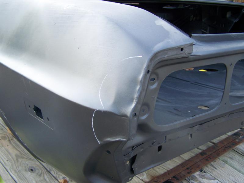

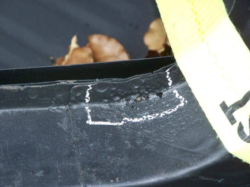

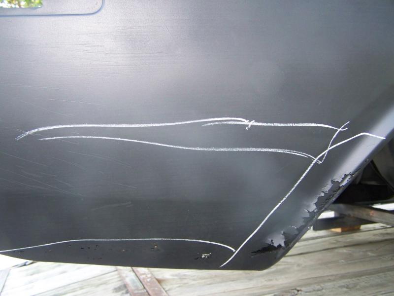

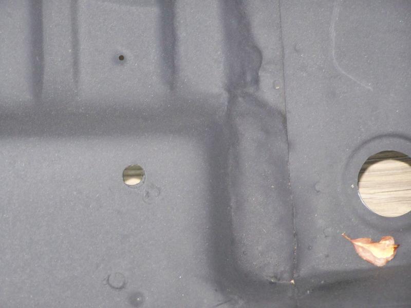

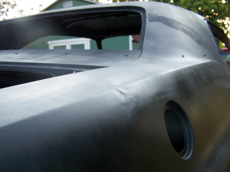

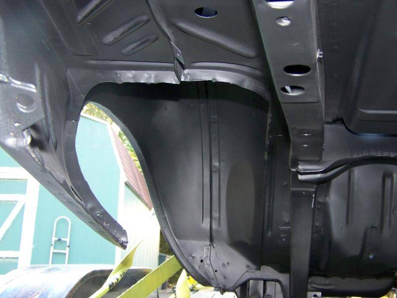

No Ramenth I am in Dallas TX. Did you get a chance to look at the US Car Tool sight? I have been going over the car marking areas that need to be addressed with white chalk and taking lots of pics for the scrap book. Have found quite a lot of surprizes but most are pinhole stuff. The rear lower quarters are going to need work and the drivers front floor. Is AMD one of our sponsors. I will post a couple of pics and load up my album.

That's the nice thing about having the car stripped and primed. Get to see all those areas really stand out. Looks like a nice project to deal with. I'm from upstate NY. We find a car with that little rust and we're dancing a jig.

I'm not unhappy at all just surprized at what was lurking under one layer of paint. The car came out of Abilene. I am thinking it was found in a junk yard there. Three of the four corners is smashed and the only explanation for the tail panel to me is a big hook.

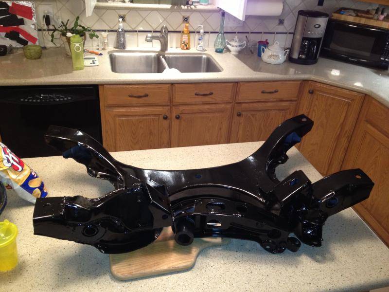

Wow! I cant believe it has taken a year to get this far. I went with Firm Feel for their Kmember kit (alot of welding), LCA kit, and UCA's. Did all the welding myself (TIG) so there was a learning curve involved. Once that was done I ordered US Car Tools Kit for frame connectors, fender braces, torque boxes, and core support (alot more welding). Still have the core support to do. Than body panels!
