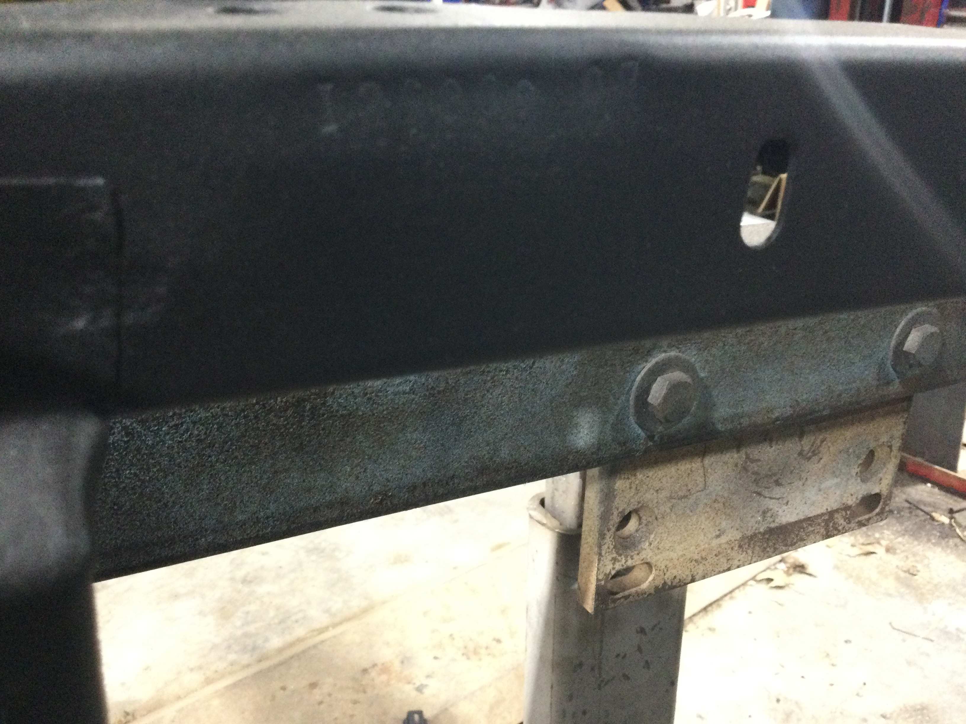

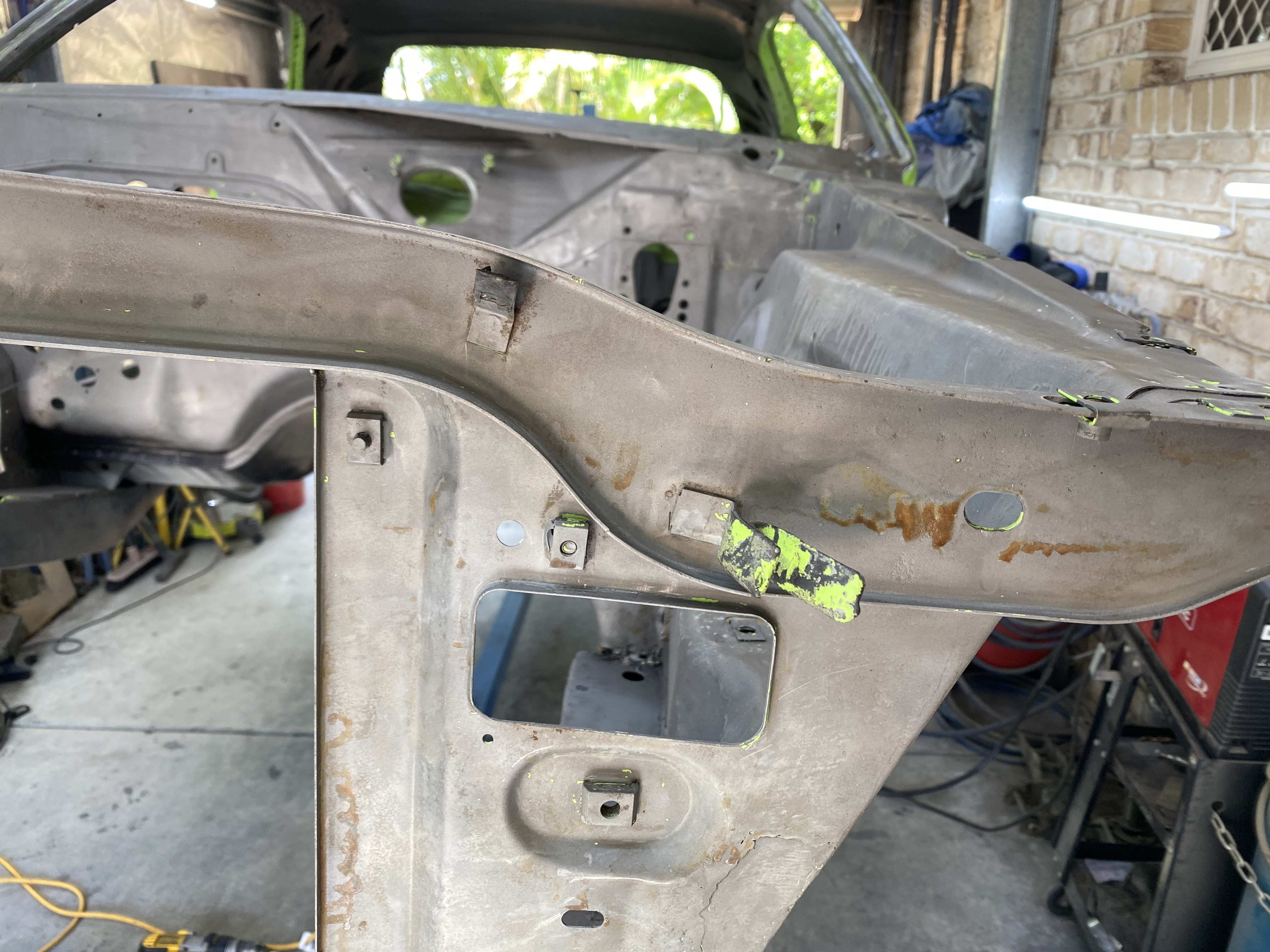

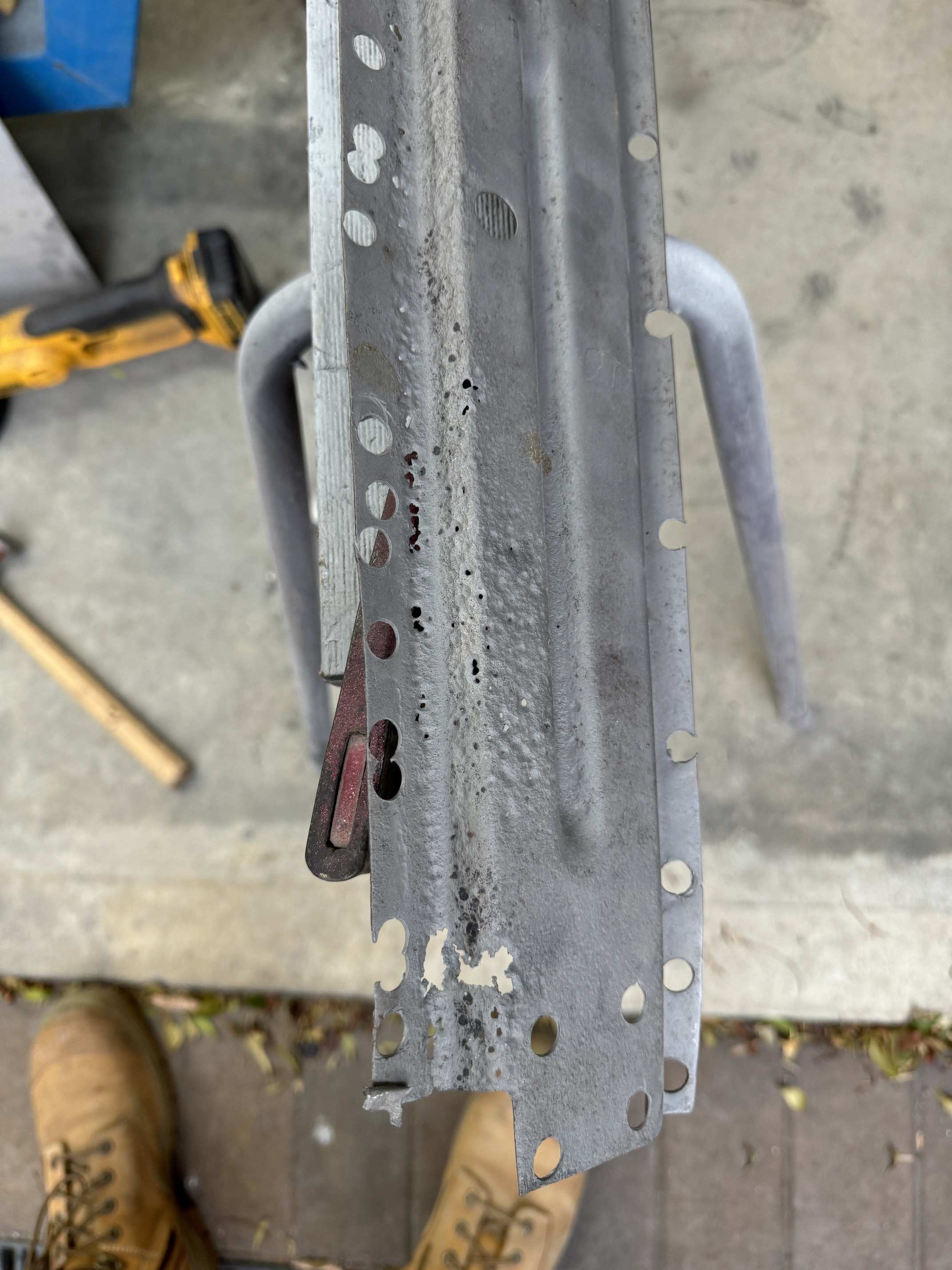

I've been over every inch of the top radiator support, the only stamping is on the passenger side, what I assume to be the support stamp number - "OD 35 1".
All the spot welds appear to be original to my eye, so I'm still stumped as to the front partial VIN. Is it possible it was missed on the assembly line?
Pics of the bare metal radiator support if anyone can enlighten me. The underside of it has no markings on it what so ever.
Here is what mine looks like, it’s actually upside down.

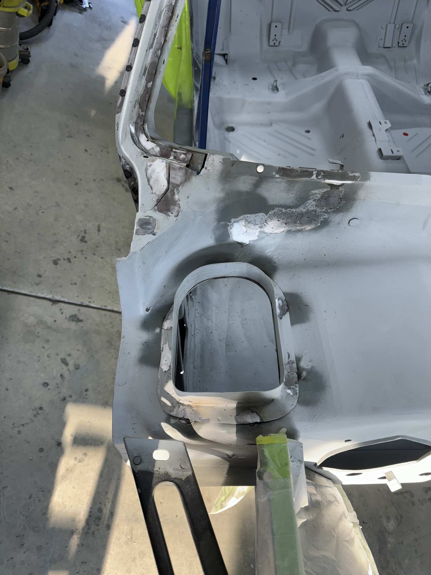

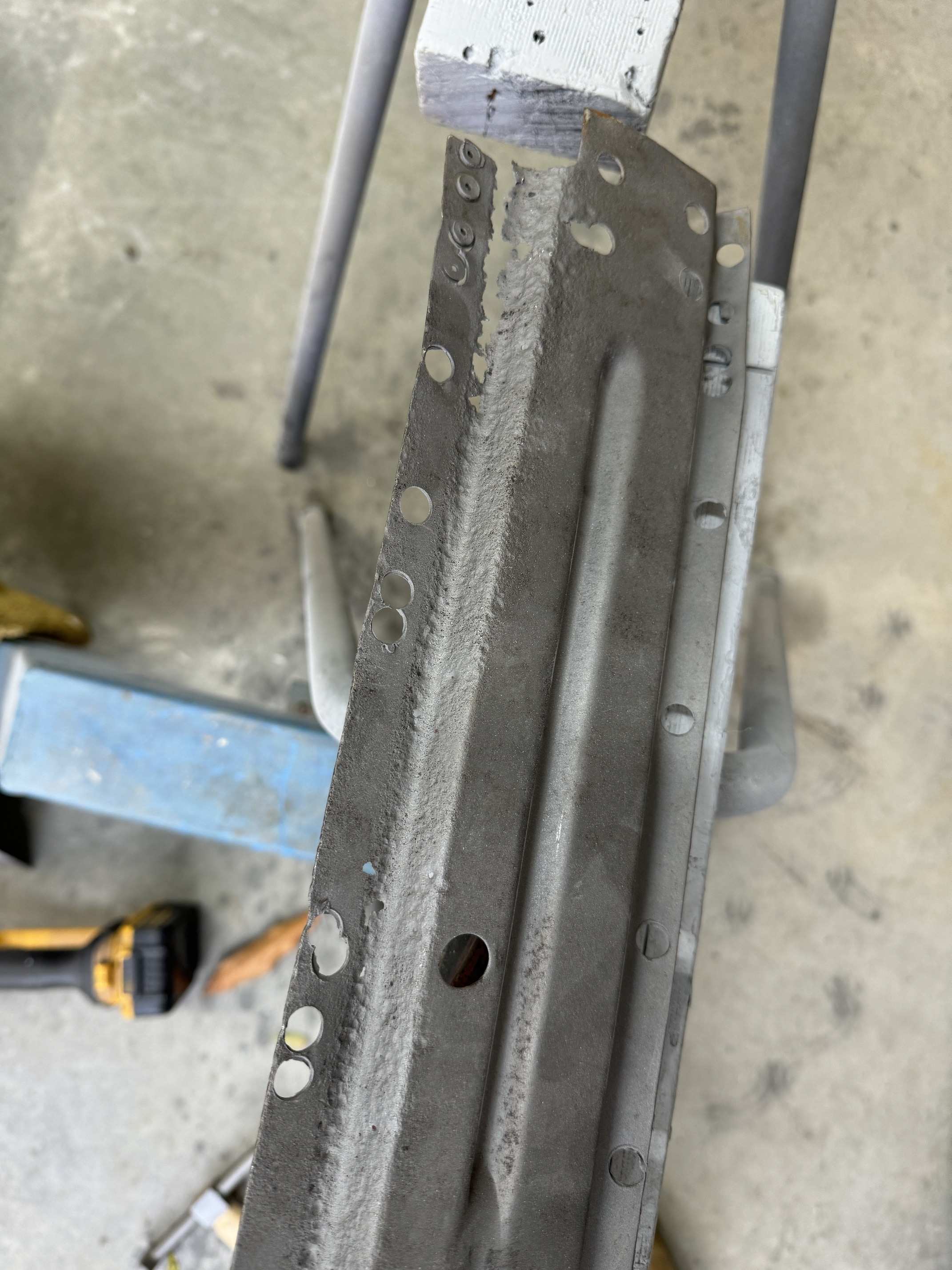

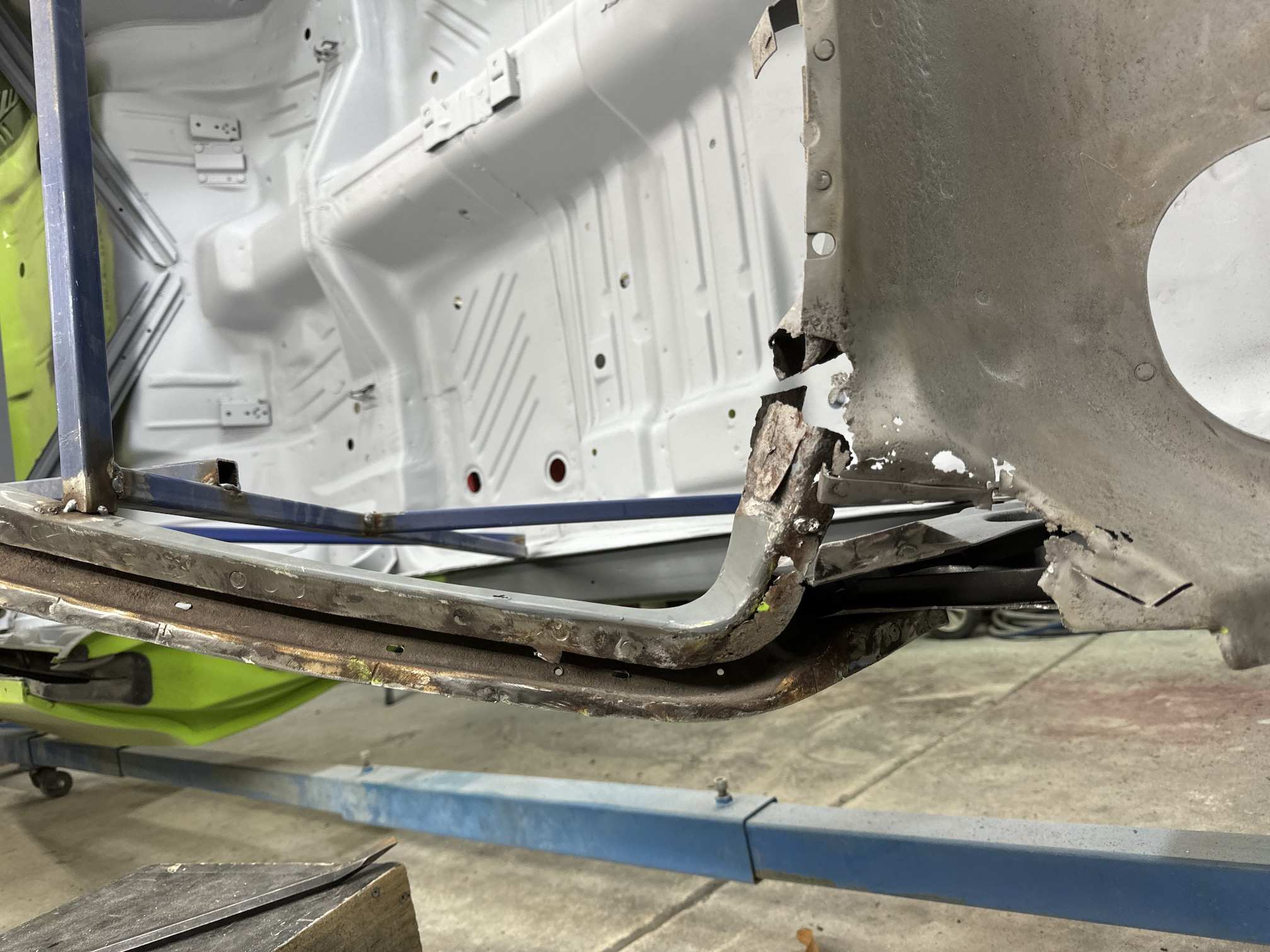

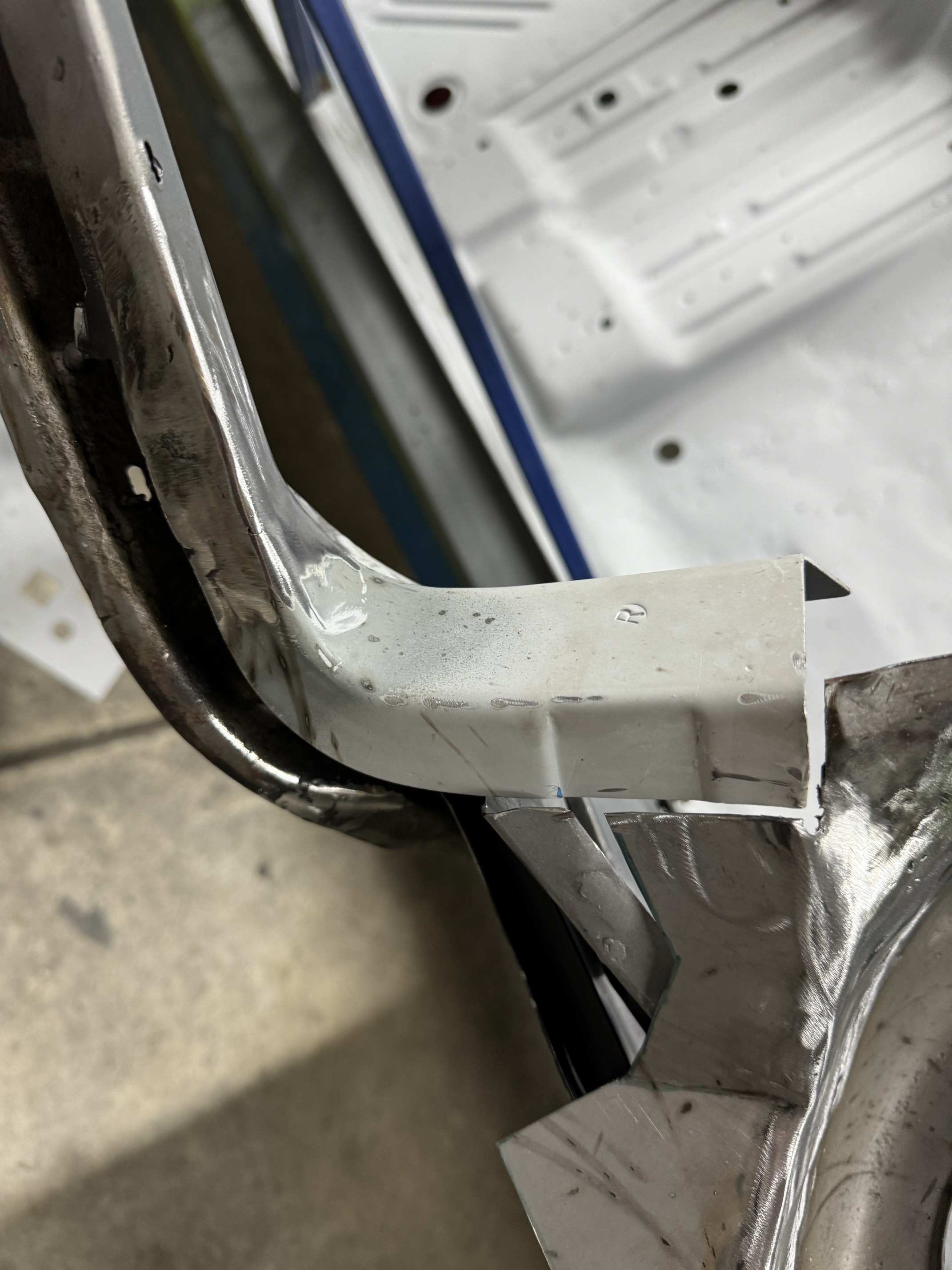

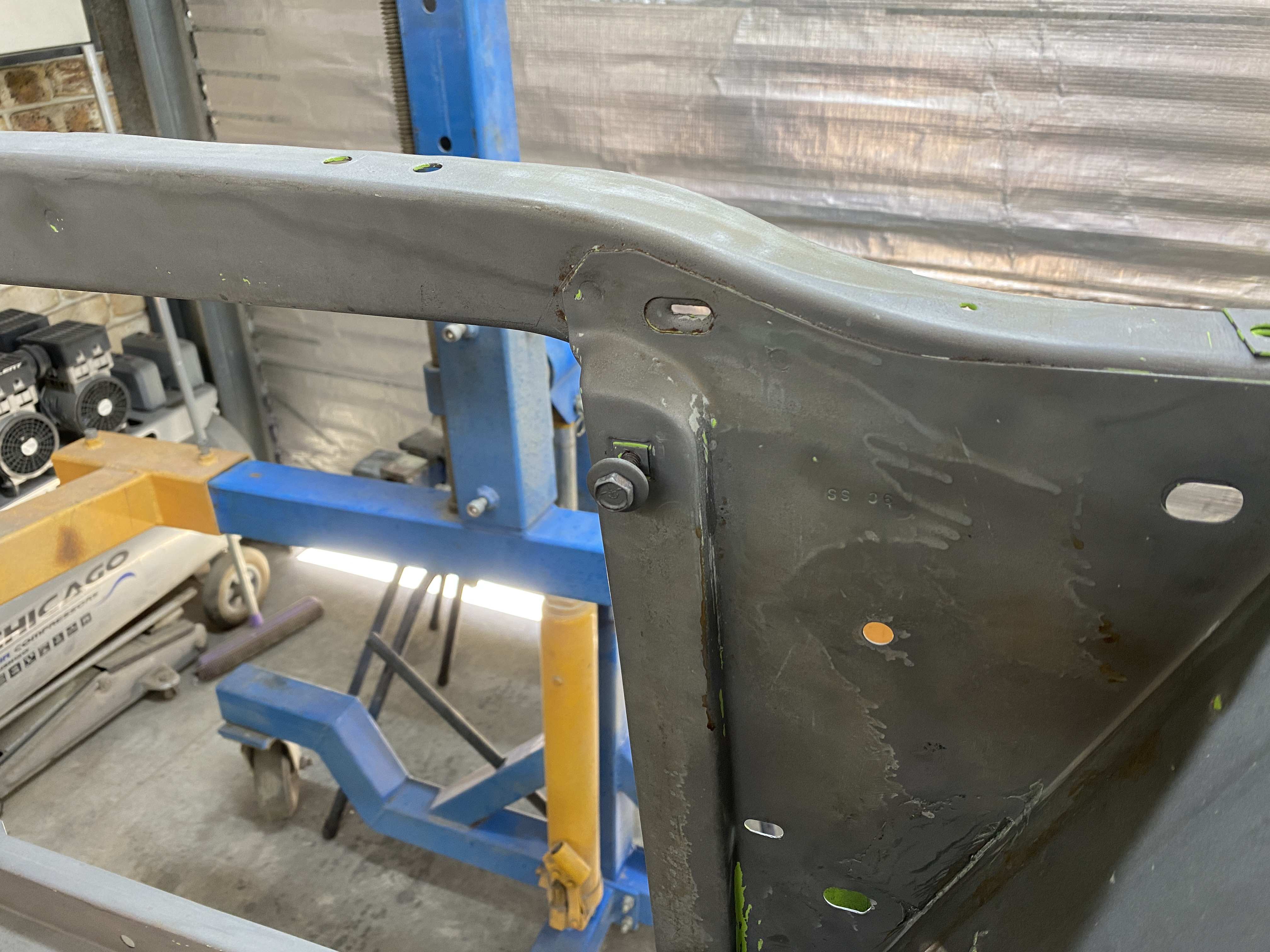

Started tackling the passenger side. I've cleaned it up and replaced the lower corner of the A-pillar/windscreen. Also cut out and replaced the last rusted part of the plenum chamber. My TIG skills are getting less embarrassing now at least. I've found that if I tack in place with the mig, then TIG between I end up with a half decent result. The MIG tacks let me tackle the TIG part with a little less stress. I've found that if I'm trying to use the TIG to tack as well, at this stage that's a bridge too far.
Next step is to clean everything up again, seal with etch and epoxy primer. Then weld on the outer A-pillar piece. Then onto the cowl ...

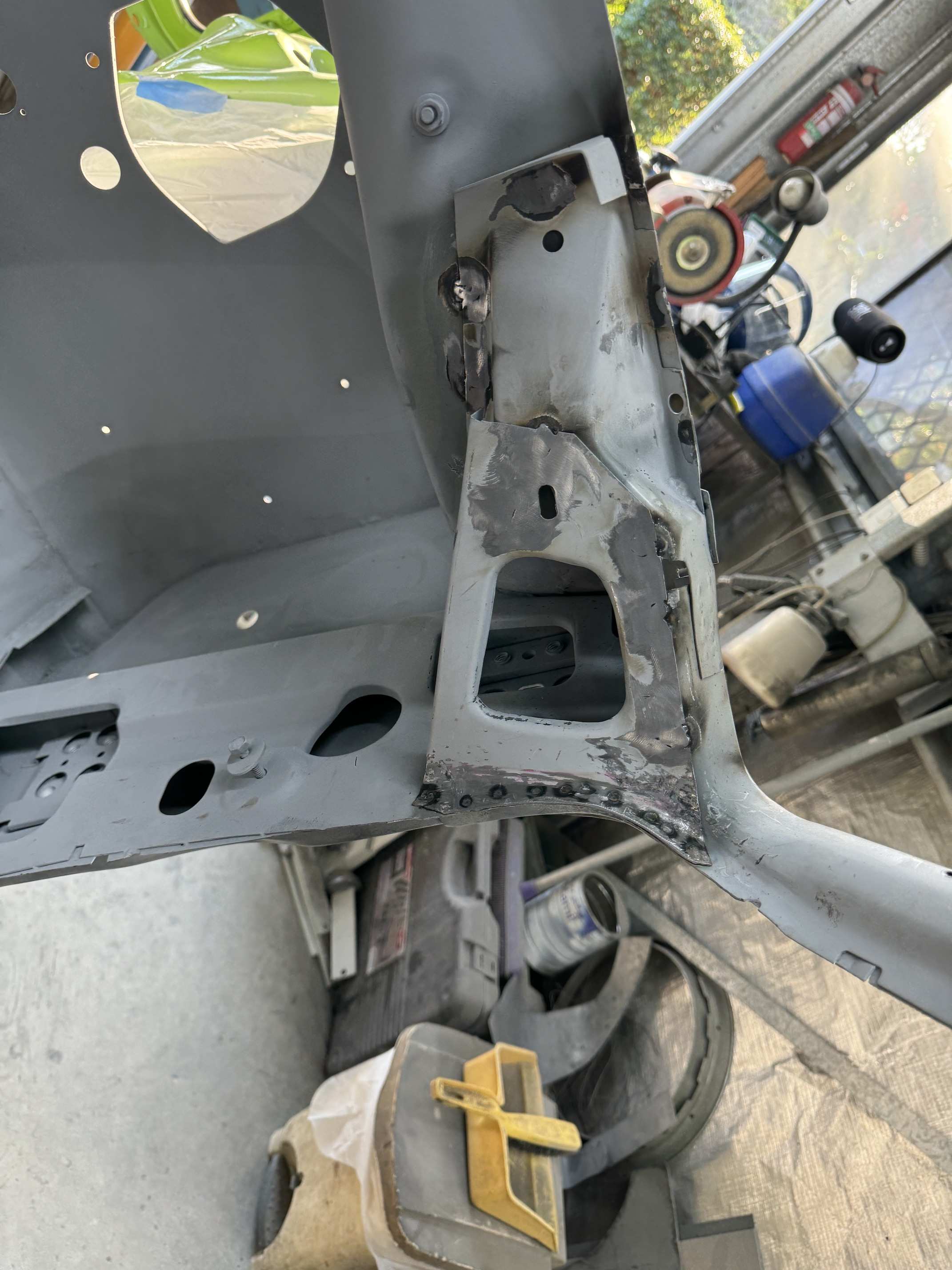

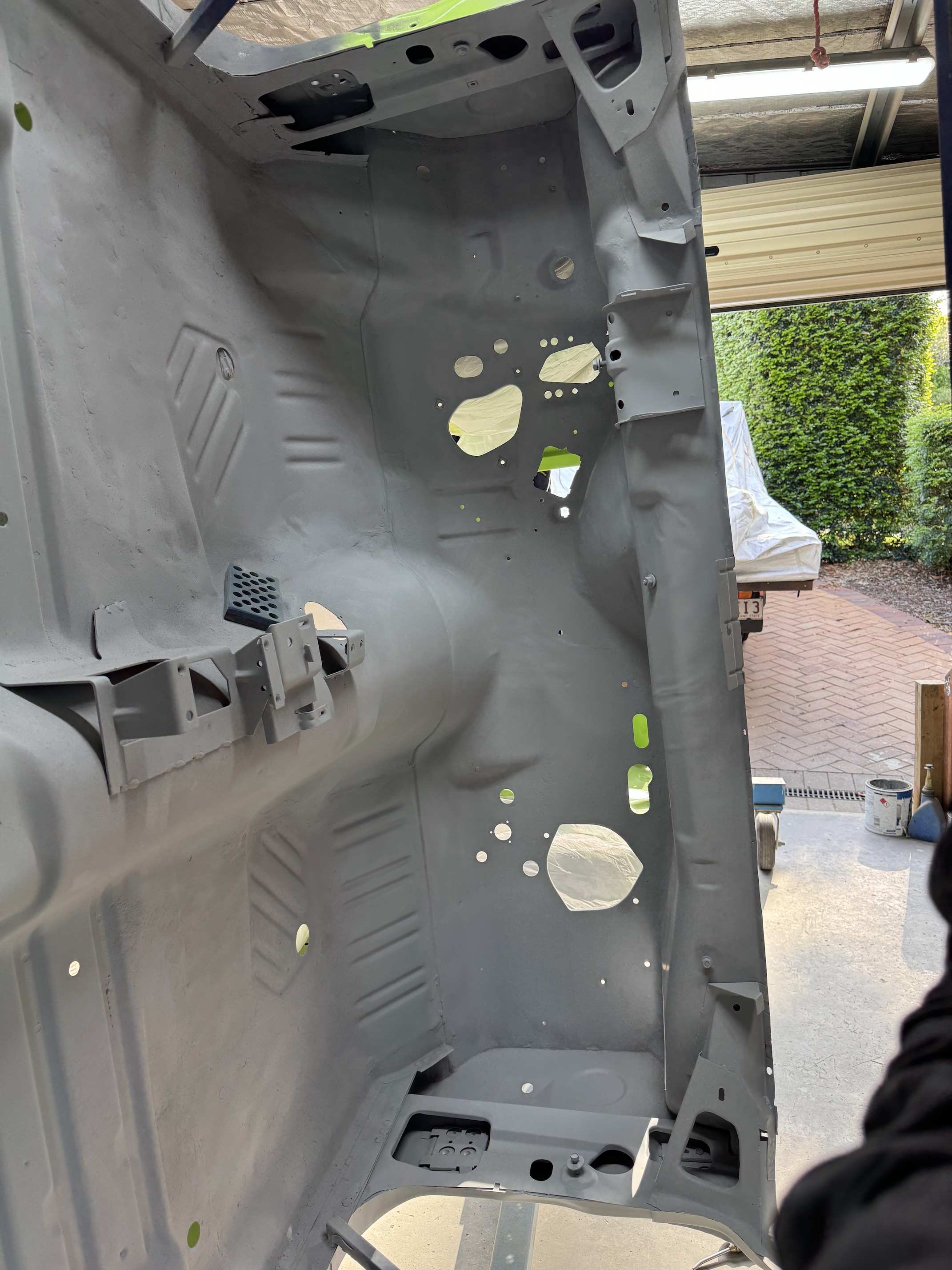

A little more progress. Got the passenger side A-pillar complete, installed replacement fresh air intake scoop. Still need to paint the welds now that I have cleaned them up ...

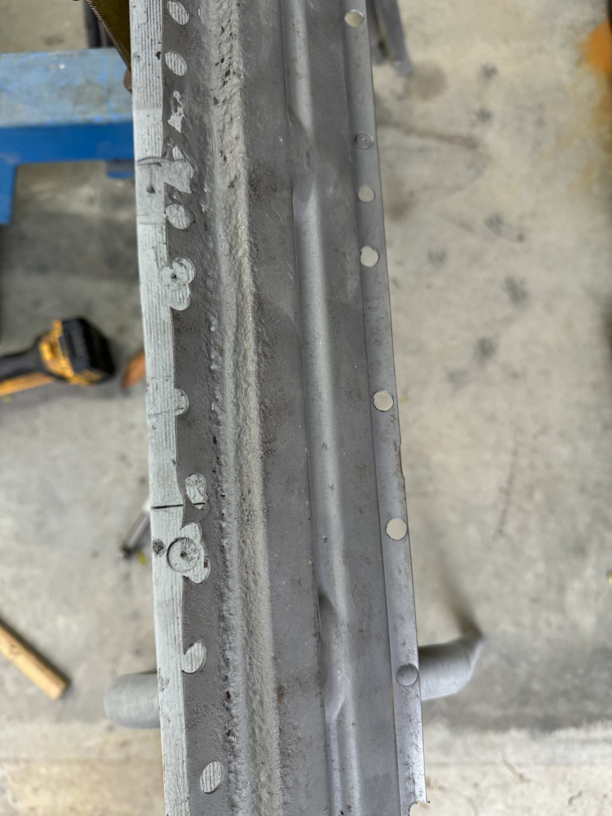

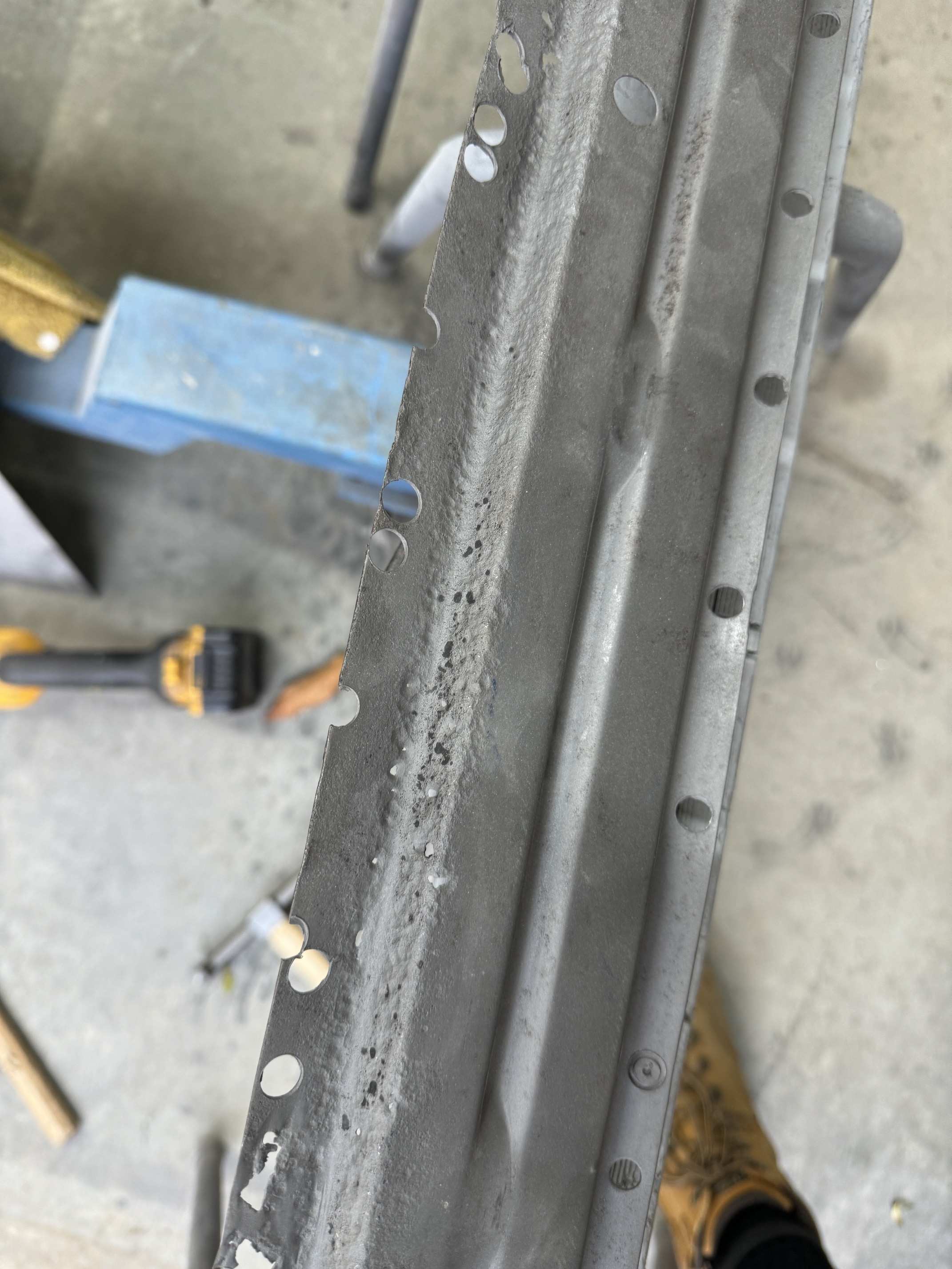

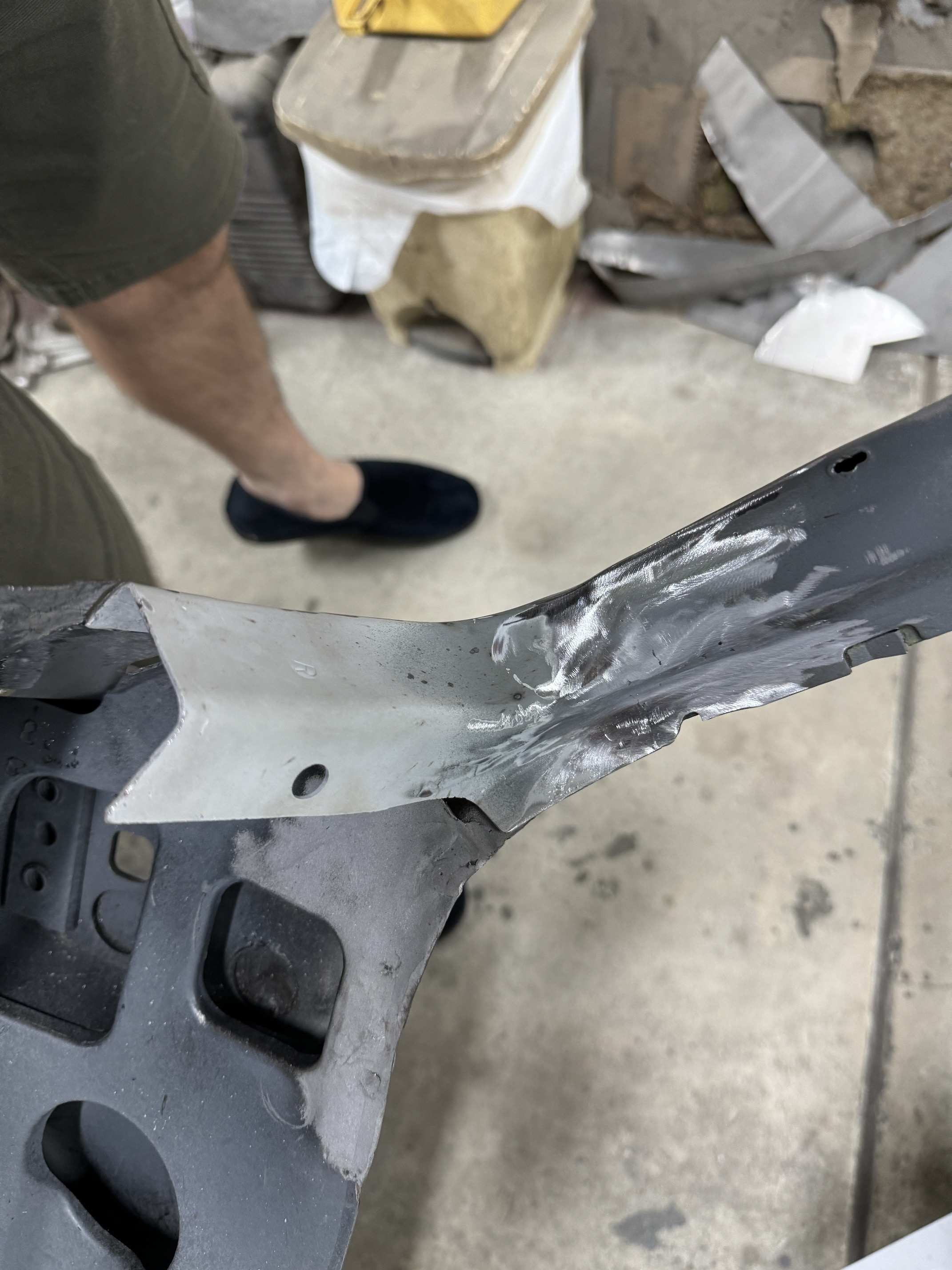

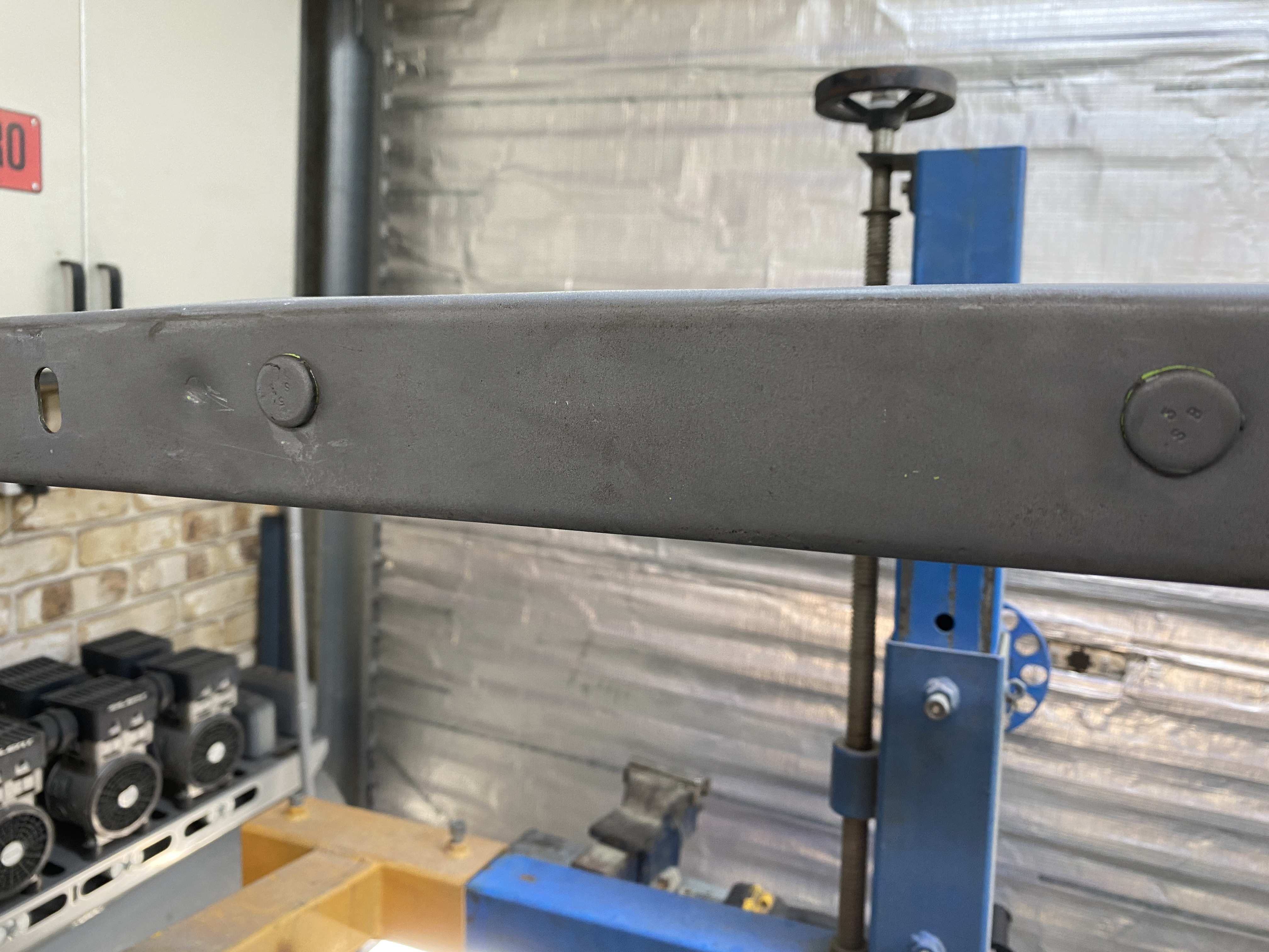

Started working on the top front windscreen brace. The leading edge above the windscreen was pretty rotten, so fabricated up a new piece and welded that on. I made the mistake of shaping it in two halves. Unfortunately it has a little kink in it if you look down the cross section of it. It shoudln't cause a problem with the roof skin, but I know it's there.
I'll paint this up with the passenger A-pillar and then weld it in place. Next piece is the cowl, then the front section is complete bar

What base material are you using to create and form the patches?
Enjoy seeing the progress
Dodgey
Sep 15, 2022
109
130
Brisbane Australia
I’m using zincanneal steel sheet as close to the same gauge as the original metal. Then using a range of hand tools, breaks, English wheel, shrinker/stretcher to shape. Then either MiG or TiG to weld depending on where/what I’m welding.

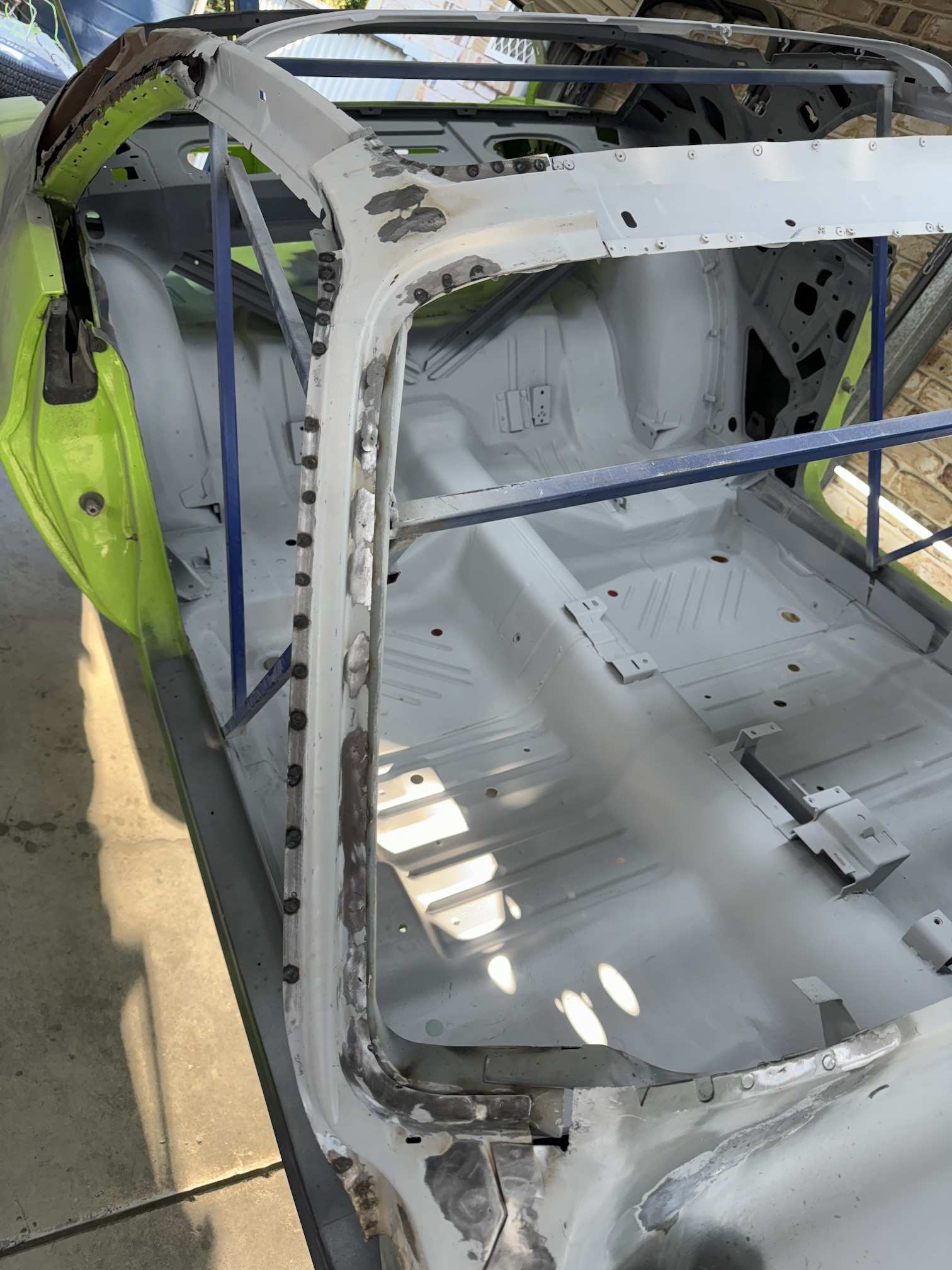

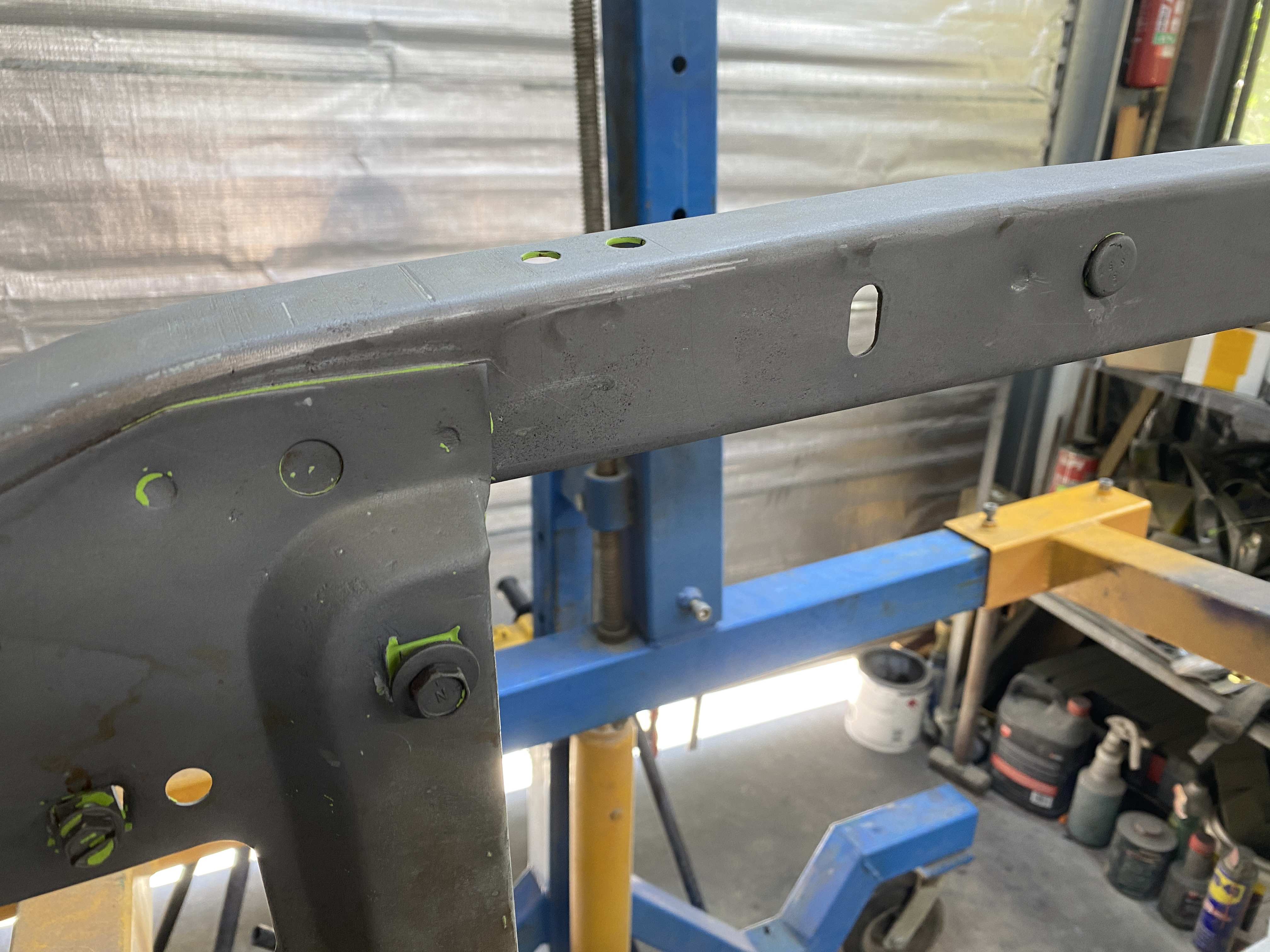

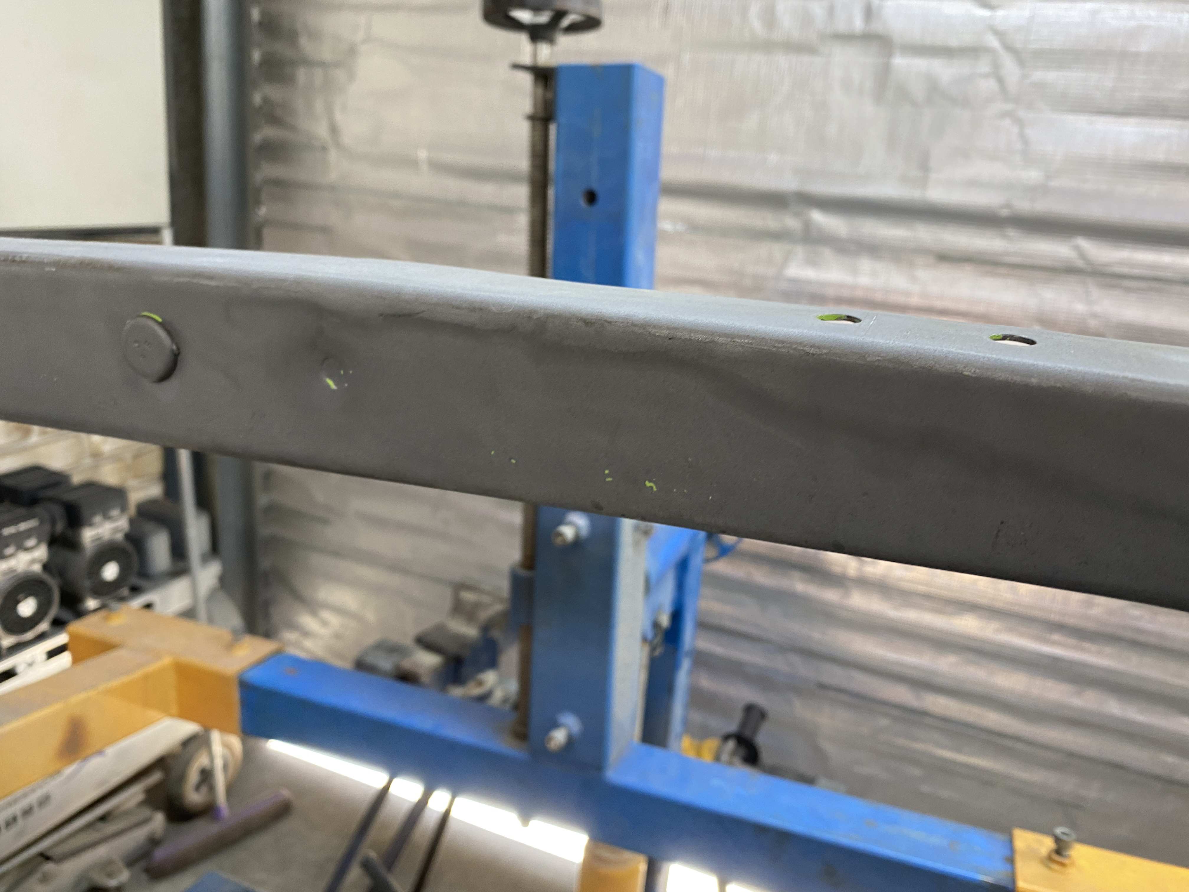

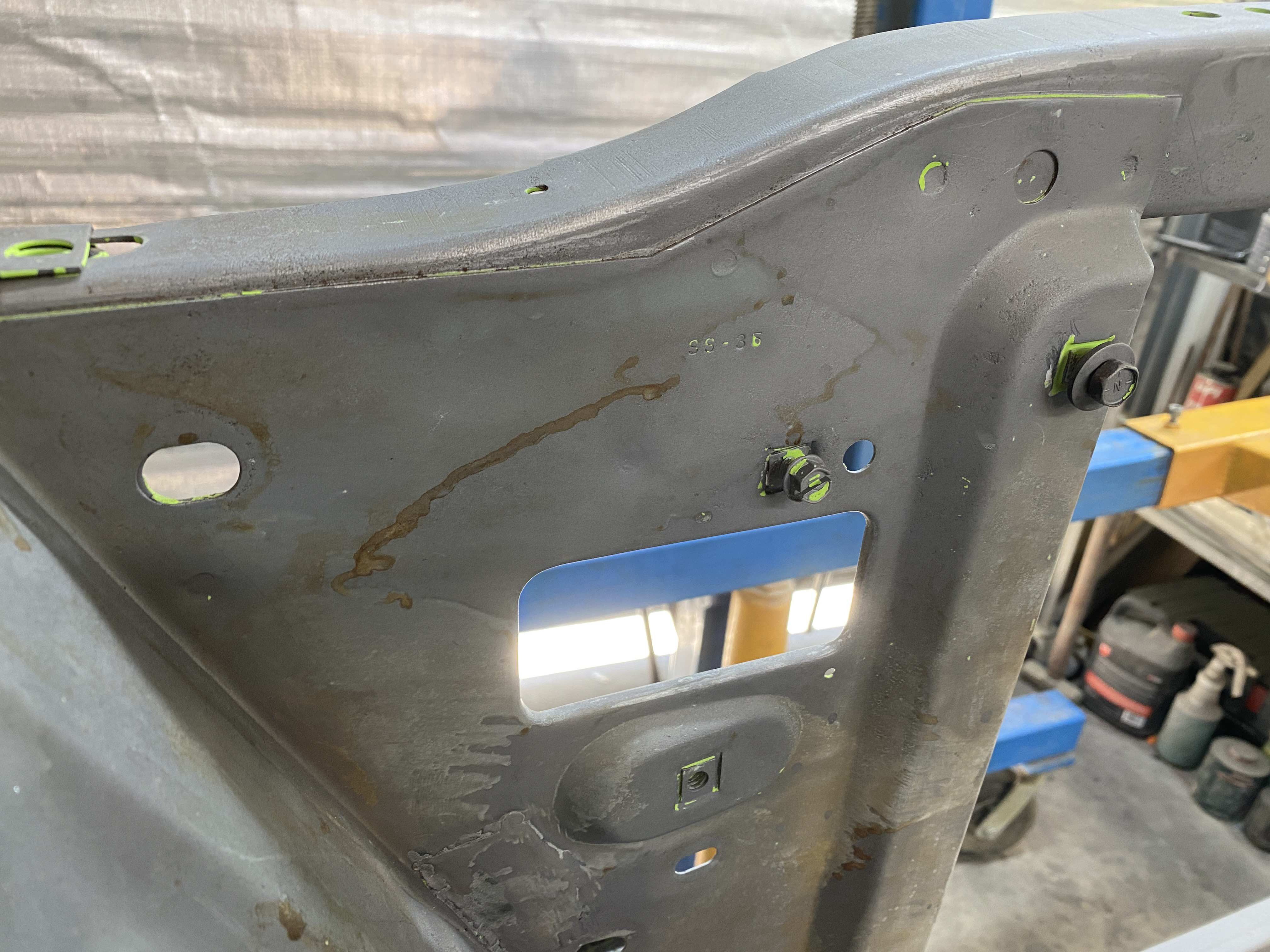

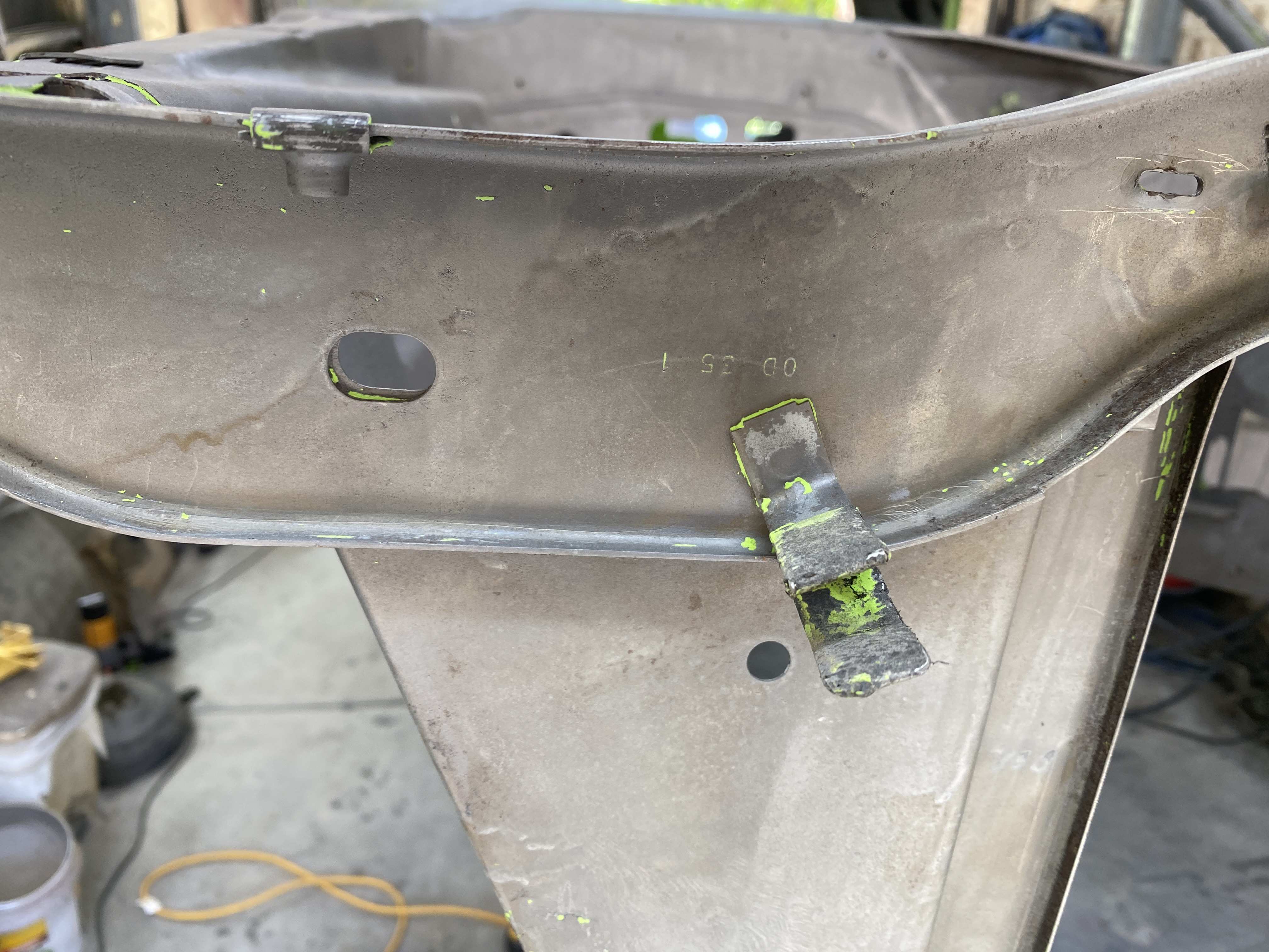

Repaired front roof support welded in and primed. Still have the cowl to do, I wanted to get this in place first as it is well located by the spot weld holes. Hopefully this will give me the datum to get the bottom edge of the windscreen (sitting on the top of the cowl) located properly.

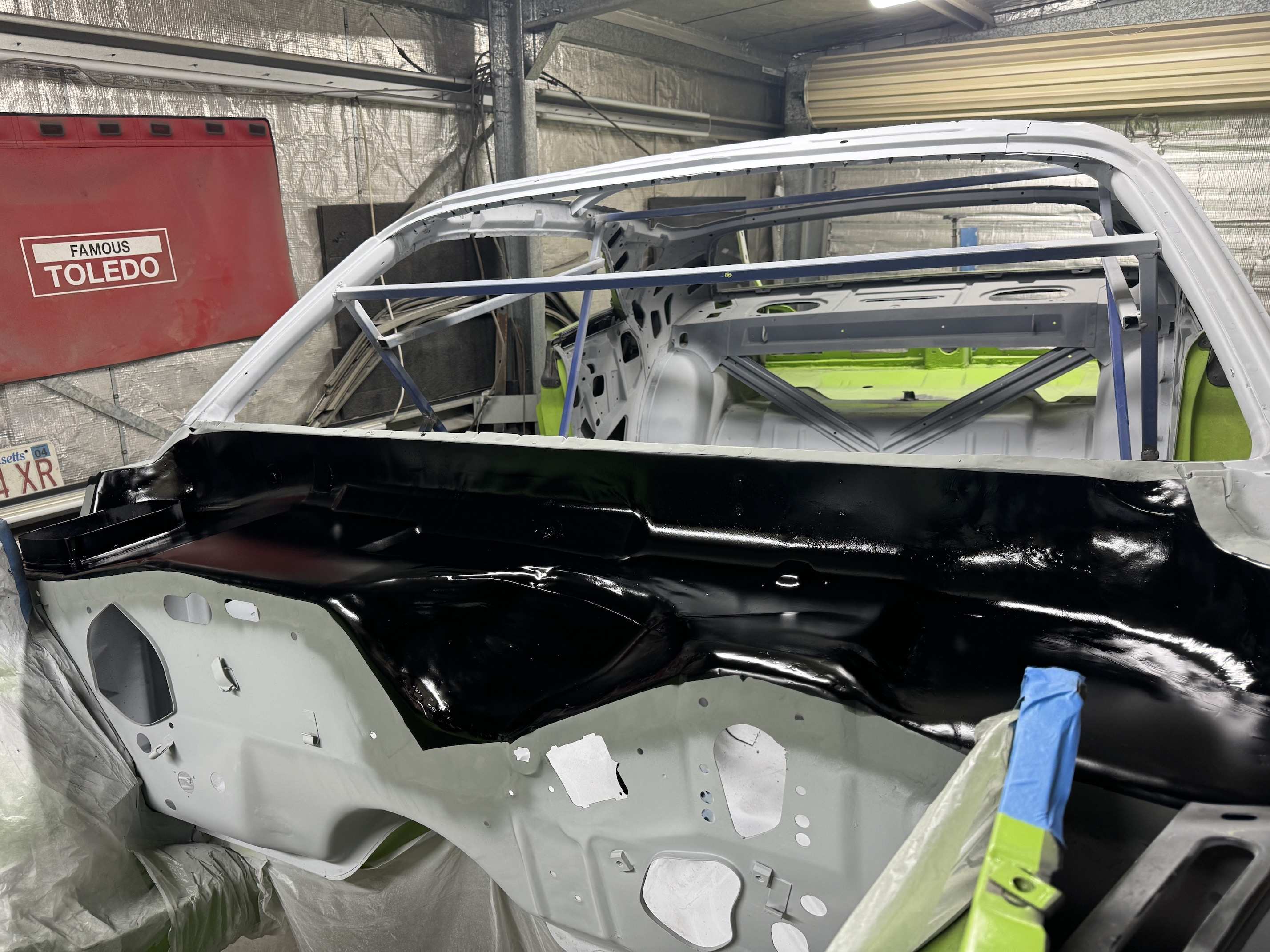

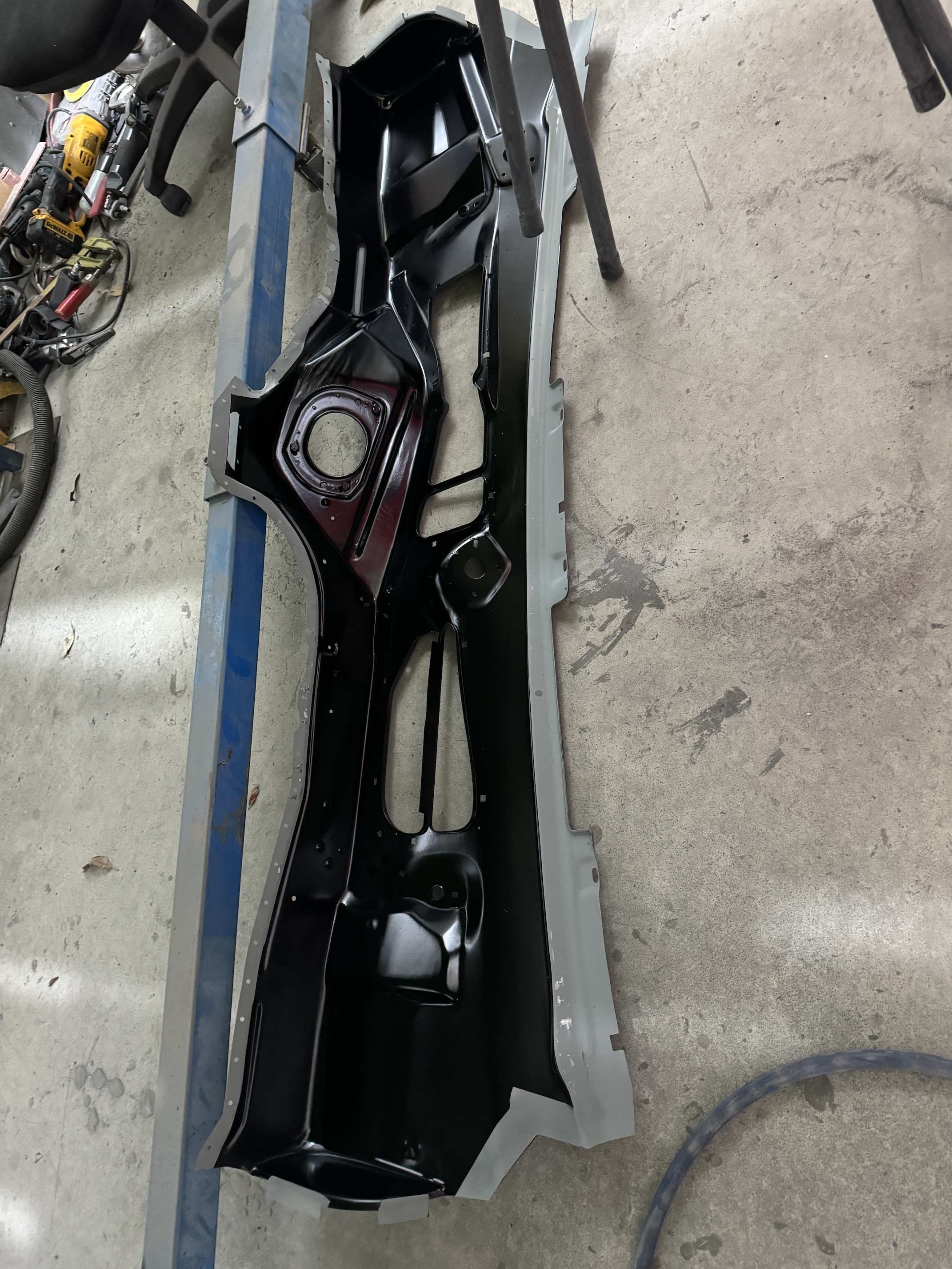

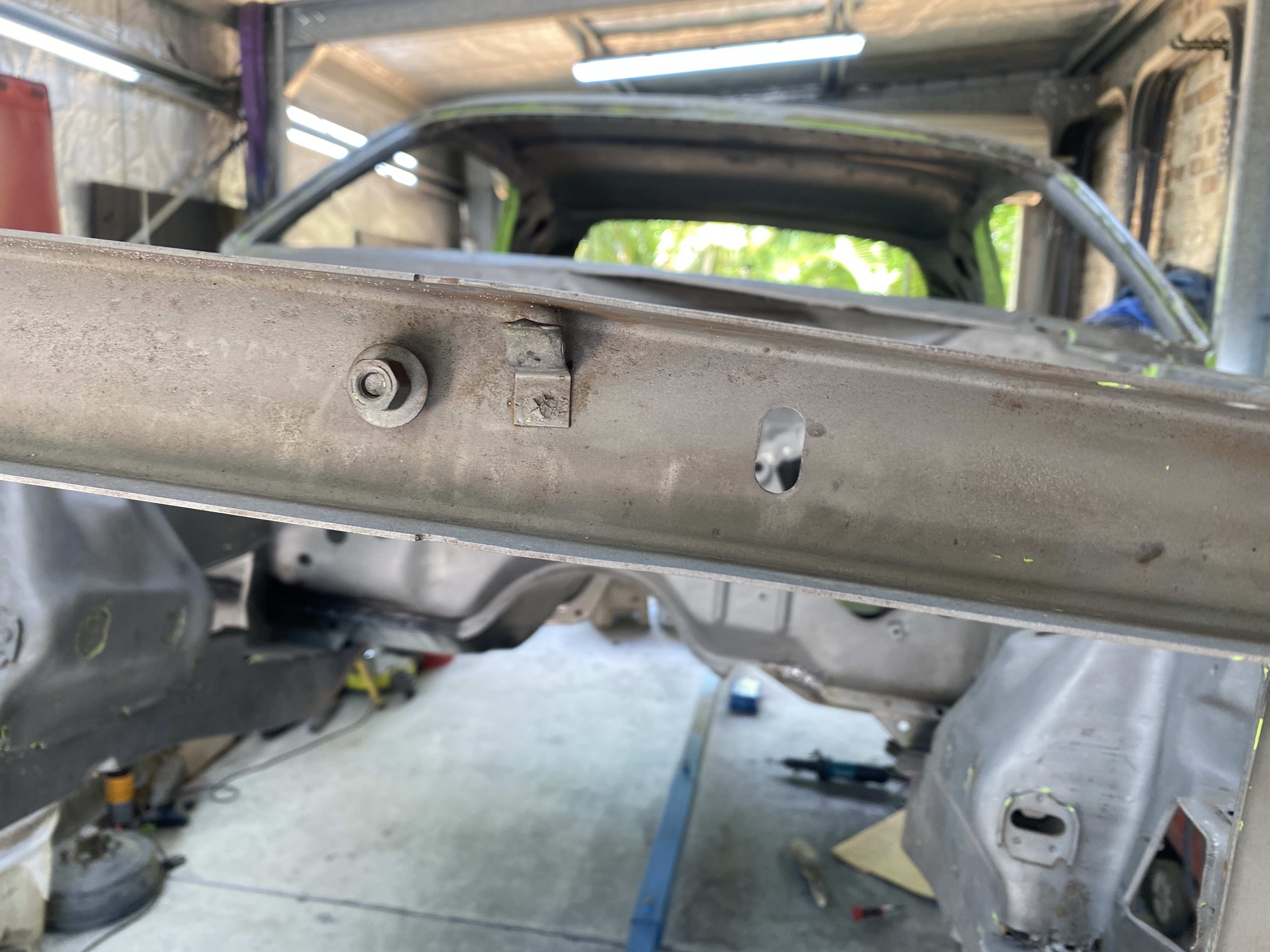

Getting ready to put the new cowl onto the firewall. Stripped and repainted the underside. Weld through primer on all the mating surfaces. Same to the top of the firewall - I've painted it all with satin black. All the documentation seems to indicate that's what it would have been. Next weekend, plenty of plug welds to do ...

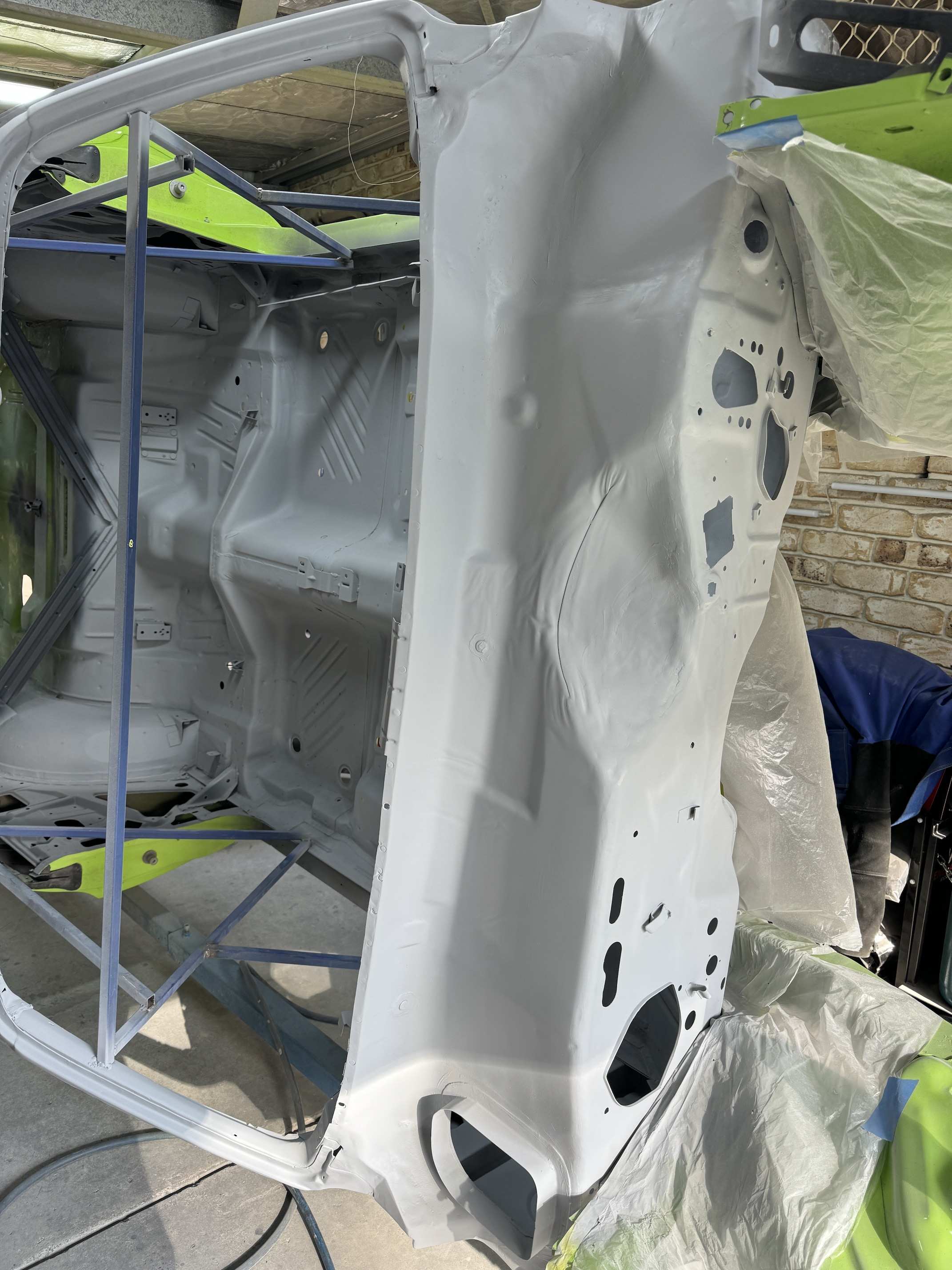

Spot and plug welded the cowl in place. I have to mask off all the openings, clean off the AMD black coating then I can 2k prime and move on to the rear sail pillar repairs ...
