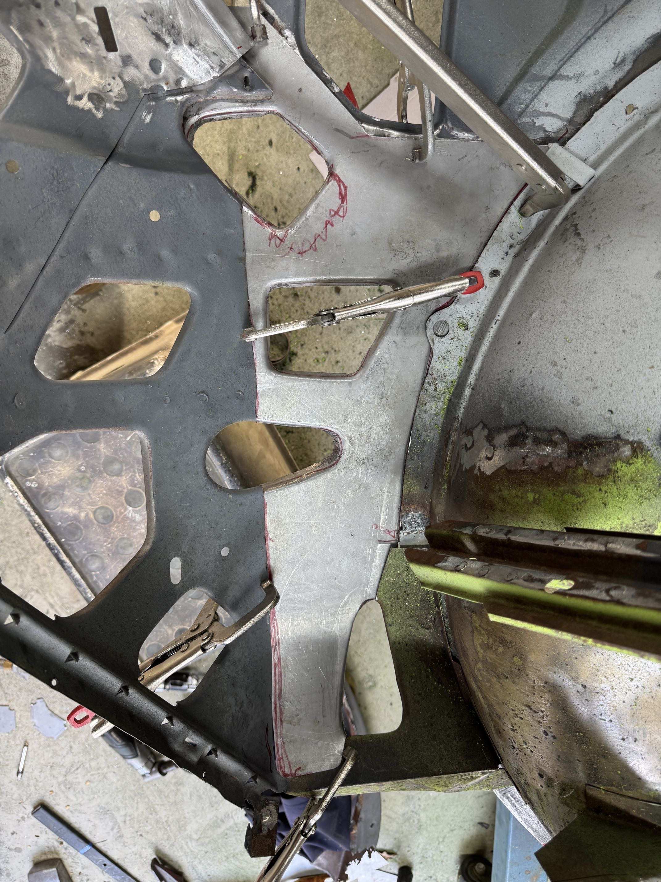

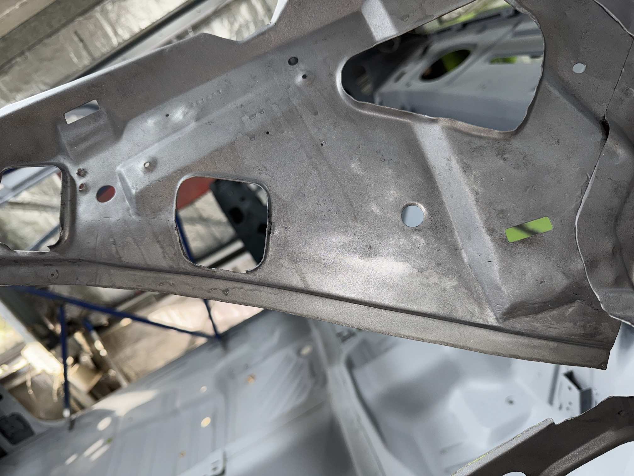

Slow progress, I was away all of December so have only just started back on it. I'm working my way down the drivers side inner shell. I've cut out and replaced one of the rusted inner sections. Now means the outer section I made has a good base to be attached to.

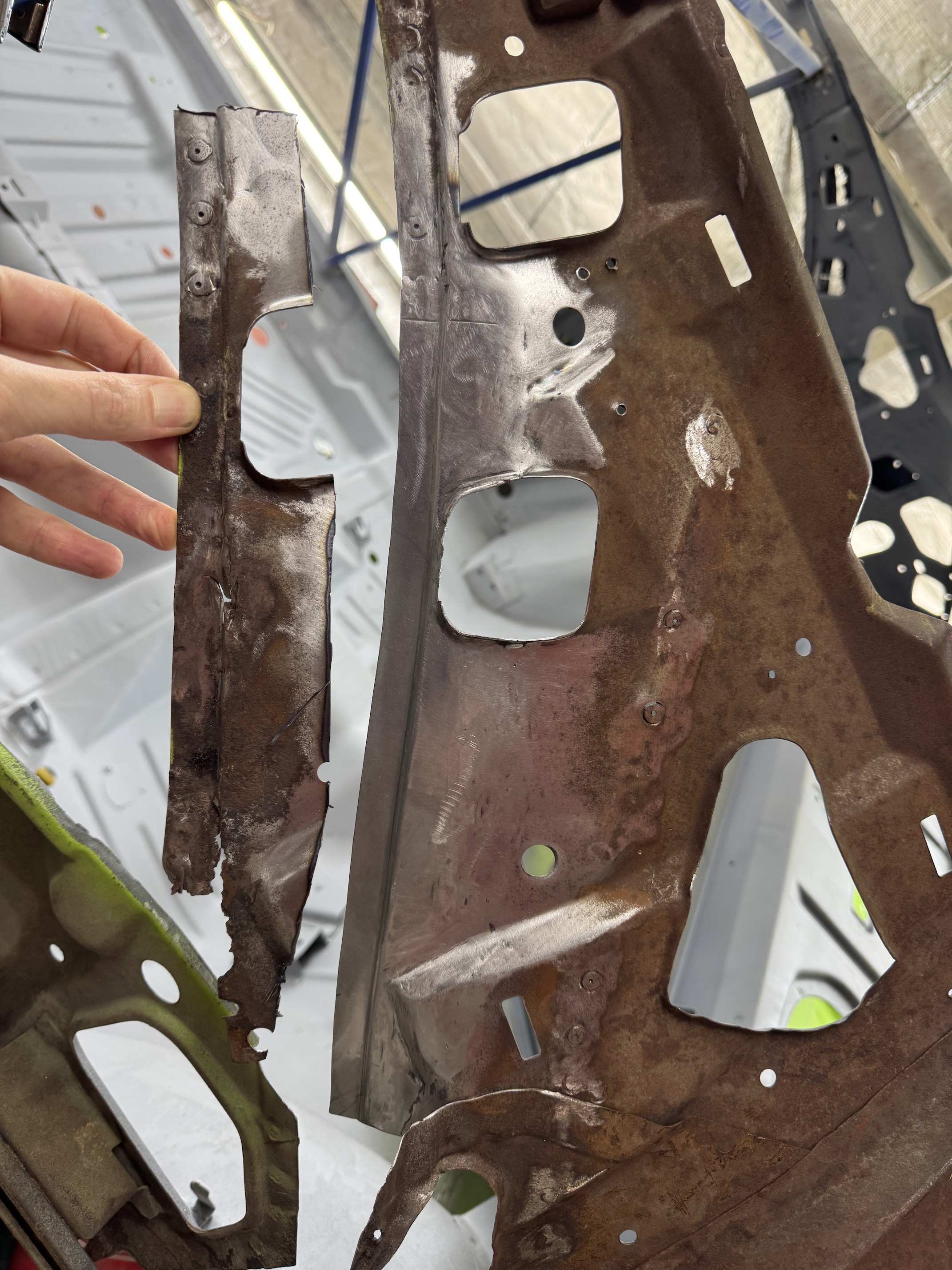

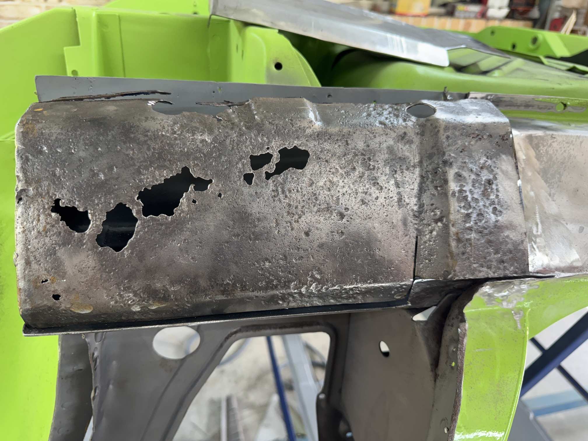

I've been trying to work out how best to finish the rest of the replacement pieces to the inner roof shell. When I took the outer wheel tub off, I released that whoever replace it just tacked it to the over the top of everything else. When I unpicked it, I discovered that the old outer tub flange was still rusting away in the sandwich of metal. So now that it's all out, I'll have to re-assemble the inner and outer tubs, then add the patch pieces to the lower part of the sail panel as it is tacked to the outside of the tub flanges. Hopefully that makes sense ...

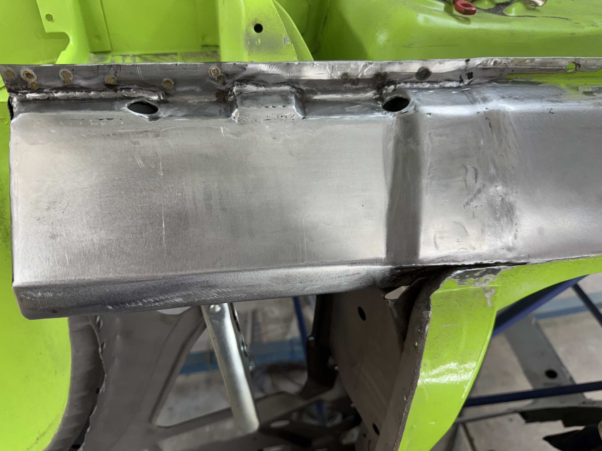

In order to do the outer wheel tub though, I had to first repair the rusted out section of the rocker ... Still need to clean the welds up on the rocker repair and cut the drain holes back into the bottom. Reasonably happy with how it came out. The 1.6mm sheet was a lot more challenging to shape than the normal panel thickness.

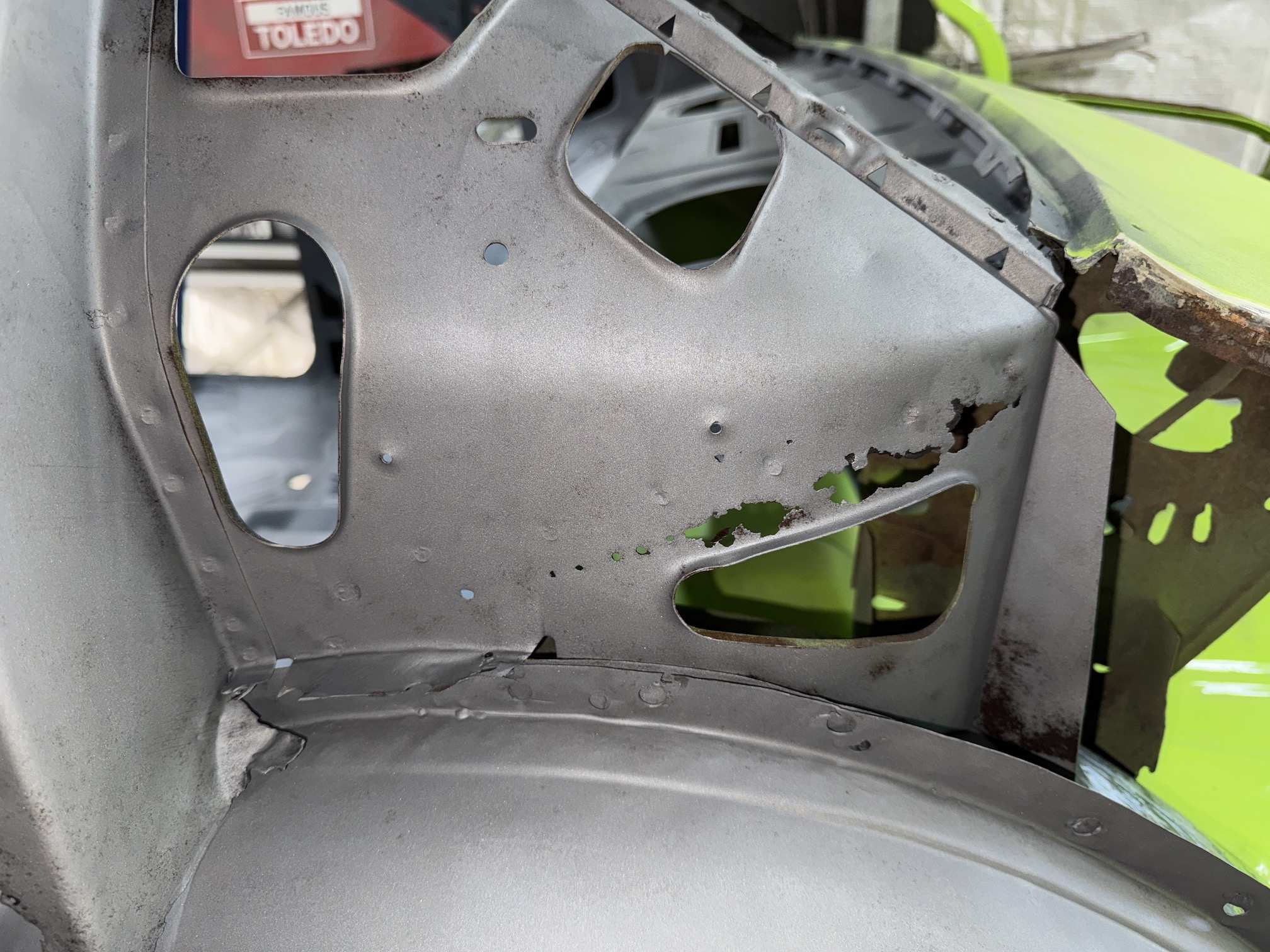

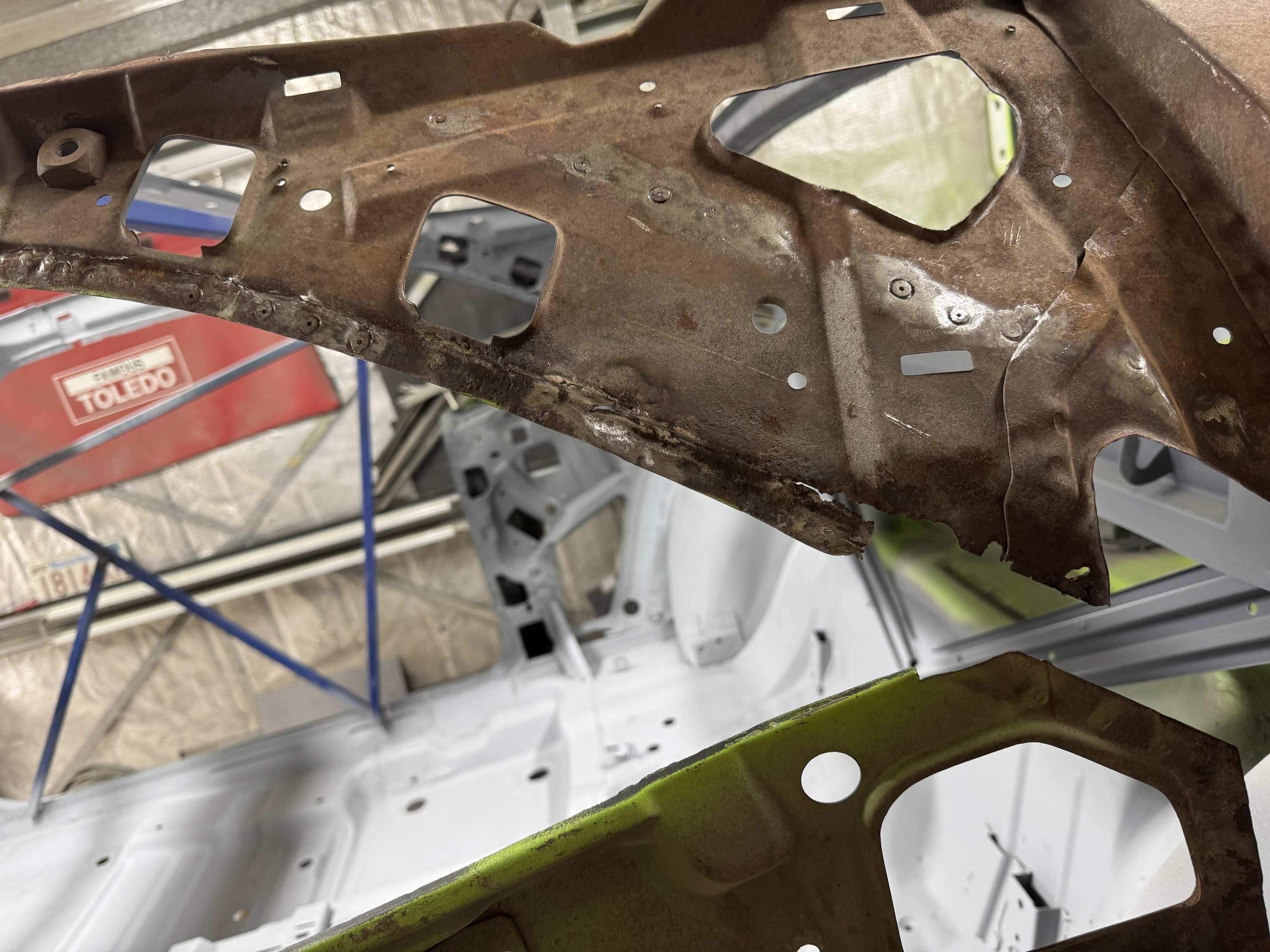

The last pic is the rear section that I need to replace as well. I'm thinking I'll continue that patch all the way through to link up to the piece I've already replaced. It's totally rusted out and pitted under the vertical roof support. But I need to take out the parcel shelf corner to do that first ...

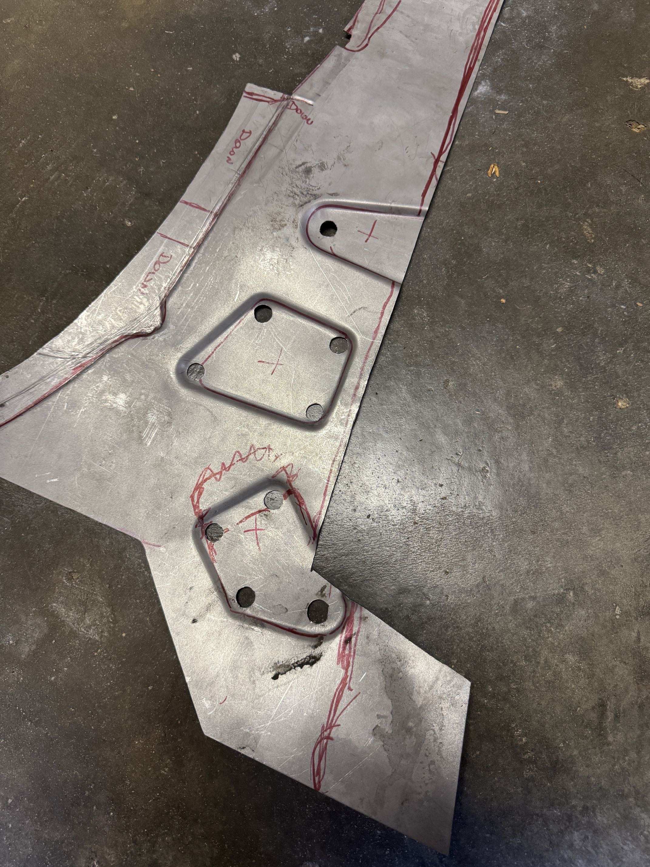

Wow, impressive detail!
Out of curiosity, if you didn't want to reproduce exactly, any reason to not do away with some of the cutouts to make fab easier?
I am trying to reproduce as closely as possible… I’m a sucker for punishment. The cutouts make me think how I can fab them with the least amount of additional welds. Call it practice. I know no-one will ever see it, but it’s for my satisfaction.

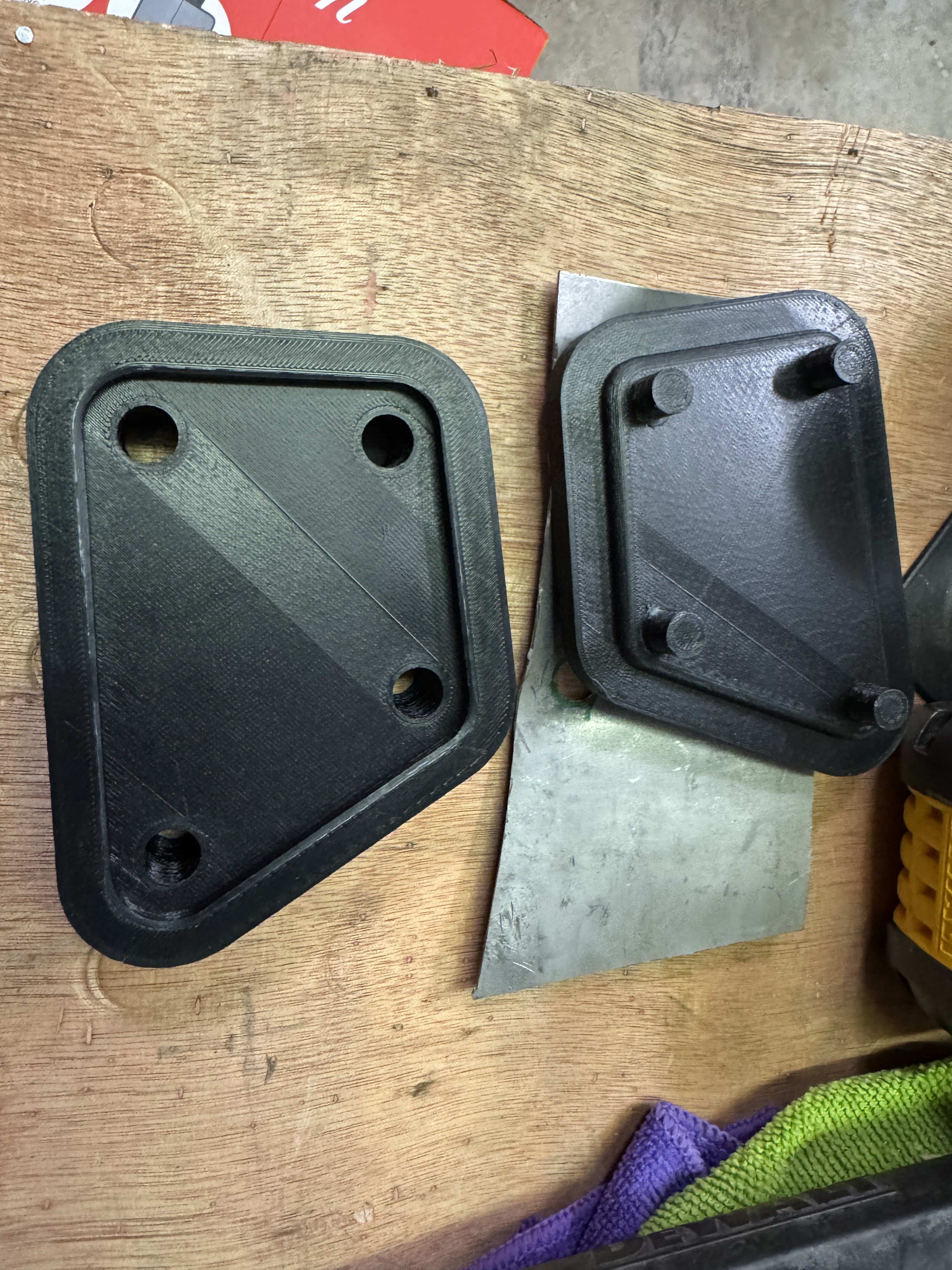

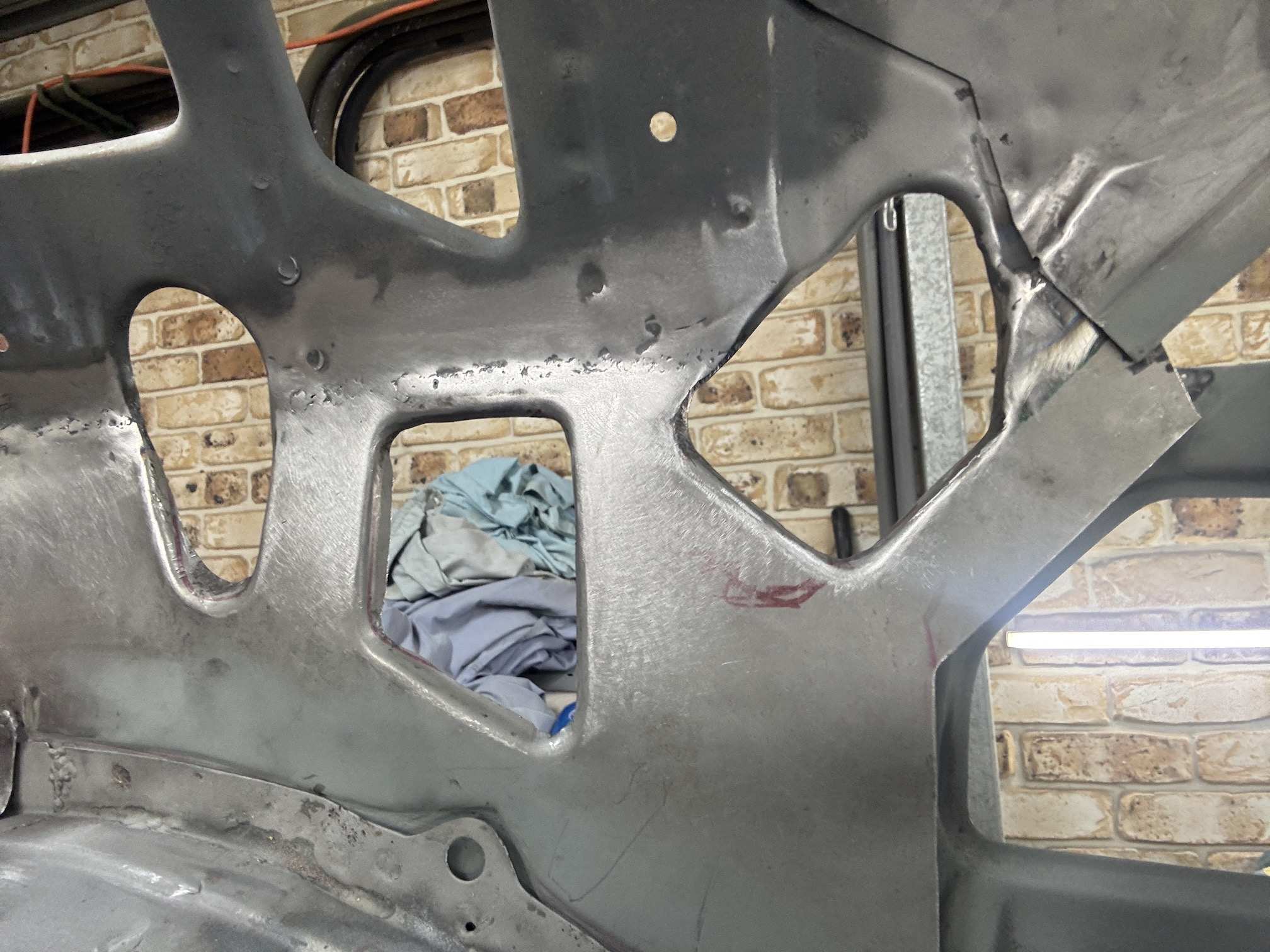

I’ve been playing with 3D printing dies to “stamp” the panels that I’m making. First attempt has turned out pretty well.
Just need to clean everything up, a bit of fine tuning and it’ll be ready
to weld in.

Very interesting!
What material are the printed blocks?
Surprised they are hard/rigid enough to stamp sheet metal.
Dodgey
Sep 15, 2022
110
132
Brisbane Australia
Very interesting!
It’s ABS plastic. Same as LEGO. You wouldn’t do production runs with them, but for one maybe two presses they are fine.

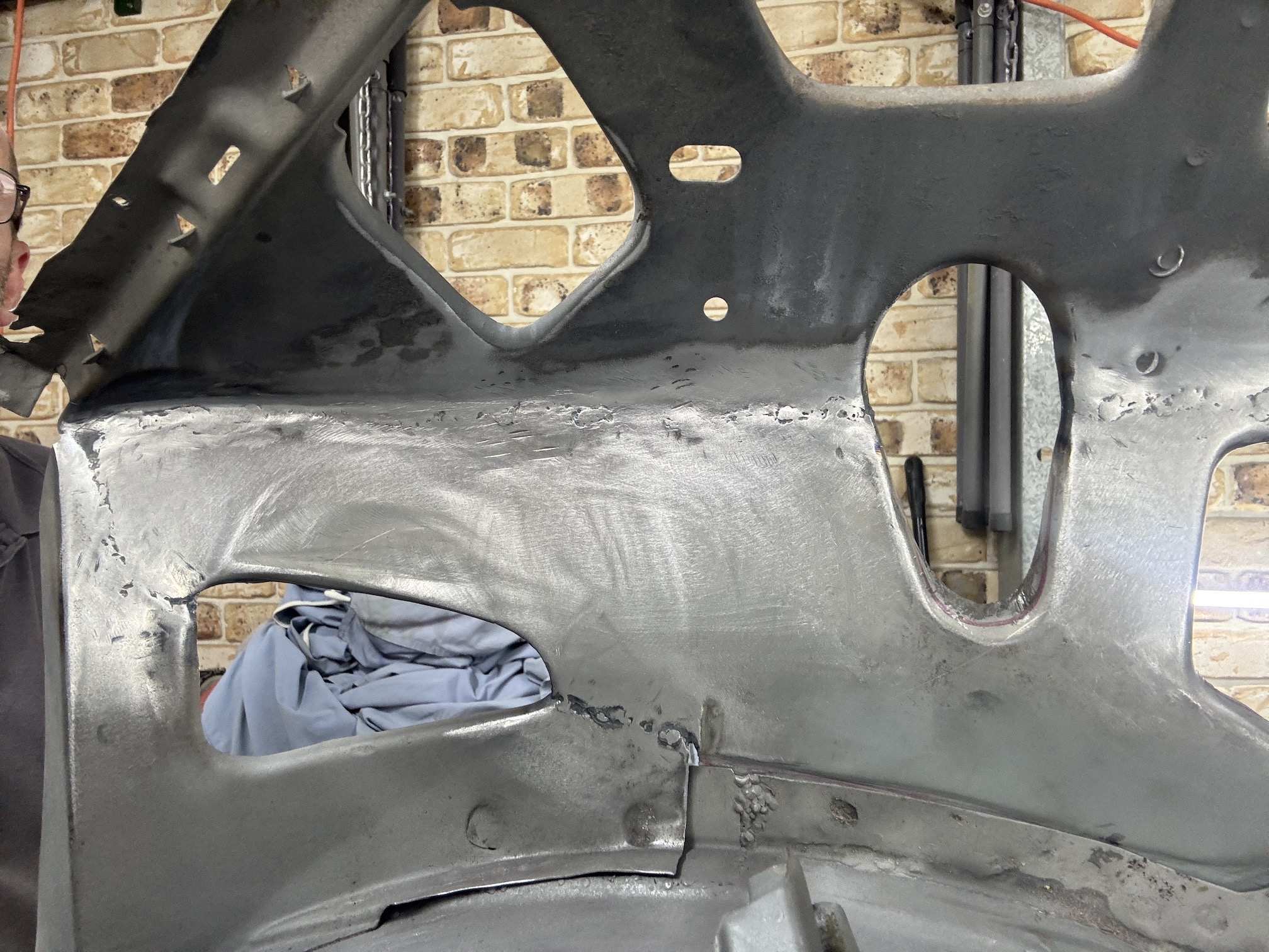

Been slow progress of late due to work committments, but I finally got to welding in the replacement sail pillar panel. Won't win any welding competiotions, but it's a lot better than the swiss cheese before.

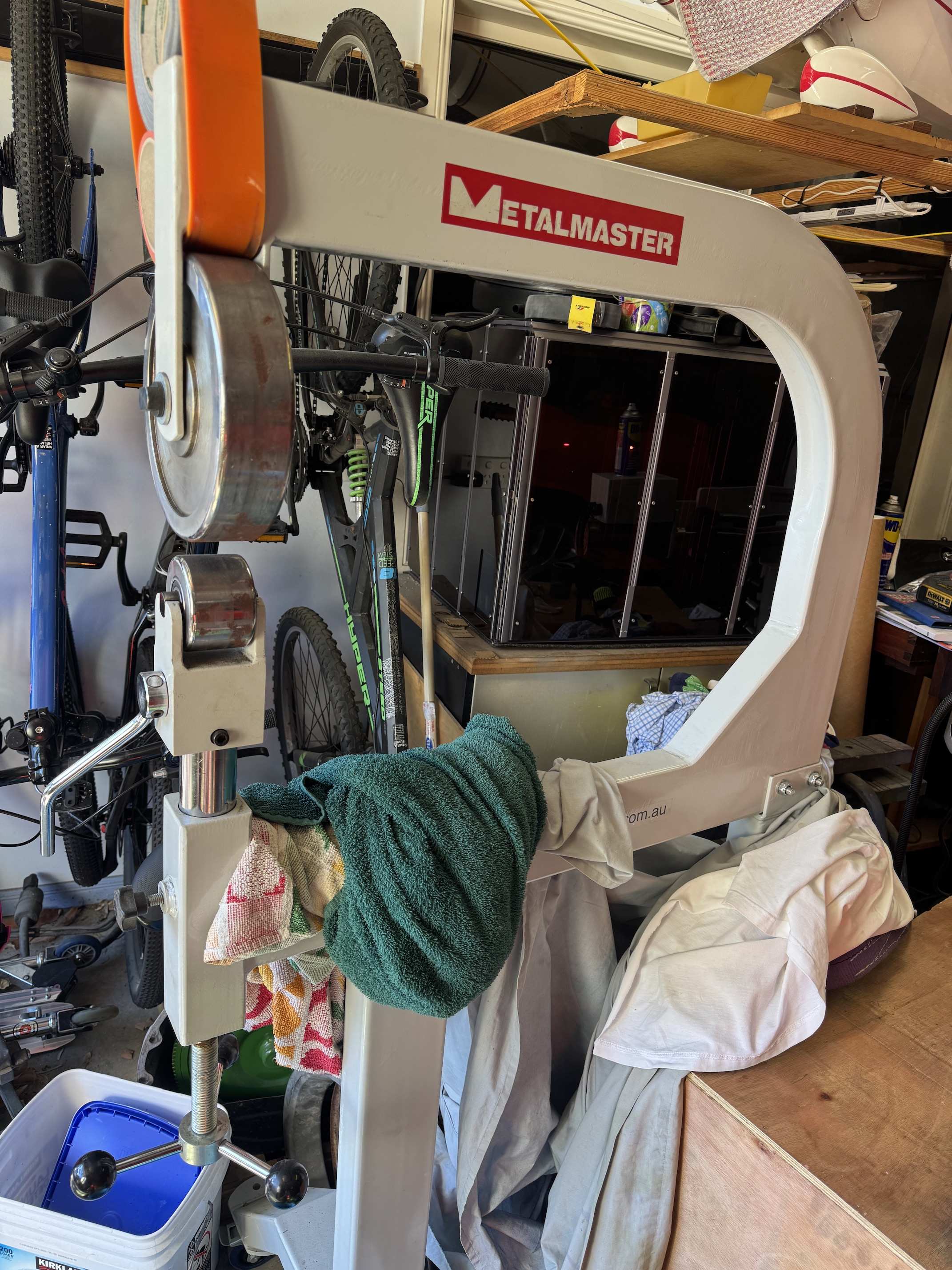

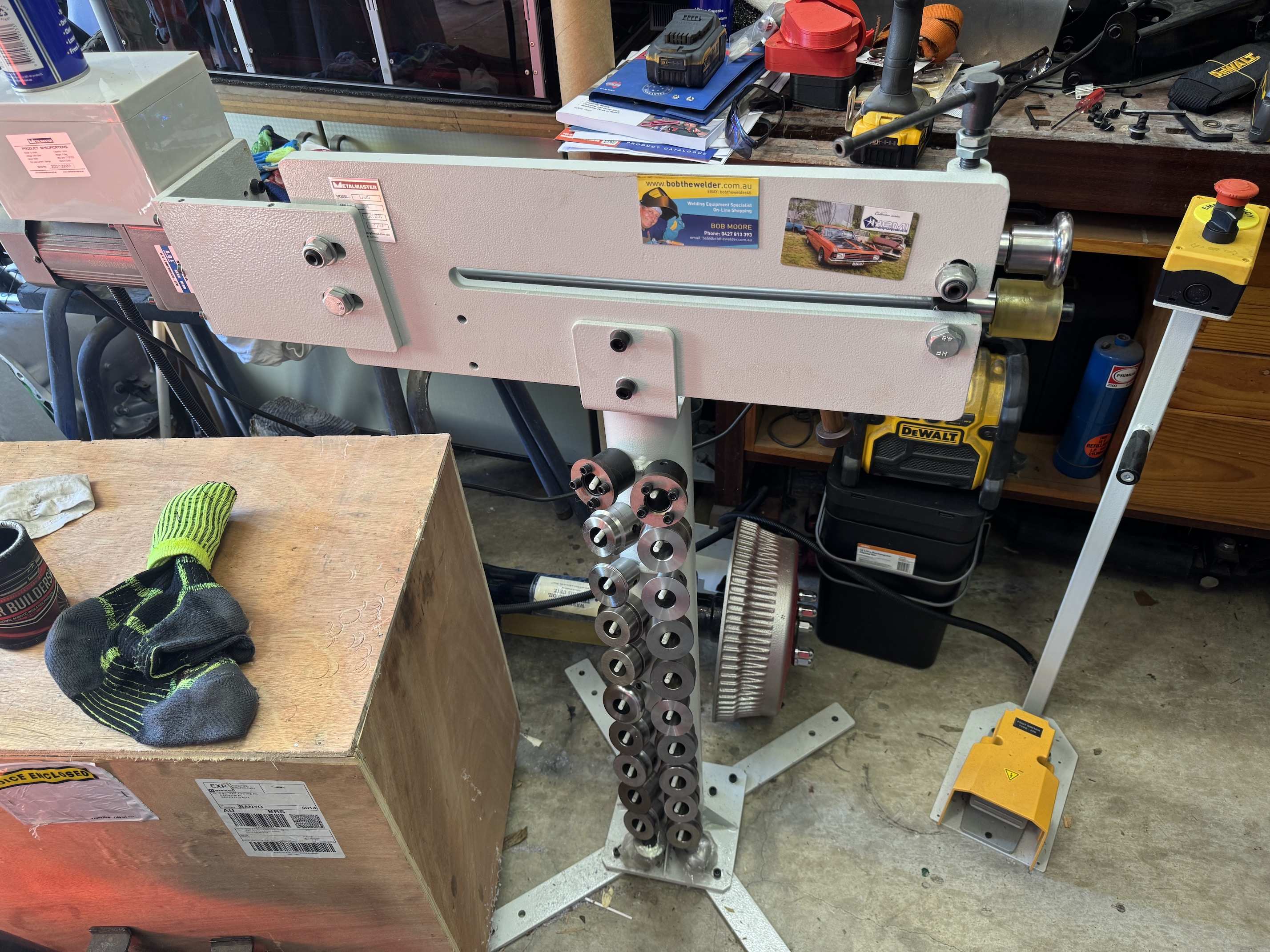

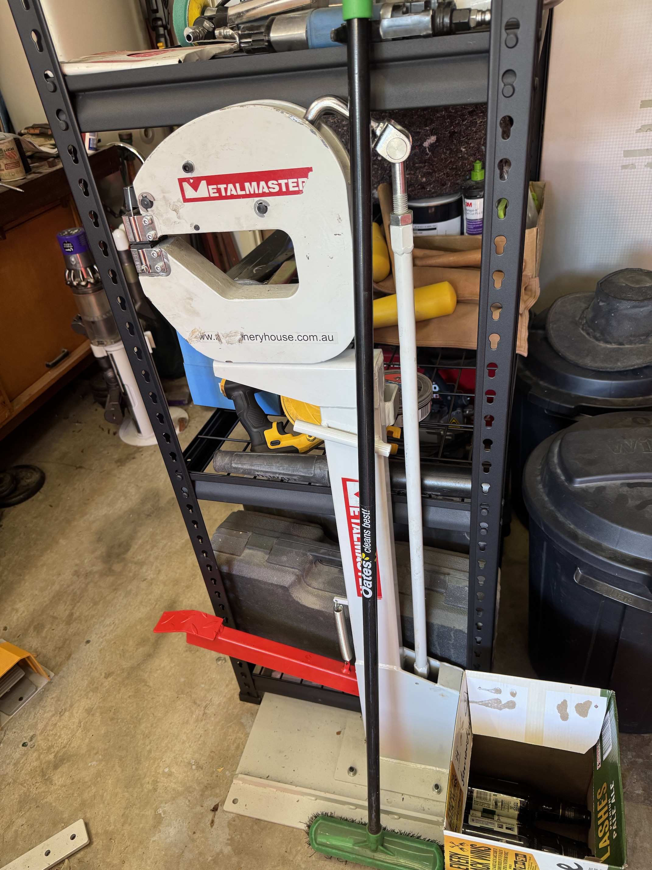

Sadly my shop just isn’t big enough - I know, everyone has the same problem 🤣
I’ve got parts of my challenger taking up floor space in my garage, which means I keep having to move things in and out as I use them. Also means I spend almost as much time looking for a tool as I do actually using it. That’s after I put it in a place so I can come back to it later quickly 🤪
Anyway, a few of the tools I’m using at the moment. All from Machinery House.
