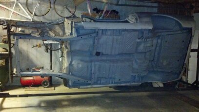

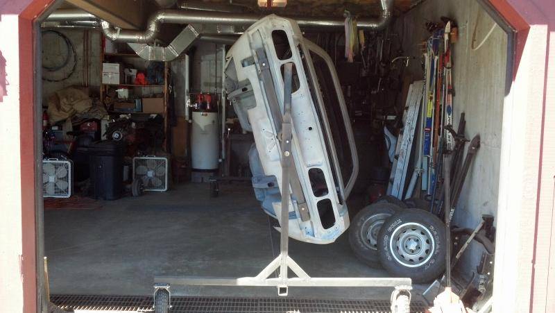

I'm am soon getting ready to take my 73 Challenger off of the rotisserie I made and get it rolling again. I had to cut the rear leaf springs off to get the axle out so I am looking to replace with new springs. I think they were origional springs.
I am a novice :glasses12:. My goal is to make this car look nice, ride nice, sound nice and be solid only, and hopefully keeping within a reasonable budget. My question is
1)where is a good place to purchase some new leaf springs and
2) is there anything else I should think about upgrading from a standard suspension that would be crazy NOT to do while I am at this stage while trying to keep within a reasonable budget.

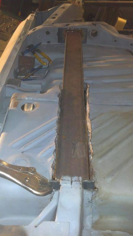

I am planing to fab up some frame rail connectors this weekend but not weld into place untill car is back on its wheels.

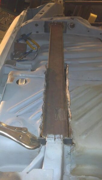

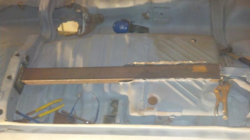

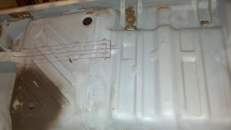

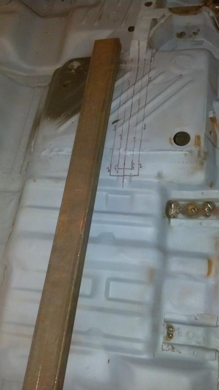

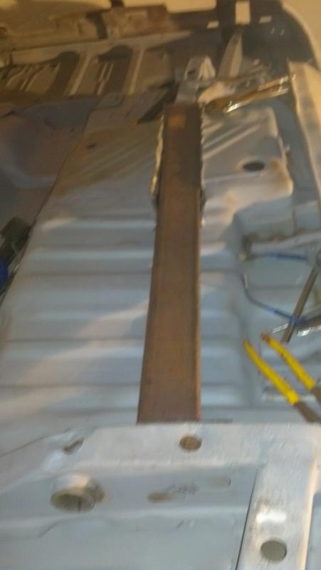

I got one of the frame rail connectors finished yesterday.011.jpg012.jpg013.jpg

Would it be a good idea get the car off of the rotisserie and back on the suspension before I weld torque boxes in place? I was told to wait untill the car is back on it's wheels before I weld in the frame rail connectors.
Thanks Brad! I did not know what torque boxes were untill I just looked them up for sale on ebay. They look like a gret idea. I bet I can fab some nice ones up for cheap $$.
