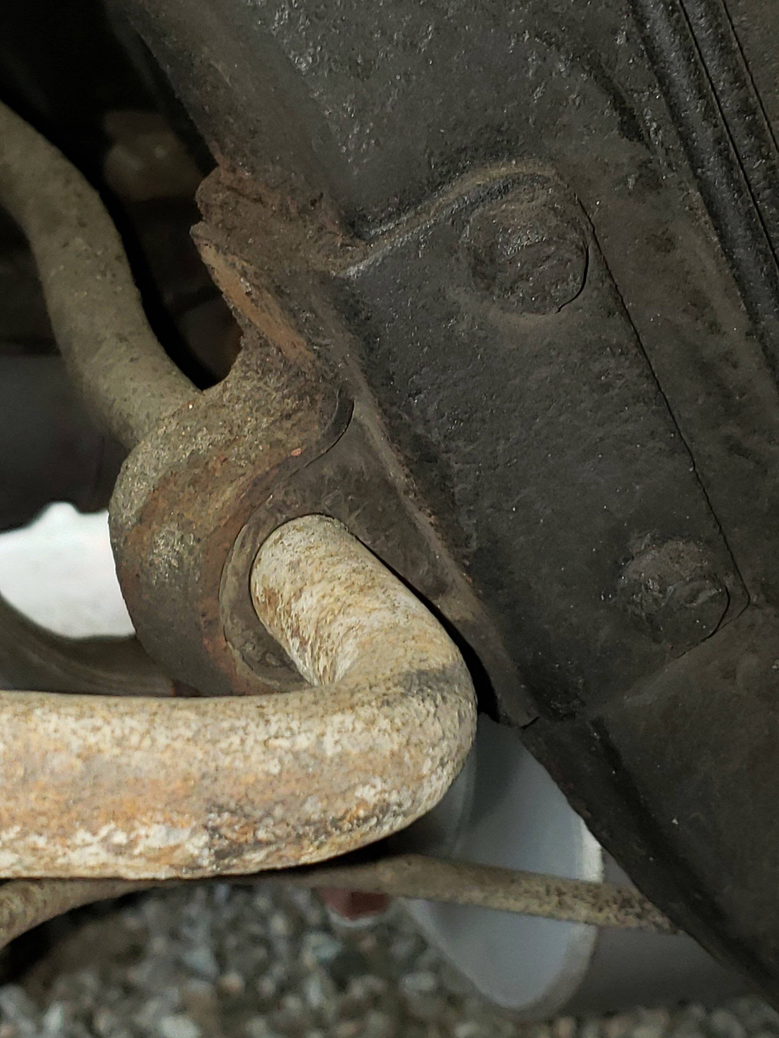

1974 Challenger w/A57 option needs suspension upgrade. Want to start with sway bars first. Hotchkiss appears well liked this site.
Thoughts otherwise? Thanks

While you are changing it, pay very close attention to the condition of the frame rail under the mounts. On my car, they were rotted out pretty badly under the bracket. Nothing that couldn't be fixed pretty easily with the welder and a patch, but you wouldn't want it to let go while driving.
