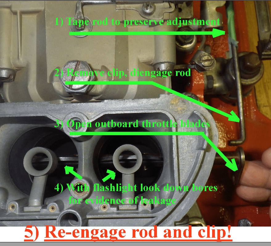

1st and foremost DO NOT START/RUN engine with outboard rods disconnected. You risk the outboard throttles opening and engine rpm uncontrollable.
After warm up and shutting down........
For the two outboards check each for any leakage with throttle plates wide open........
For all three check for seepage under bowls and pump with clean paper towel strips.........

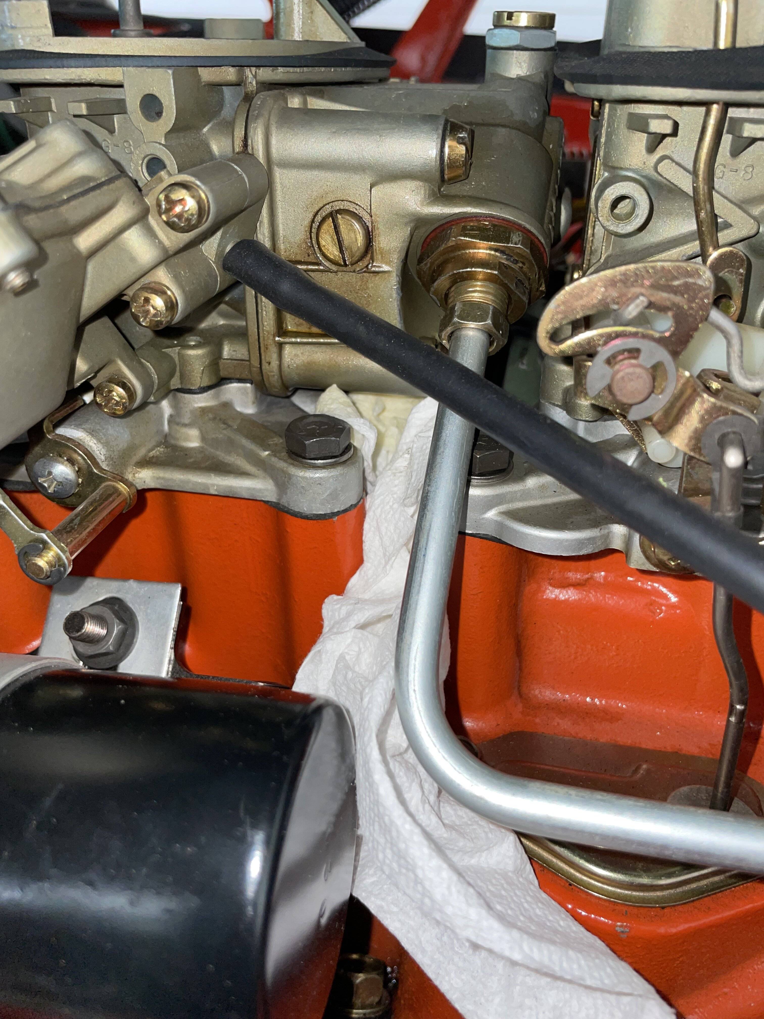

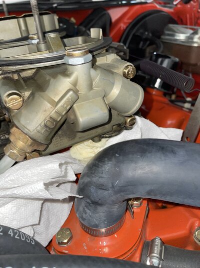

Finally found the source. Rear secondary is dripping near where the fuel line meets the bowl. Can tell if it’s the bowl or the line. Also some evidence of other drips at the other bowls. Can I just tighten, or do I need new bowl seals?

If the leak is at the carb fitting, you can try snugging it up but it may need a new gasket. Generally that gasket is metal. If it is leaking at the fuel line fitting, you can also try to snug that one up too, but it may have a bad flare. Take it apart and use some fine emery cloth on the flare if it looks questionable.

if you are tightening the 1" fitting into the carb loosen the line first otherwise you are twisting the line

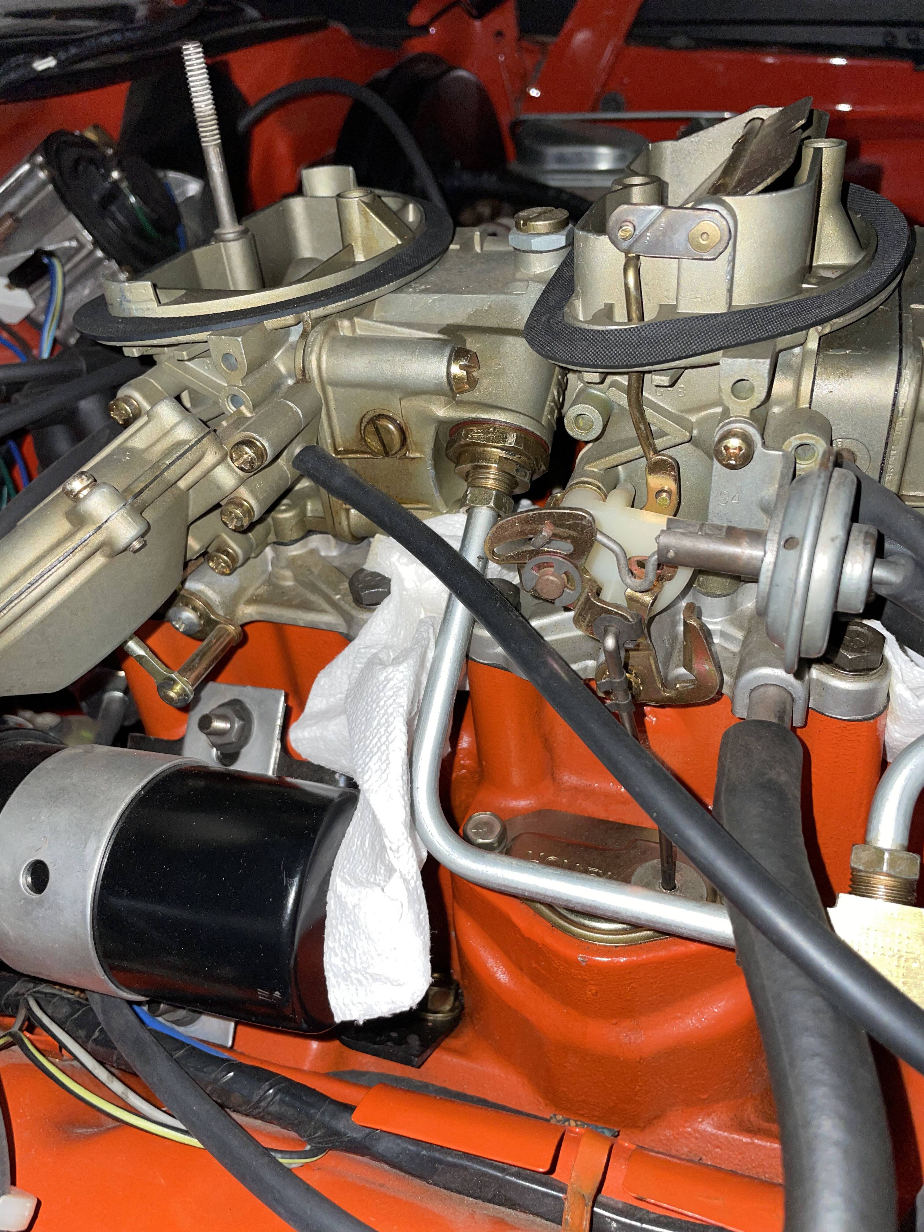

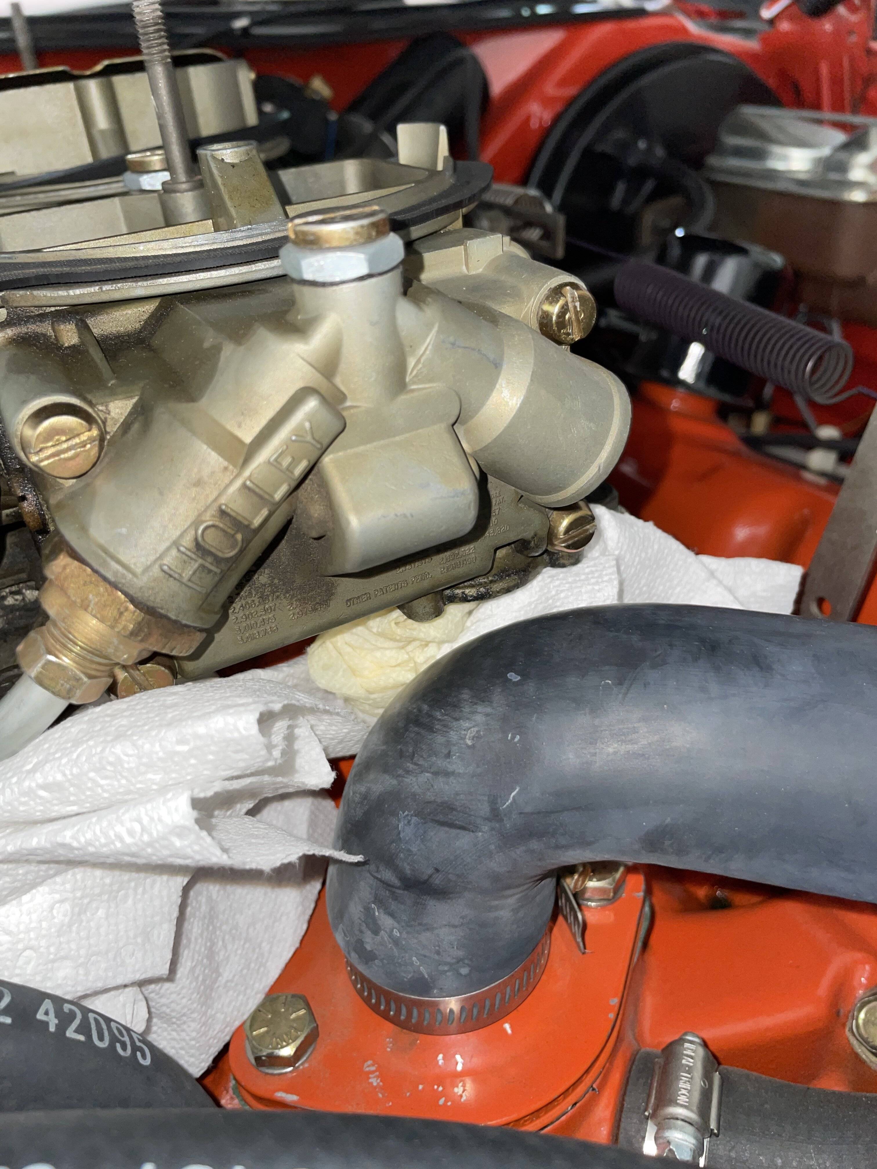

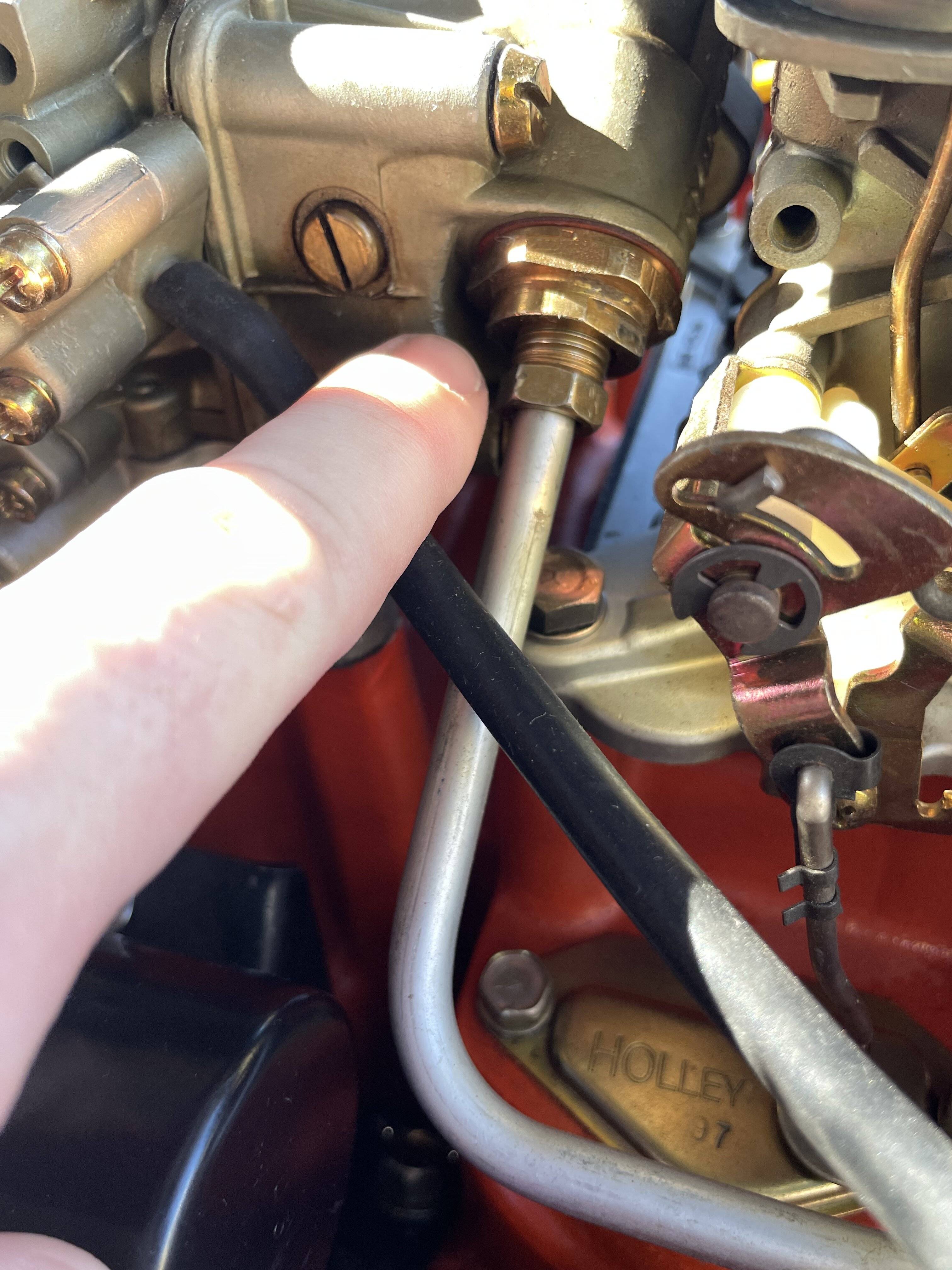

Looks like I have three leaks, one for each carb. Rear secondary looks to the the bowl, front carb too. Middle looks to be the fuel line. Do I need to send for new gaskets?

Anyone know the part number or have a link for the fuel inlet gaskets for the six pack? any recommendation? I feel like the pro max lines with aluminum fittings would be an upgrade, but I’ve read complaints on other sites about them. Lots of people went back to stock style.

I have tried the promax lines but, did not route correctly to clear the front diaphragm shaft for my comfort. It’s quality stuff though. My top end is dissembled right now and will be using the factory lines when it’s put back ( changing the comp cam/lifters). Another story! I did not have any fuel leaks with the neoprene gaskets to carbs or connections. Just didn’t like how it laid.
I prefer the factory lines.
The 3/8 steel lines are perfect imo. Use a line wrench for these. And use Chryco’s advice on the 1” fitting.
