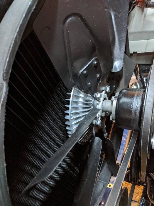

John, are you running a fan clutch? If you are, it could be slipping. If you are not, you should get one.

I'm not sure if my fan is direct drive or not. I'ts the stock fan from 1973. it turns as soon as the crank turns. I think it was turning when I tested how many RPM it took to collapse the lower radiator hose.
Here is what a clutch driven fan looks like.
that sure looks like a nice setup. That clutch and fan combo should be great for stop and go driving where not surprisingly, you are not having any issues.
The belt looks tight but if it was slipping, they get really slippery from the heat generated from the slipping.

I notice your P.S. belt hits the pump pulley just like mine. Although I have a gen 2 hemi, I guess the B family has that problem.
That happened one time when the belt wasn't tight enough. Normally it is ok.
