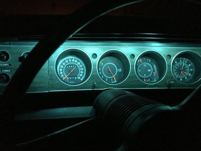

My gauges came back from Redline and got them back in the car. Getting them back in took some patience. Wiring harness isn't long enough to make all the connections while the cluster is laying on the column. They work great and with the new led's they are lit up nice now. Its been raining the last few days so fired it up a few times and everything is working well. I had to take the MSD tach adpater off. Its not need anymore and it was causing the new tach to read high. After I removed it its reading fine now. It was great dealing with Shannon @ Redline. Real impressive work. These look incredible.
Shannon did mine about 10-11 years ago. He’s the best IMO. Good choice!
