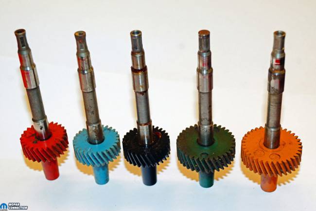

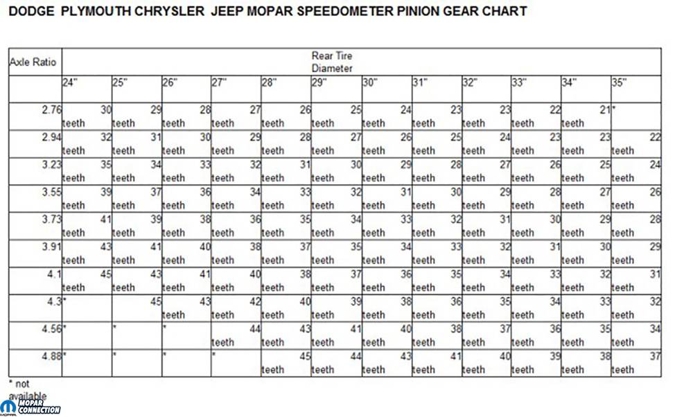

Here is something else you might use.
I change gears for a customer and going by those charts did not work well for me. I used on of those phone apps on my phone to get the right gear. It was no where close with the charts using the diameter of the tire.
