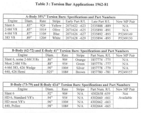

Found this torsion bar chart that could be useful
Shows original ID numbers as well as part numbers
In my case the 778R and 779L bars were installed on an A66 340 car with the factory HD suspension, Odd number left, even number rt side.
Bars were installed with the number toward the front.

Ok thank you so much. i DID SOME MORE LOOKING AND 774 AND 775 . RIGHT SIDE SHOULD BE 774 LEFT SIDE 775
