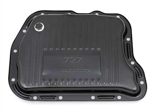

This is the pan I have Mr Gasket . They said they are going to double gasket it.

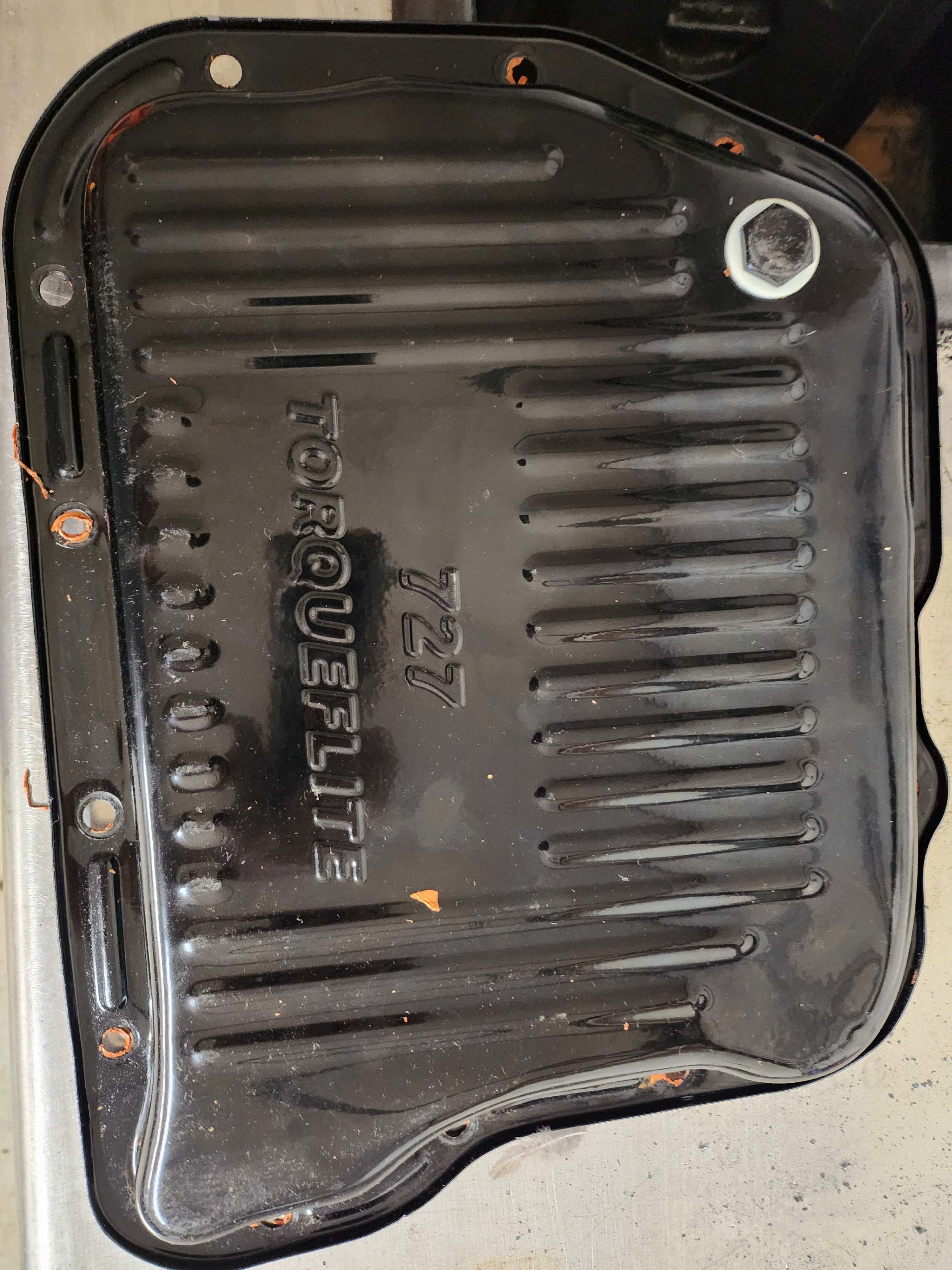

The old or original one leaked too , they tried the old one again to see and they both leak , very frustrating .
when I saw the pic you posted it looked very familiar, I dug this out this morning. you may wanna try a different pan, I changed the gasket 4 times on this pan. I'm thinking three different types of gaskets and Permatex on the last try which is tabu for transmissions (what I've always heard). the gasket I used that worked had crushproof sleeves where the bolts went thru, on a stock pan. Snugged them in and drove for a few days then snugged them one more time, fixed the problem for me.(tried on this pan also to no avail) Good luck these leaks are a PIA. and are expensive. At least I have something for target practice.
