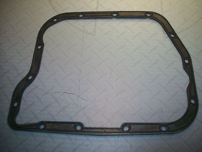

You could also try the OEM A518 gasket. It works great on 727s, even with sheet metal pans: 2464324AC. Don't get an aftermarket version. The OEM Mopar is hard plastic with shaped "orings" to seal unevenness.
Hello GiantRobo, quick question. Do you remember what you torqued the transmission pan bolts to? What I have seen online is 105 in/lbs.

I used my stubby ratchet and held it close to the head and tightened as tight as I could with one hand. No science but it worked for me.
