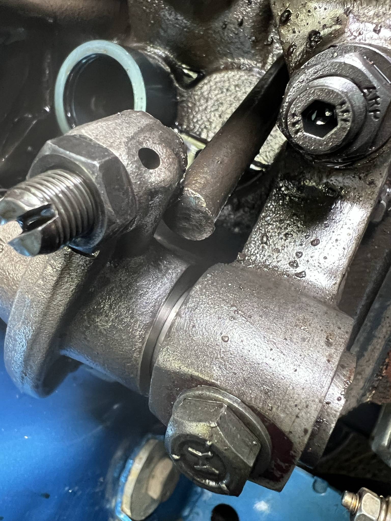

Ok.. so I found the problem. Pushrod slipped off the rocker. Can I just replace the push rod(s) or do I need to remove the head to inspect for any damage? Picture of damaged push rod attached.

Should be fine just replacing the pushrod /rods , check the adjusters carefully also , might need those replaced also .
You should probably check the lifter for damage if there is a cam problem however .

The top of the pushrod appears to be broken off. I would spend some time to understand why that happened before throwing replacement parts at it.
I would guess that the pushrod length was incorrect or there was interference between the pushrod and the head.
If you were revving hard when it happened. You can probably replace the pushrod. If it just happened cruising , possibly your lifter needs replaced or your rocker may have settled in and became loose. I have seen this happen before and in that peticular instance it was the rocker bar they didnt have it shimmed where the pushrod was centered in the hole and it rubbed and got hot and popped out he had to shim both sides replaced the pushrod and was all good. In any case look at everything good luck common sense always wins

Is the pushrod ball/ball or cup/ball? Ball/ball, I'd say there's less pieces in your engine. Cup/ball and you're looking for lots of metal. Drain the oil, remove and cut open the oil filter. That will tell you a lot. Check your lifter and that cam lobe. A standard tool in everyone's garage nowadays should be a borescope that Bluetooths to your smart phone. A decent one can be had for $70 to $80. You may just have had an adjuster loosen up. Good luck.

You gave us just a peek at the topside of your engine. How about a wider shot and some more detailed info on this engine.
Obviously not stock. When you ask a question we need some context on what you are working on, otherwise everyone thinks it is stock and has stamp rockers...Can't get good advice without good info.
