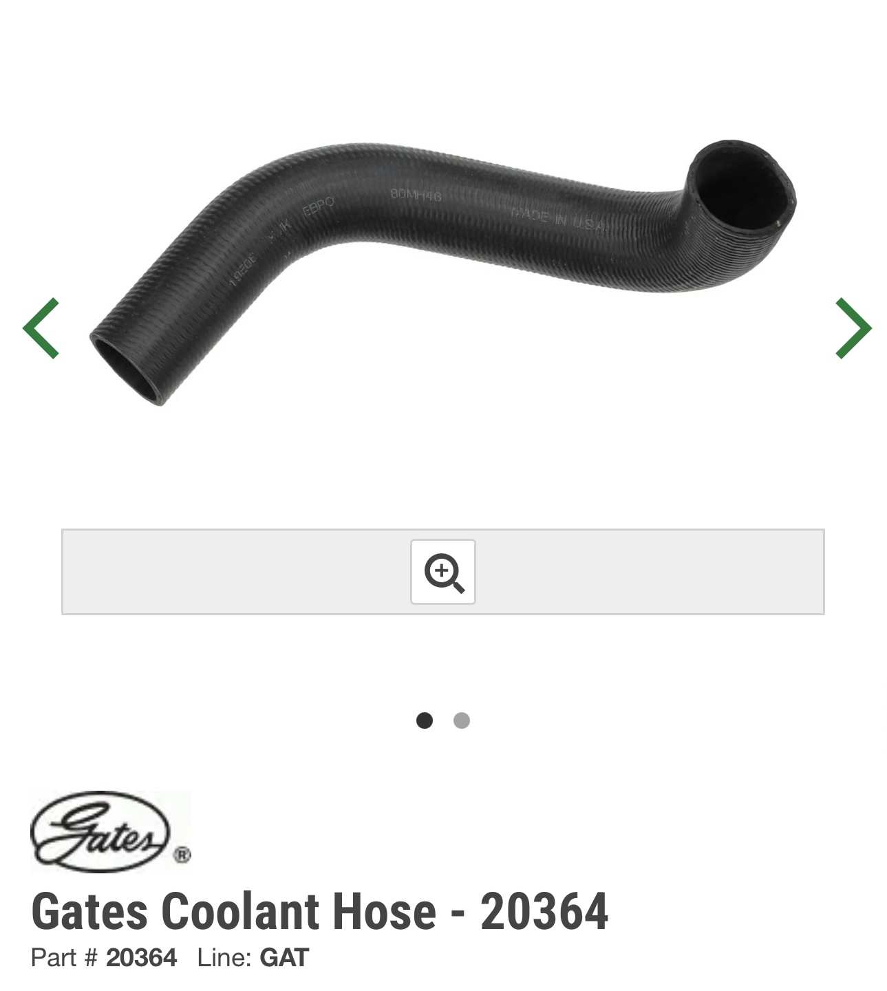

Here’s one that fits my car with a 383 and a 22 inch radiator with the outlet on the driver side.
That's it... and it won't be $70!!!
