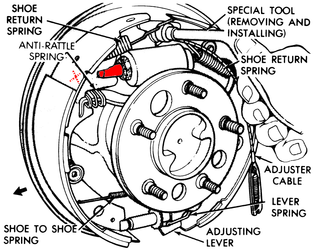

Moparleo and Chryco Psycho are spot-on with troubleshooting. Keep it simple. I had the exact same situation. My power brakes were working fine and then one day...wham, mushy pedal that went to the floor. I had no leaks and immediately suspected the master cylinder was bad. What to do? Jumping to conclusions wasted some time as I failed to troubleshoot by starting with a visual inspection of the components. I jacked up the car, put it on jack stands, and began with the removal of the rear brake drums to inspect the shoes and wheel cylinders. I found the left-rear wheel cylinder had one piston that had slipped off of the brake shoe and was wedged against the shoe's curved surface. It did not come completely out so there was no leak but all that extra travel made the pedal mushy instead of firm. As Chryco Psycho said, this is the same problem when the shoes are not adjusted properly and have to travel too far to press against the drums.
I loosened up the brake shoes, put the piston back in position, adjusted the shoes on both sides, and my pedal immediately was back to normal feel and travel. Not saying that is your problem but start with inspecting everything and have a helper carefully apply the brake pedal while you watch what is happening.
The red piston below is the one that popped out of the shoe and wedged against the back of the shoe at the red X. Strange, but true!
