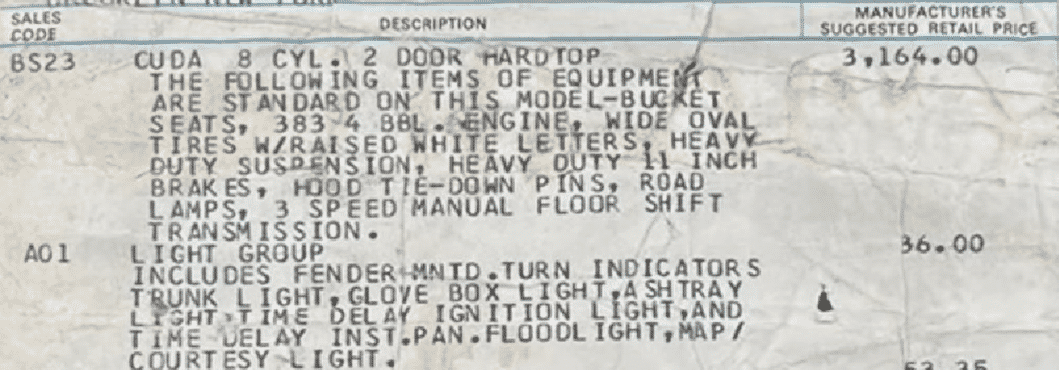

B. First glaring missing option code error. The A01 - LIGHT GROUP has one included option code that is always on the fender tag. See below window sticker details.​
That option is the L31 - FENDER MNTD.TURN INDICATORS. The repro fender tag for BS23H0B322011 is missing option code L31 on the tag.​

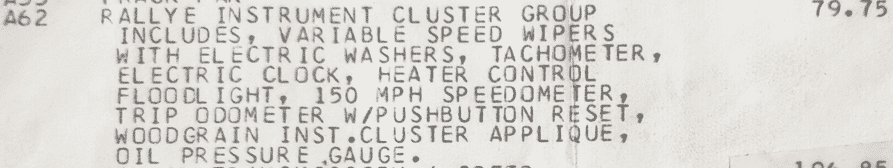

C. Second glaring missing option code error. The A62 - RALLYE INSTRUMENT CLUSTER GROUP has one included option code that is always on the fender tag. That option is the N85 - Tachometer. The repro fender tag for BS23H0B322011 is missing option code N85 on the tag.​

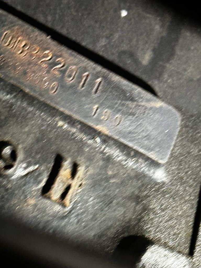

I got this picture from the seller just now. Here is the transmission stamp of the car. Looks like the tranny was assembled 3090 Jan 12 1970. So clearly not an A30 car. But that has been determined. Looks like it matches the VIN.
