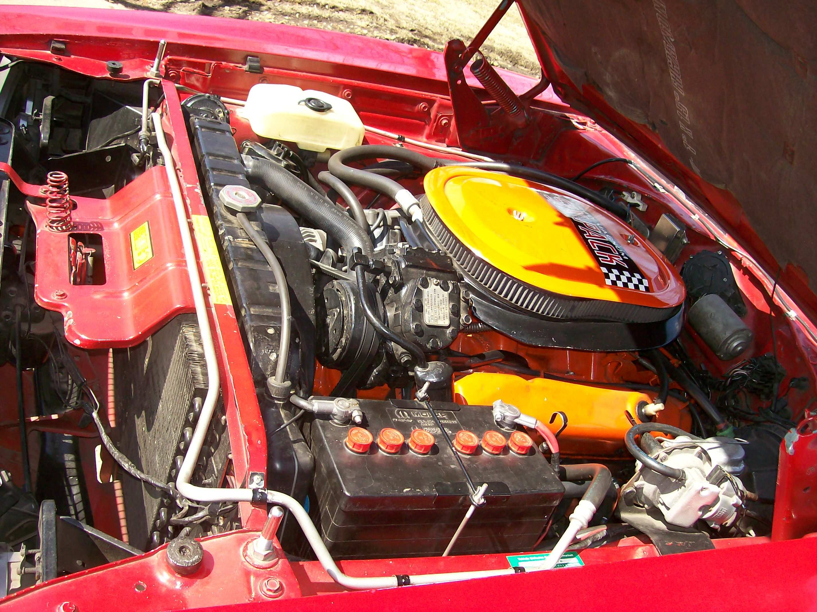

This is my 71 road runner with a 440 4bbl not a sixpack but same style base plate and it clears the compressor. All brackets were sourced through Bouchillon

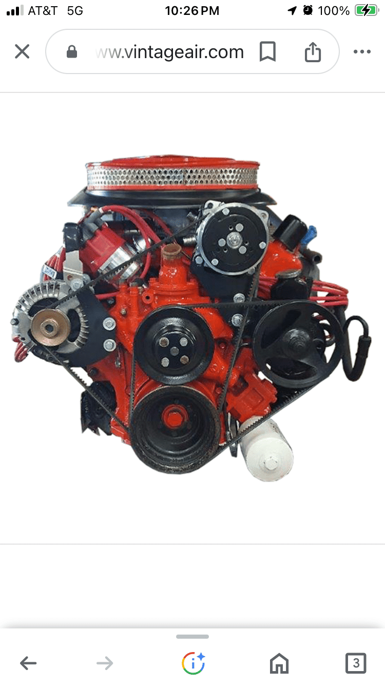

Thanks. I think thats the same compressor VA has. I guess I need to study the different brackets from VA and BP. Same compressor and they use the same pulleys?… maybe standard VA kit will work.

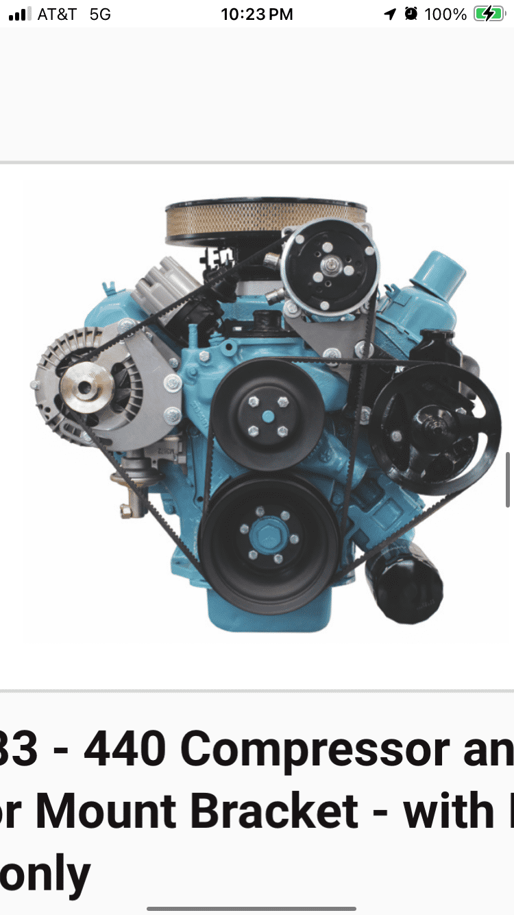

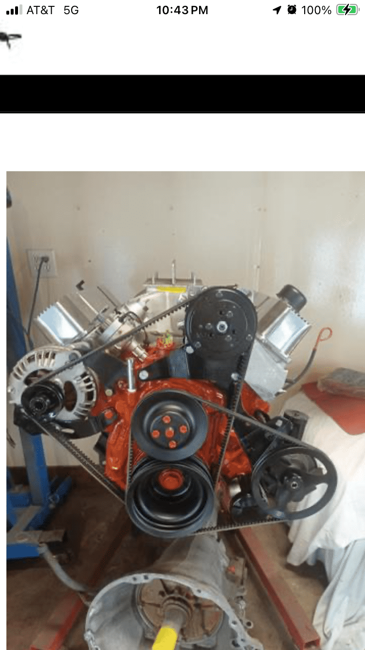

Has anyone actually compared the a/c compressor brackets; Bouchillon 4700 and Vintage Air 161002. Looking to see if one sits slightly lower. (Orange-BPE, Blue-VA)

Ooops! Above orange pic is the BPR 4710. Below is the 4700 for late cast iron water pump housing.

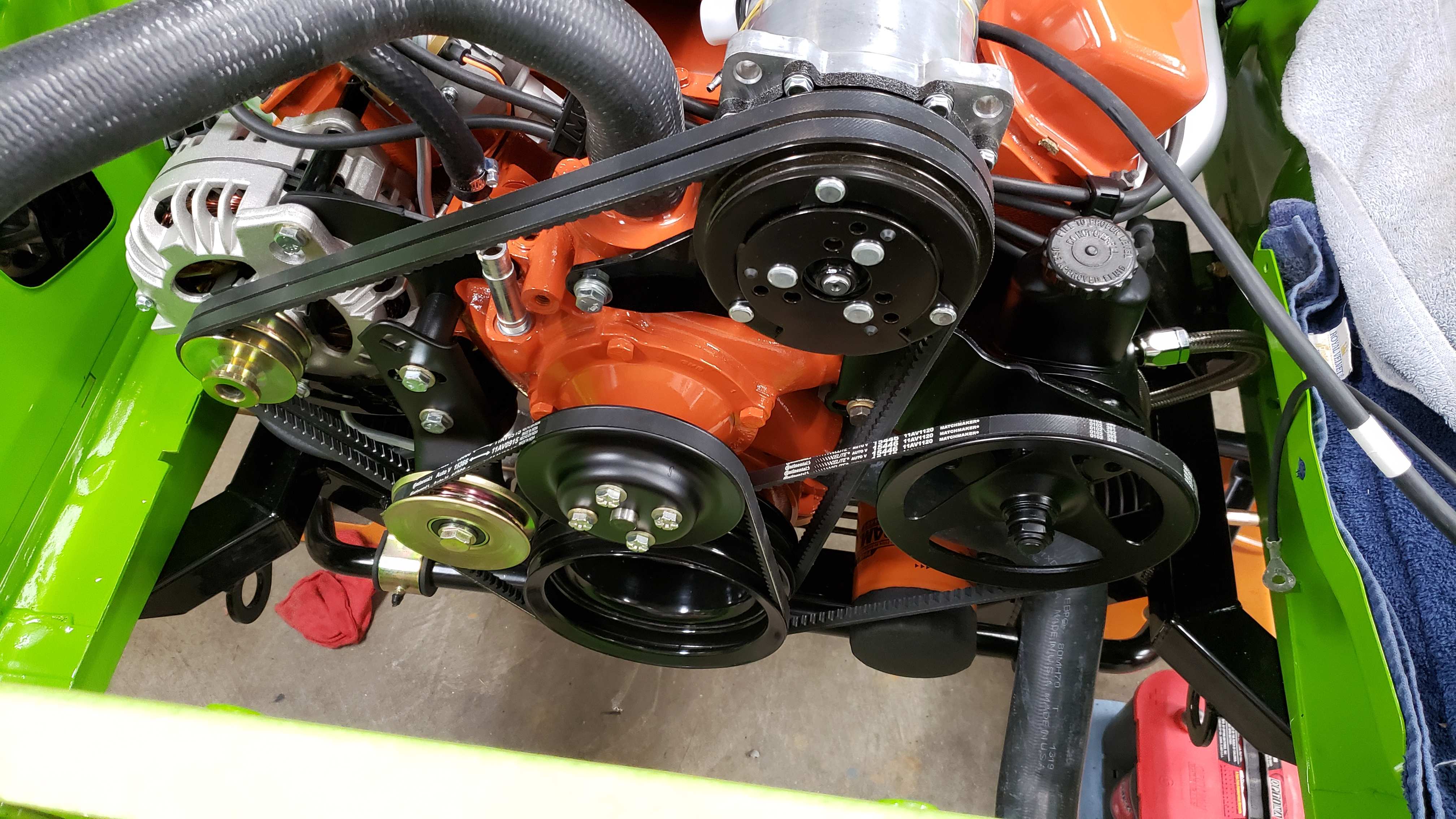

That picture shows two belts on the compressor/alternator, which is preferable. I use the VA brackets on my 440 and it was a real pain to install. First, the brackets were expensive. When they arrived, they gave me a box of spacers. Had to play with adding spacers to make the belts line up. Don't know if the Bou. brackets would be any better. I do like the two belt setup of the Bou though.

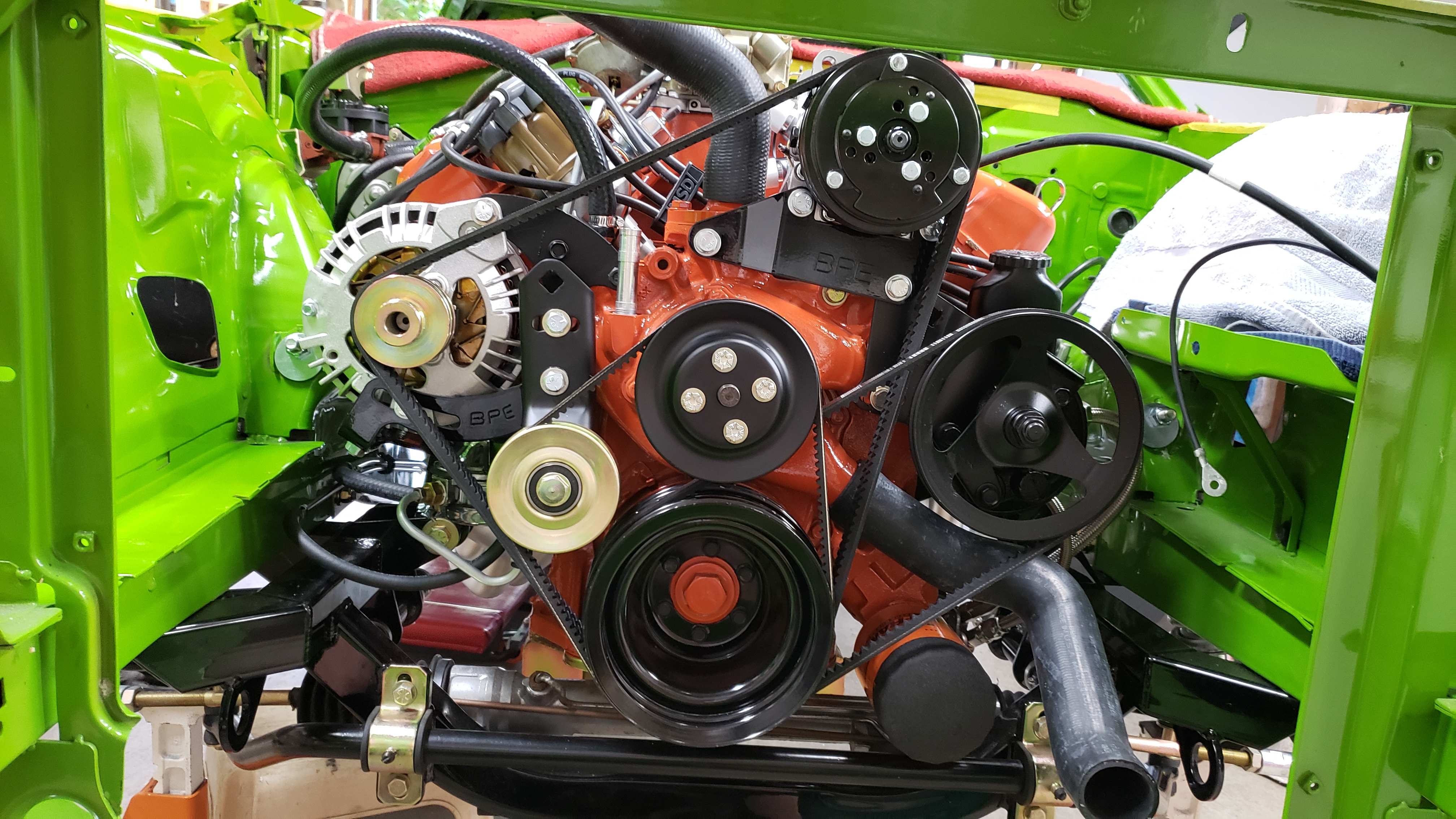

I used the BPE 4710 bracket that works with the 440 source water pump housing. The compressor cannot sit any lower on my application. I was looking at the shorty compressor and heard it doesn't perform as well as the standard one. The 2 belt alternator works well but I had a serious problem with the water pump pulley. The water pump pulley uses 1 belt to drive the water pump and the power steering pump. My pulley failed, it split in half while on the freeway loosing the steering and water pump at the same time is bad.

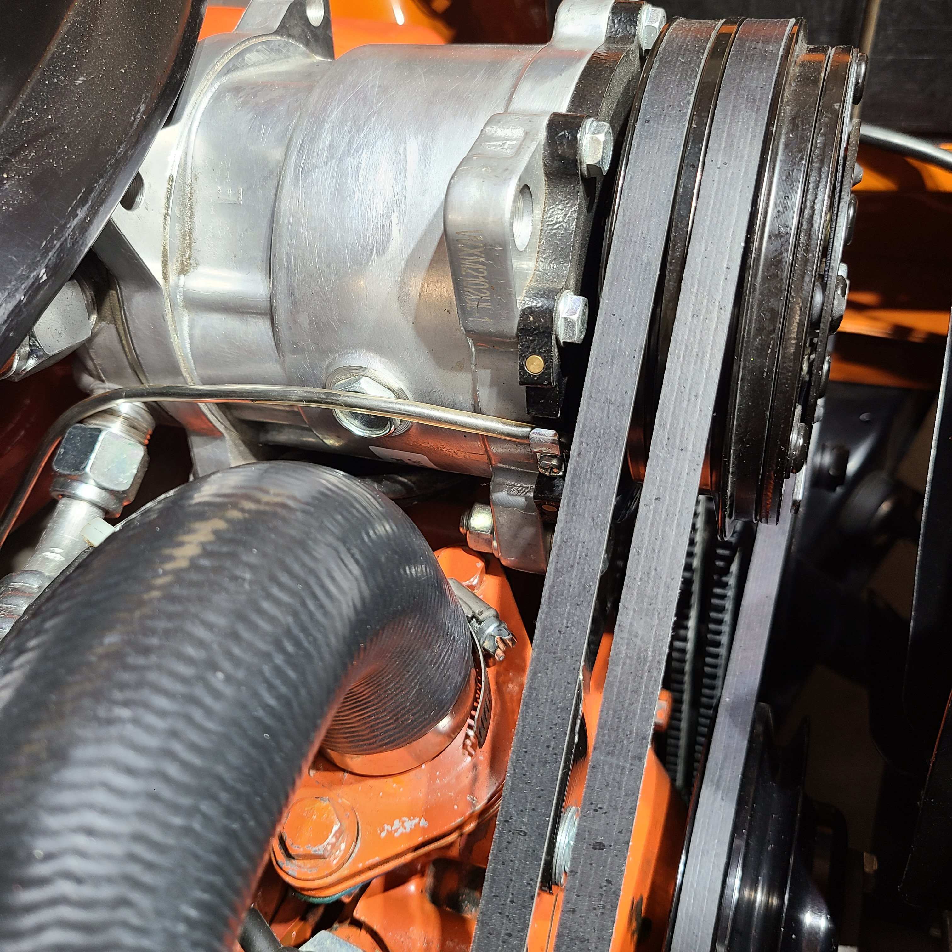

Pictures are worth a thousand words. Thank you. I noticed you have an idler for your water pump belt. I haven’t seen one of those in pictures with the modern AC set-ups before. Was that your design?
72RoadRunnerGTX
Jan 8, 2013
243
176
Shoreline. Washington
No, that’s the original factory BB A/C configuration, the idler bracket is original, idler pulley is reproduction/replacement. Water pump pulley and 4-grove crank pulley is original. BTW, the six-pack air cleaner does in fact clear the standard sized Saden compressor using the pictured BPE brackets.
