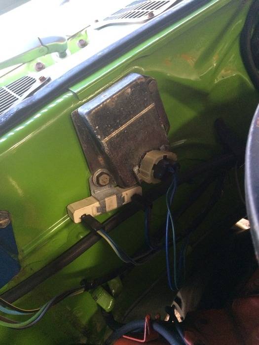

Apr 3, 2016 #1 Shut Well-Known Member Joined Jan 20, 2016 Messages 94 Reaction score 0 Location FL Hello to all I see that the Voltage regulator and ballast resistor dont work fine and I need to replace What is the right that I need to buy? No references or numbers in the parts Thanks to all Last edited: Apr 3, 2016

Apr 3, 2016 #2 moparleo Well-Known Member Joined Oct 17, 2011 Messages 7,335 Reaction score 2,128 Location So. Cal. Riverside area Moreno Valley The car looks freshly painted. Do you have a good ground ? You need good metal to metal contact. The paints should be scraped off where the regulator is bolted to the firewall. only enough to get a good ground.

Apr 3, 2016 #3 Shut Well-Known Member Joined Jan 20, 2016 Messages 94 Reaction score 0 Location FL Thank you moparleo I will do the better ground in the firewall, but the ballast resistor its broke...

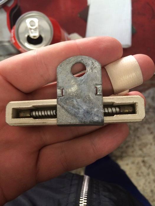

Apr 3, 2016 #4 DetMatt1 Well-Known Member Joined May 13, 2009 Messages 8,303 Reaction score 2,384 Location Metro Detroit What makes you think it's broken?
Apr 3, 2016 #5 Shut Well-Known Member Joined Jan 20, 2016 Messages 94 Reaction score 0 Location FL The ceramic of the spring is broken. And when vibration is high the terminals move and stop the engine
