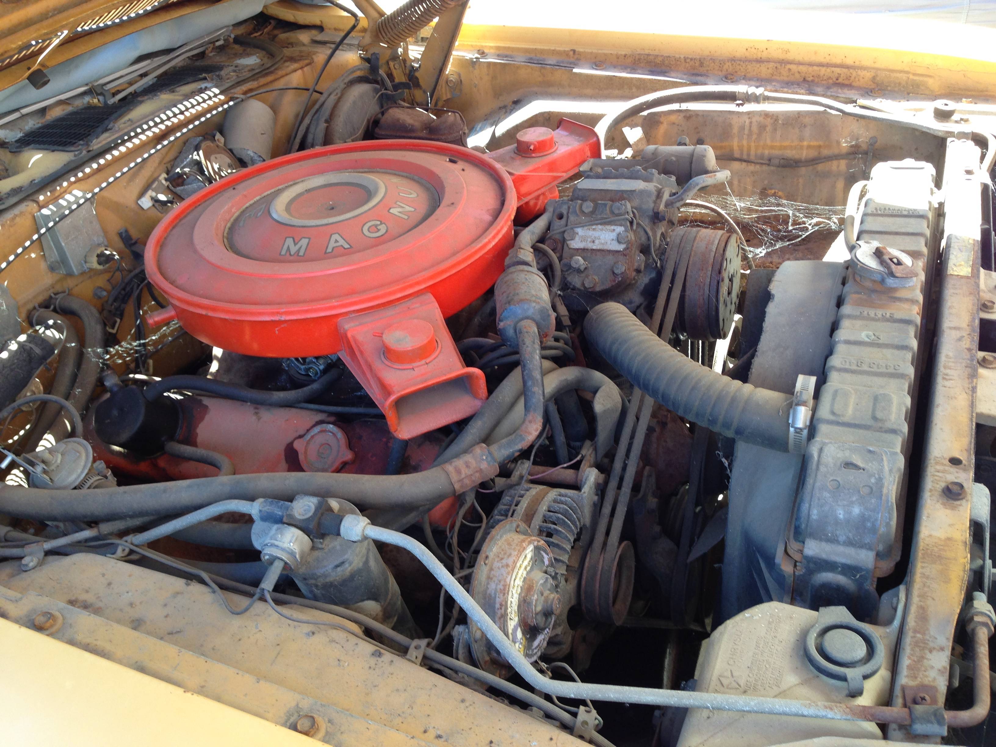

Hello everyone - I would love to pick your brains for the excellent advice on how to proceed with my Factory AC (71 RT with 383 and Rallye gauges). As I have mentioned this car was bone stock, highly optioned and I would like to leave it that way as much as possible. I live on the CA coast and don't anticipate the need to cross deserts with this car. I have had the evaporator and condenser coils cleaned and pressure checked, and would like to keep the piston compressor for stock appearance. Car sat many years so I assume the worst for most parts. Would like to convert to R134 but see other threads where that is debated. Thinking I should have the compressor rebuilt with R134 rated seals, get new high efficiency condenser, new drier and expansion valve for R134, and have the factory lines reconditioned by Vintage Air. Any thoughts/ideas/suggestions?? Thanks in advance!

The problem is with the compressor. It is the component that most affects the efficiency of the a/c system . Everey thing else you want to do just freshens up the system but doesn't make it wok any better than it was.
The Sanden compressor is the key to a modern system.

Great info - the Sanden compressor would work better (and more efficiently, no doubt) but to me when you open the hood and see it sitting right there on top of the engine it screams "resto-mod" and I really wanted to keep the stock appearance even if the compressor will be lumpy/noisy and not as efficient. Does anyone have experience installing a hybrid system (rebuilt piston compressor, new dryer, expansion valve and upgraded condenser running R134)?

If your not using a mechanical fuel pump, you can locate the sanden compressor in that location and keep the original on top for show

Never thought of that possibility - would be a good idea but I am keeping the mechanical fuel pump

I tried doing that with 134a brazed new barbs on the lines had them plated got barrier hose crimped on new drier and condenser put a front seal in the original compresser .the seal leaks very slowly need to recharge every year works not that good. my mistake was to put in the original style condenser you need to go with the newer style one much more efficient .anyone know of a competent rebuilder for the compresser i bought one on ebay once total junk

Original Air will rebuild your compressor and use R134 compatible seals and gaskets, but you have to get on a wait list because they are backed up with orders. Plus you are going to have to pay to mail that heavy compressor back and forth. My guess is that a local auto AC shop could do that job for you, but I have not checked to confirm.

Original Air also makes an upgrade kit that is reasonably priced, has the combination hard and rubber refrigerant lines (although I have not confirmed they would look similar to originals when installed) and you can also get the Sanden compressor painted black for an upcharge.
71 Charger/70-71 Barracuda A/C Performance Upgrade Kit Big Block STAGE-2
It comes with the higher efficiency condenser, and the other bits and pieces to switch to R134 and still operate well (hopefully). Anyone used this kit? I am a little more inclined to switch to the Sanden because at least painted black it would not be so obvious it was not the original. Can keep the original compressor in case any future owner really wanted to switch back to a completely original system.
