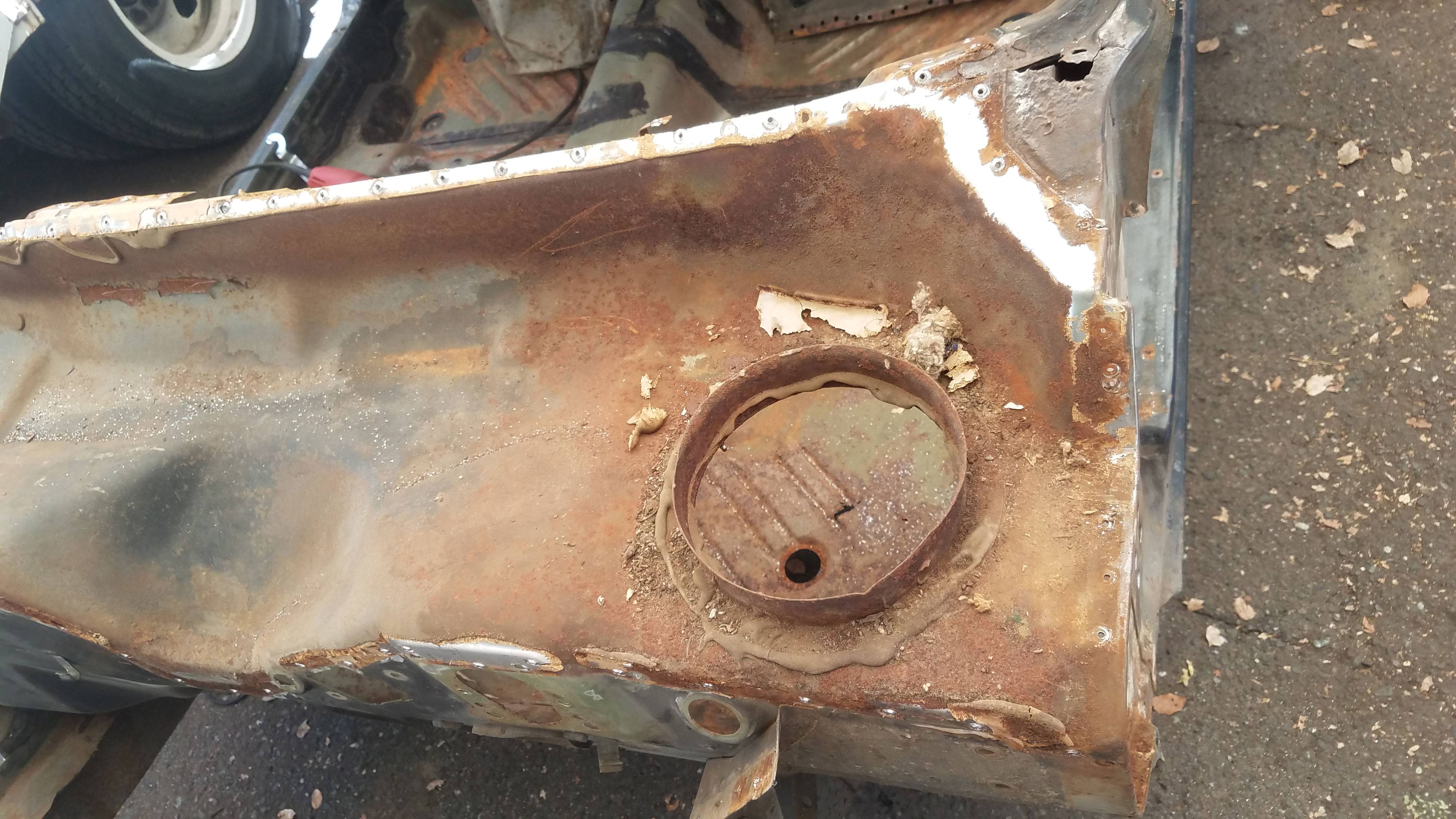

Front or rear floors? Is there any rust around or under the windshield and rear window trim? Have you checked for rust holes underneath the rearward tops of the fenders next to the corners of the windshield? (This common rust spot is right below the base of the A pillars. See photo with rust hole below A pillar) Rain may also be entering through rust spots underneath the cowl. Where is the floor wet exactly?

Take the vent screens off top of cowel, look in at vent openings , check for rust holes. Had that trouble with my cuda. I had to remove and replace top to repair. On mine most of flange was rusted off.

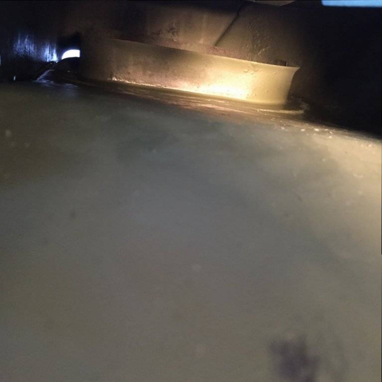

Here is a pic of the top of the vent /flange opening under the top cowl. Pic was taken when I was cleaning up my cowl interior and rust proofing the area.
This is where the rust usually occurs (the lip rusts out), thus allowing water in.
Hope this helps give you an idea where your problem may be!
