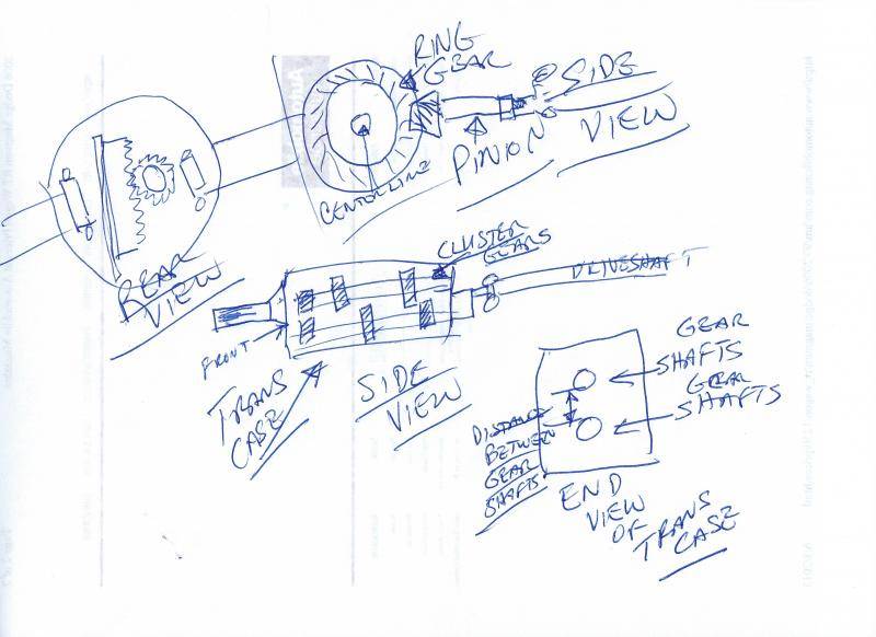

Not if it has been making noise for 1,000 miles. No backlash on trans gears, you can't change the distance between clusters. The gears are parallel to each other unlike a pinion gear that can be adjusted for depth and is at a right angle to the ring gear.
r&p.jpg I have no drawing skills, so use your imagination on this.
