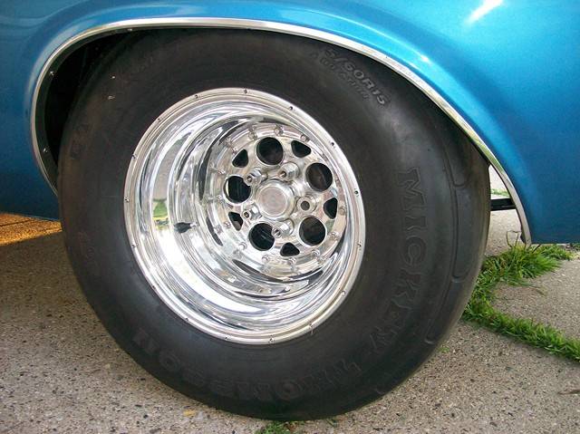

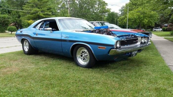

I always flip back & for the between the factory Rallyes & Cragars on my cars. Keystones are growing on me over the years. I found these Weld Magnum 2.0's for a steal of a deal for my Challenger so I now run these.
Your car looks awesome with the Weld Magnums. I also like the Keystone wheels. Im kind of leaning toward the American Racing spoke wheels, but also the the Cragars. I see you don't have the raised white letters (RWL) facing out. I've talked to a bunch of guys and some like the RWLs and some like the black walls. I sort of lean to the RWL because they give the car that classic look. Any suggestions there? Thanks
Hey 6pk what size are those rear tires? Is that rear a stock set up? I am thinking about new wheels and I was told that I could fit 225 70R15 up front and 275 60R15 out back with no fitment or rubbing issues. Your setup looks right. Fills up the wheel wells perfectly.
275/60/15 will fit in the rear of yours no problem on a 10" rim with I believe a 5-1/2" back space, this is what I have on my 70 Charger with the Cragars.
I run either 315/60/15 Drag Radials or 29.5" X 10.5"W slicks on the rear on a 12" wide rim. The axle is narrowed & leaf springs moved in board with Caltracs & a mini tub.
